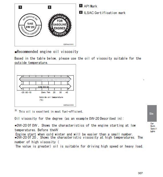

6) Replace oil filter and add new oil ( 5W30). Fully synthetic SN Grade. I prefer Total.
