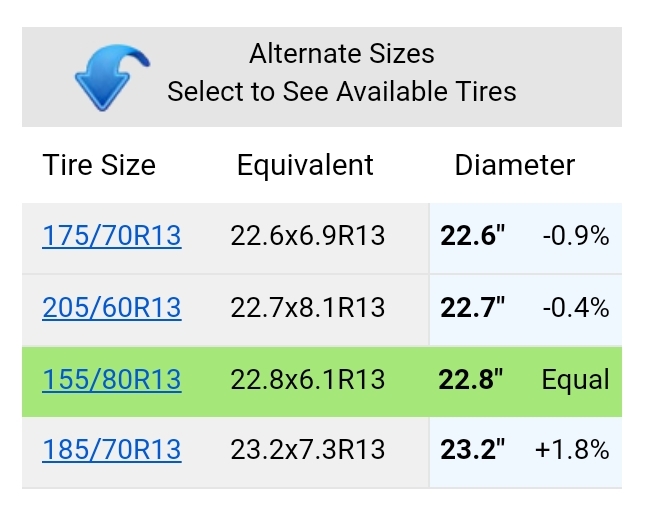

AoA ! Pakwheelers please suggest best tyres for toyota passo ( comapny name and other spec with price)Driving in islamabad and other southern punjab area's
Assuming you're not changing wheel size, you can safely use anyone of the following size.You can use 185/70/13 for maximum width and height.
If i use 175/70/ 13 will it affect the average of car?
And which brand i should use yoko, Bridge etc ?
155 is stock width, anything wider than this will consume more fuel. The wider the tire the more fuel it consumes. But that extra fuel consumption might be negligible. Someone switched from 155 to 175 or 185 can tell you.Any good reputed brand will do it..
