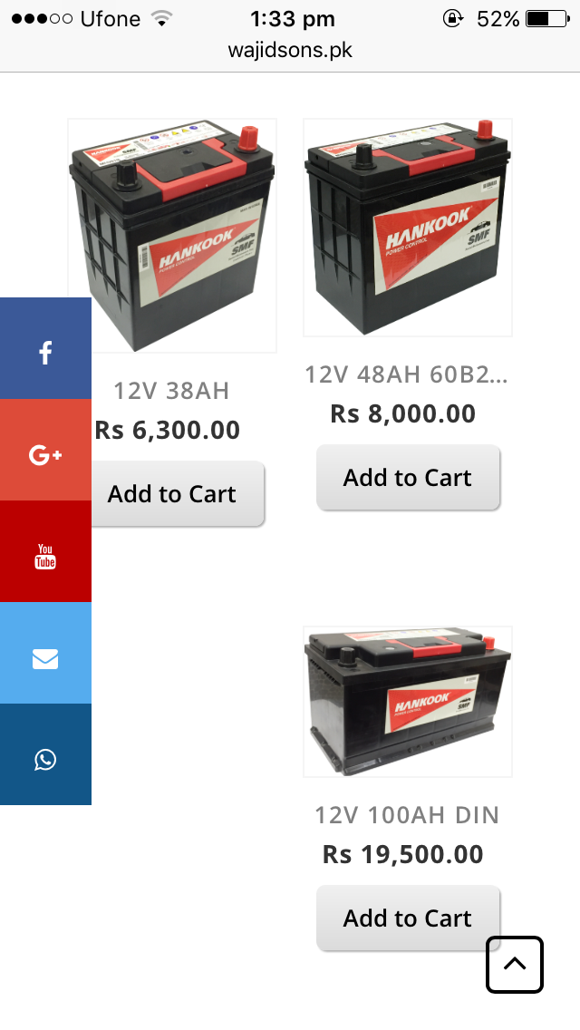

Well, the following is you battery type:
M-42
You should install a battery with 38 AH rating or close to this.
You car details are is under:
GRADE: X: X TYPE DESTINATION: JPN: JAPAN ENGINE: 1KRFE: 1000CC 12-VALVE DOHC EFI COLOR CODE: P12 TRIM CODE: FD40
Year of Manufacture is 10/2013
For me, I like AGS batteries which are not maintenance free batteries and you have to maintain the acid level. The life is more than a maintenance free battery.
You can check any good brand offering close to or 38 AH battery for your car. Ensure that the terminal size (diameter) is as per your cable clamps. Cable clamps should be of lead and not brass or some other material.
Also ensure that the battery size is as per requirements of your battery casing/clamping arrangement. That is width, length and height.
