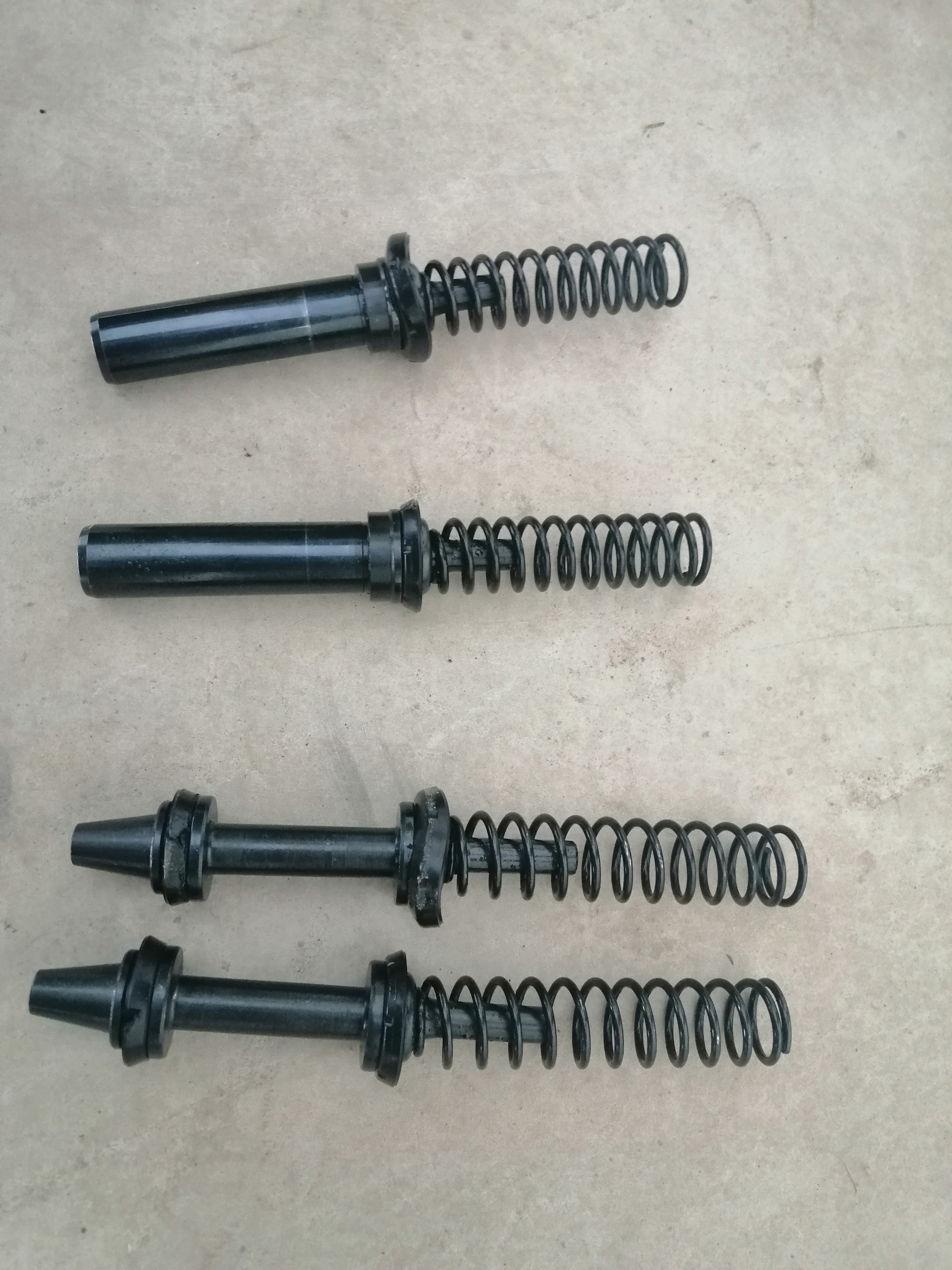

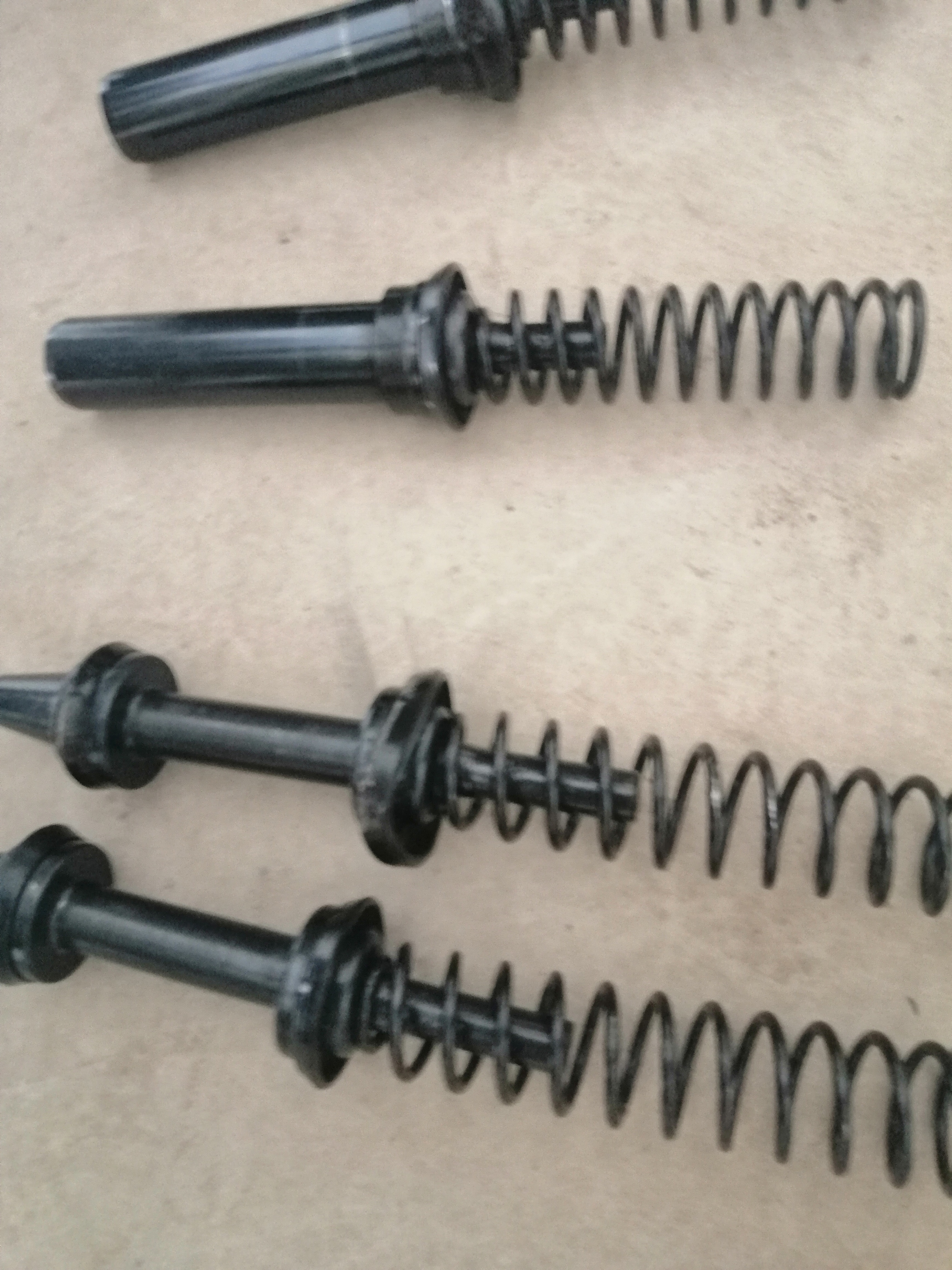

It started when the brake cylinder of the rear tyre got leaked and I took it to a mechanic to replace it. Front discs were also replaced as they were due. After this work once I left with the vehicle front wheels were jammed just after a few kms, the mechanic was callled, he checked and found that master cylinder is damaged (seals of piston were swollen / damaged). He replaced the master cylinder, the vehicle drove okay but next morning same issue was faced and wheels were jammed

Pics of swollen/ damaged seal are also attacehd
