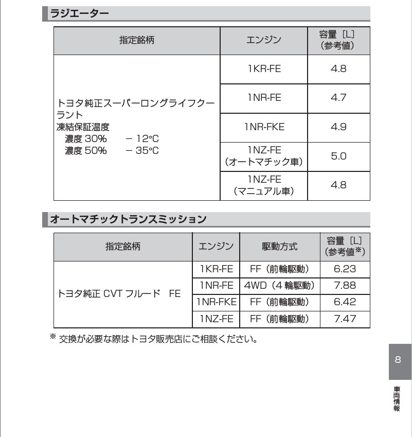

Toyota Defense Motors after complete checkup told me that I only have to change fan belt and wheel bearings. I asked them to change CVT Transmission oil then the mechanic told me that you need not to change automatic transmission oil unless it leaks. Toyota have not provided any Gauge for measuring CVT oil because it is not changed even after 80,000 mileage. Change when it leaks or after 150,000 mile check it by Toyota Workshop only. They also told me that when they will change CVT oil on my request the engine light may start blinking as error. So, they also hesitated to change oil.
When I asked Toyota Motors price of Vitz 2014 fan belt they told me it will cost me Rs.95,00/- and one wheel bearing price is Rs.5,500/- Now I decided to go to Plaza for fan belt and wheel bearings and when I will find these items then I will fix them by any good mechanic of latest Automatic Cars. I am also in search of Toyota Vitz 2014 pdf manual but could not find.
