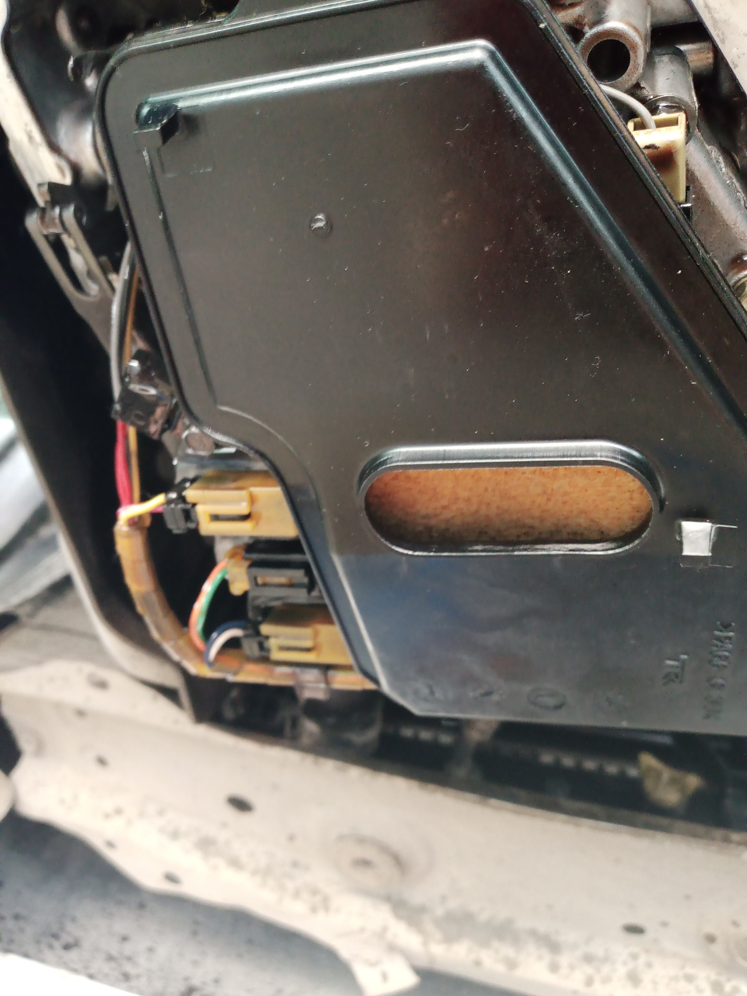

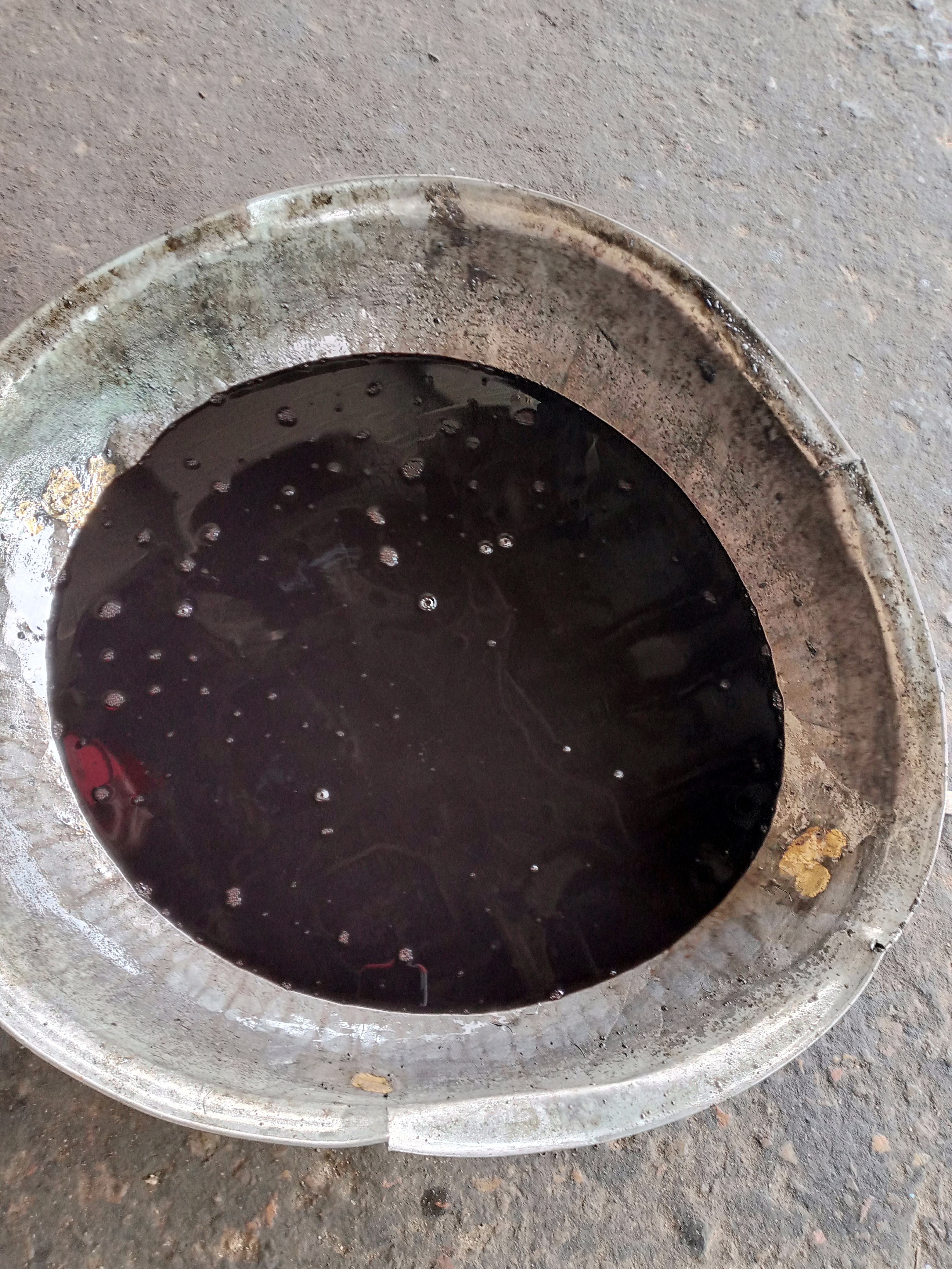

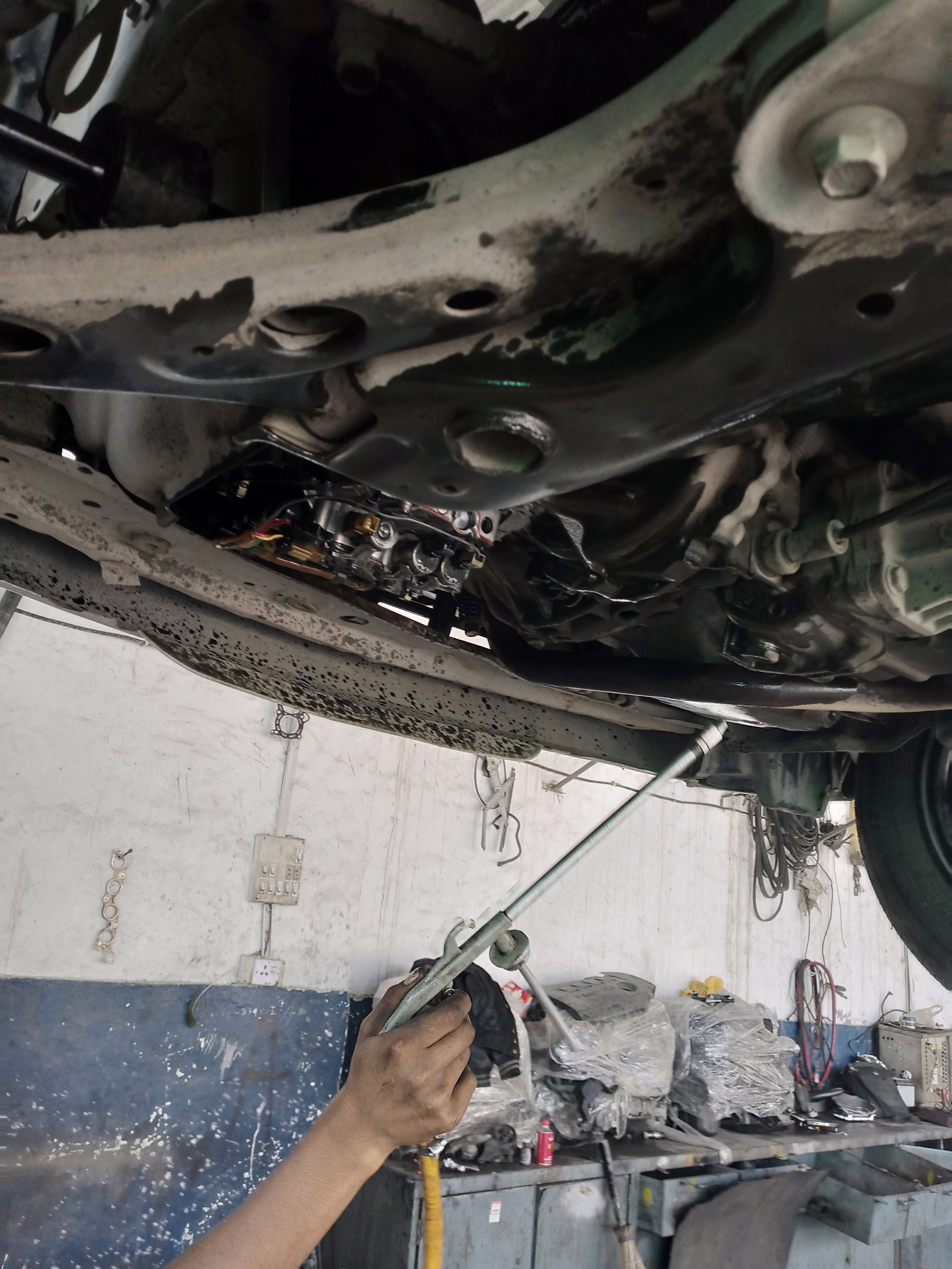

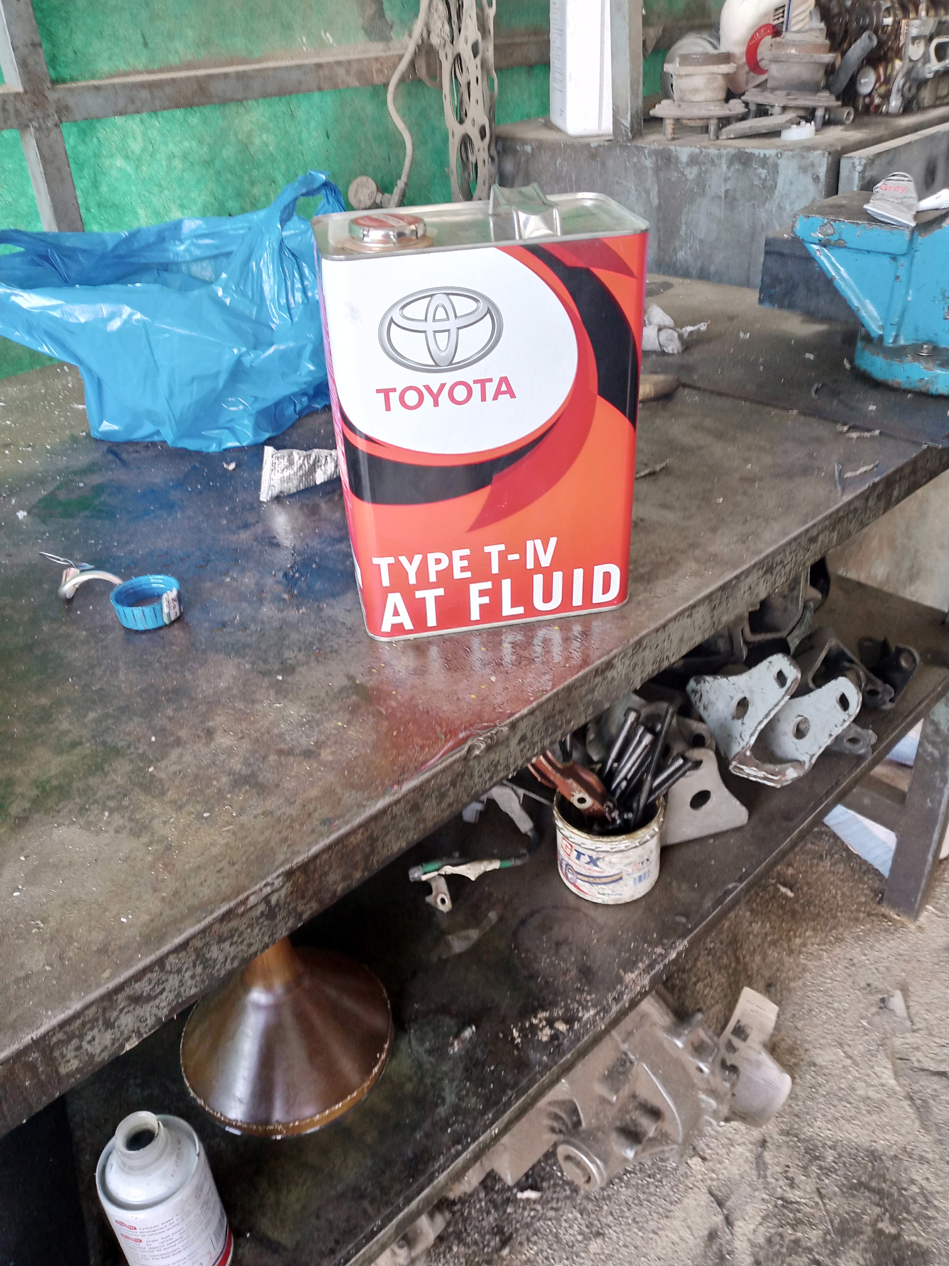

After so much soocho bechar finally changed the transmission oil of my Passo 2007 model 1st generation Kgc 15... removed the sump cleaned the filter too... CONFUSION was which is the correct transmission oil... confused between Aft t-IV AND ATF WS...but finally after research got it changed with ATF-TIV...
3 LITRES OIL IT ACCOMMODATED
