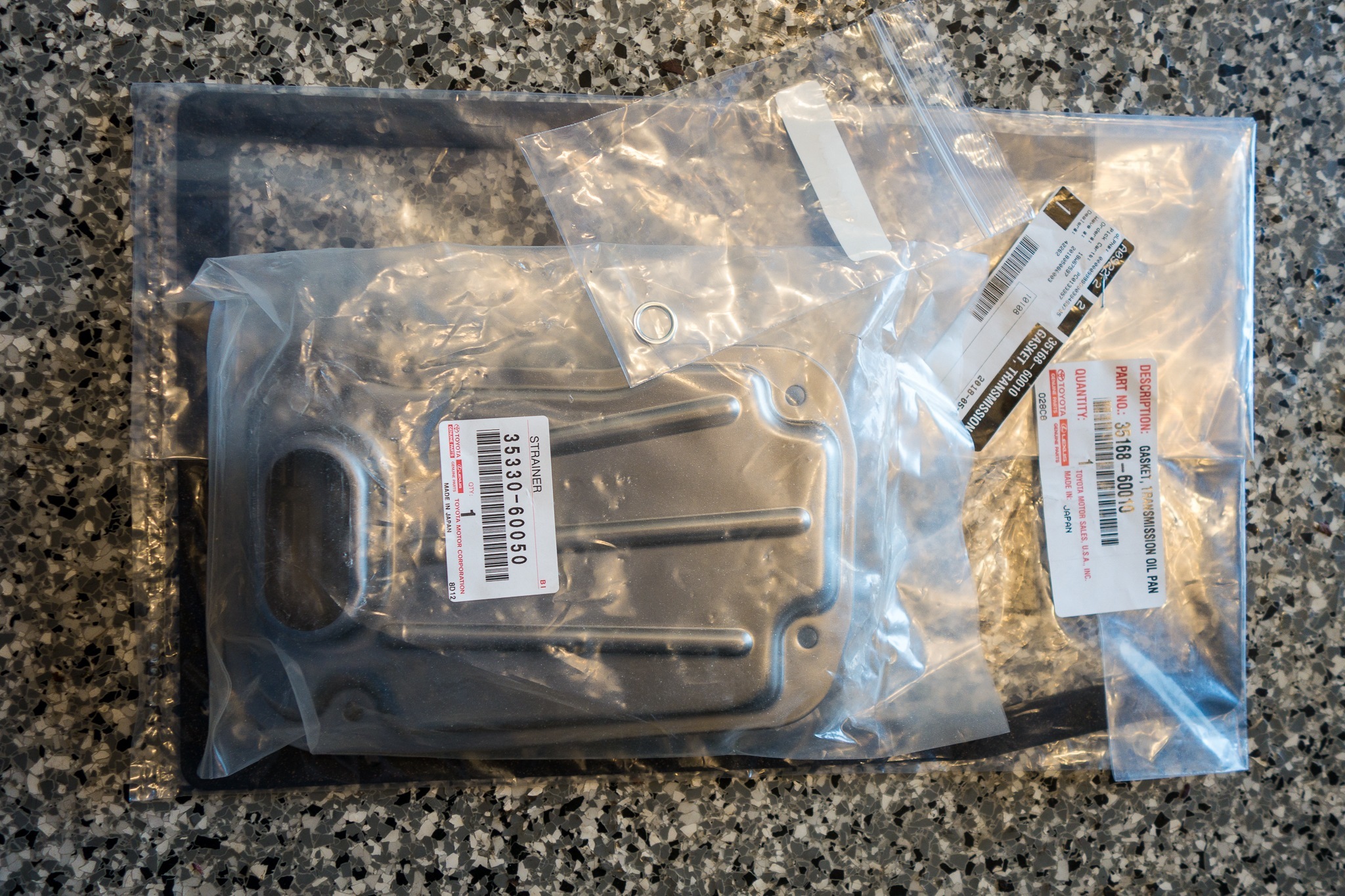

I opted to drop the pan because I wanted to replace the filter and see the condition of the magnets.
