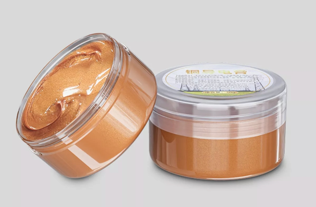

I'm considering putting some copper anti-sieze / dielectric grease on the contact strips that've been sanded to expose fresh, un-oxidized metal. I found a little inexpensive tub of "copper conductive grease."
I could also use it on the battery terminals, chassis grounds, etc. Perhaps to mount the ignition coil, improve heat exchange between its metal base plate and the rest of the chassis.
