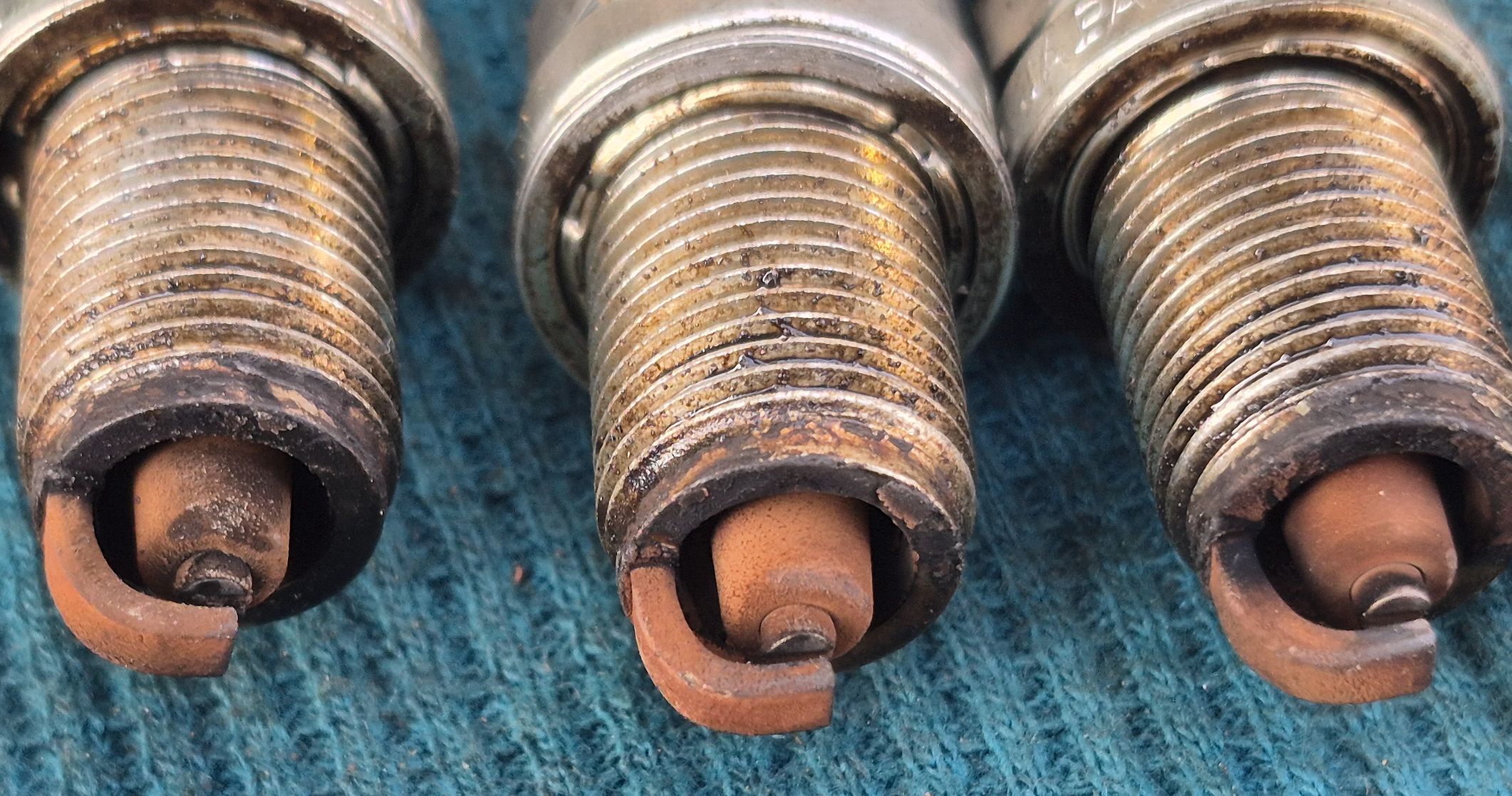

2,900 km ago, I replaced the fouled Denso IW24 with NGK BKR6EYA-11 that were cheaply available nearby. The car ran fine and never really did anything egregious, but I started noticing hesitation under boost.
Eventually, anywhere near 7 psi / 50 kPa of boost, I would get serious hesitation that indicated spark blowout below 3000 rpm. Above 3000 rpm, things seemed okay, but underpowered. The hesitation persisted.

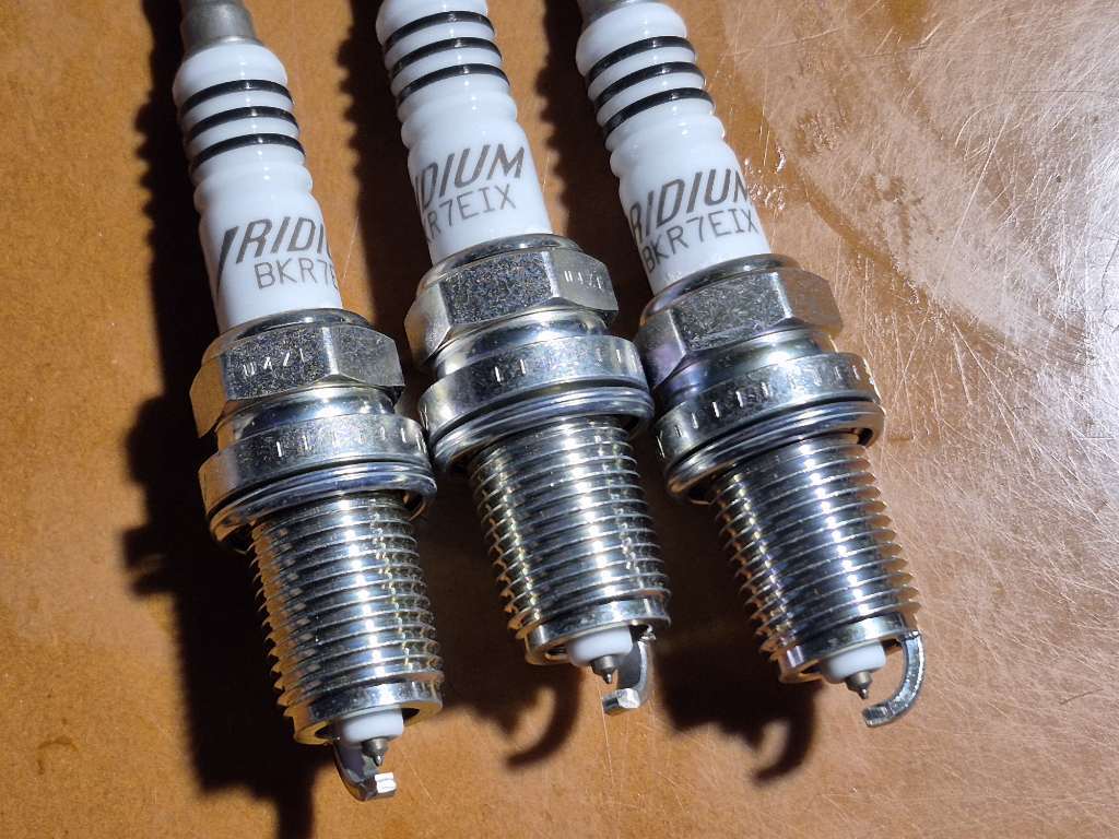

Finally, imported Niterra BKR7EIX plugs at a significant extortion premium. Manufacturer claims 50k mi/80k km life. Greased the terminals with the mystery Chinese dielectric grease before installation.
Night and day difference, no misfire under boost, no hesitation.

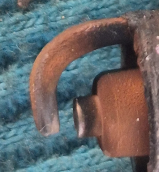

The BKR6EYA-11 plugs showed significant erosion at the copper electrode, widening the gap even further beyond the already large gap.
The plugs themselves seem fine, and fueling seems fine also, probably thanks to the late gen ECU.
