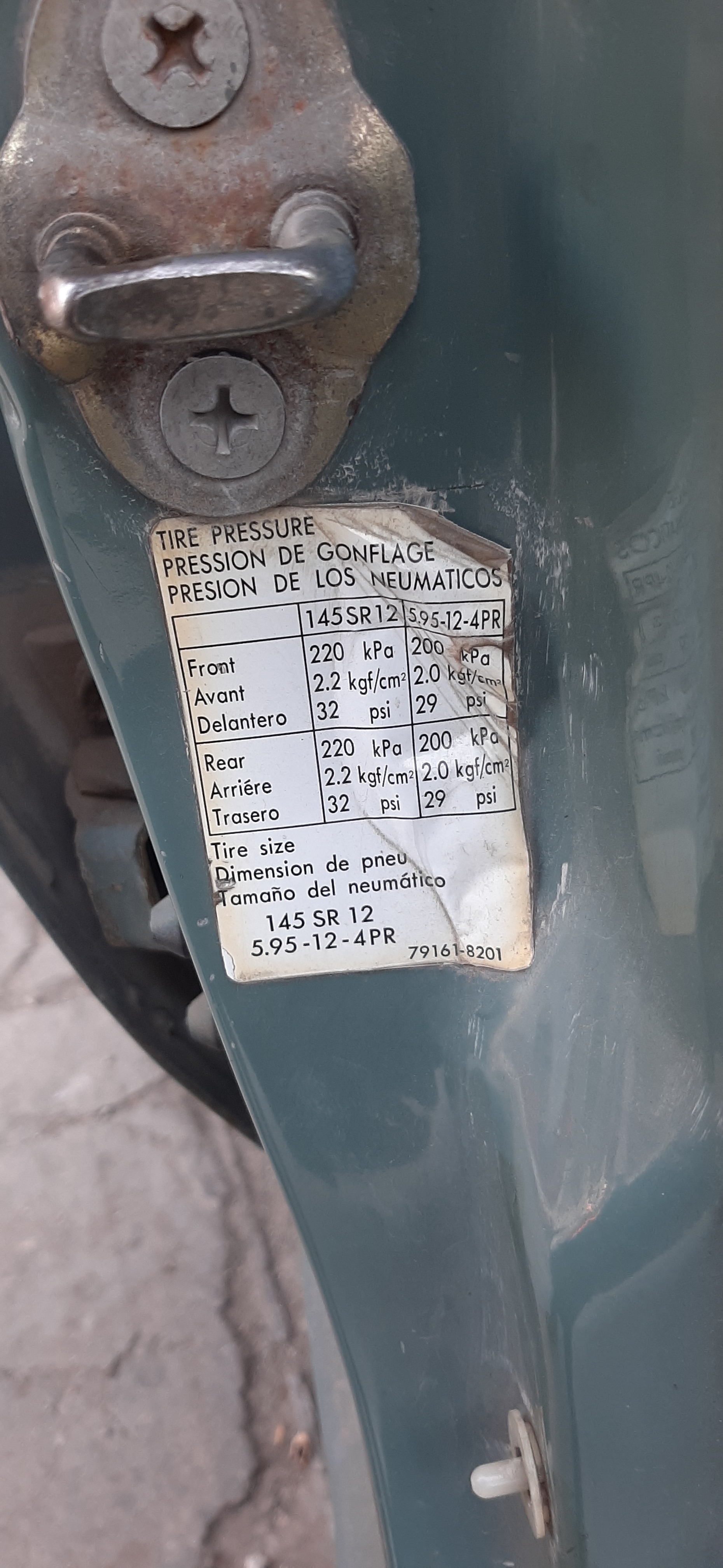

One thing i didnt get is the air pressure.Should the left side tyre get 29 psi and right side tyres 32???Please click the image to see the info
Its two different tire sizes, one on the right is bigger in size.
Size of tire on the left145mm is widthS speed ratingR radial12 is diameter
Size of tire on the right5.95inch is width12 is diameter4pr is Ply Rating
Some one saying its euro size figures and in oakistan we use something else...
True.
