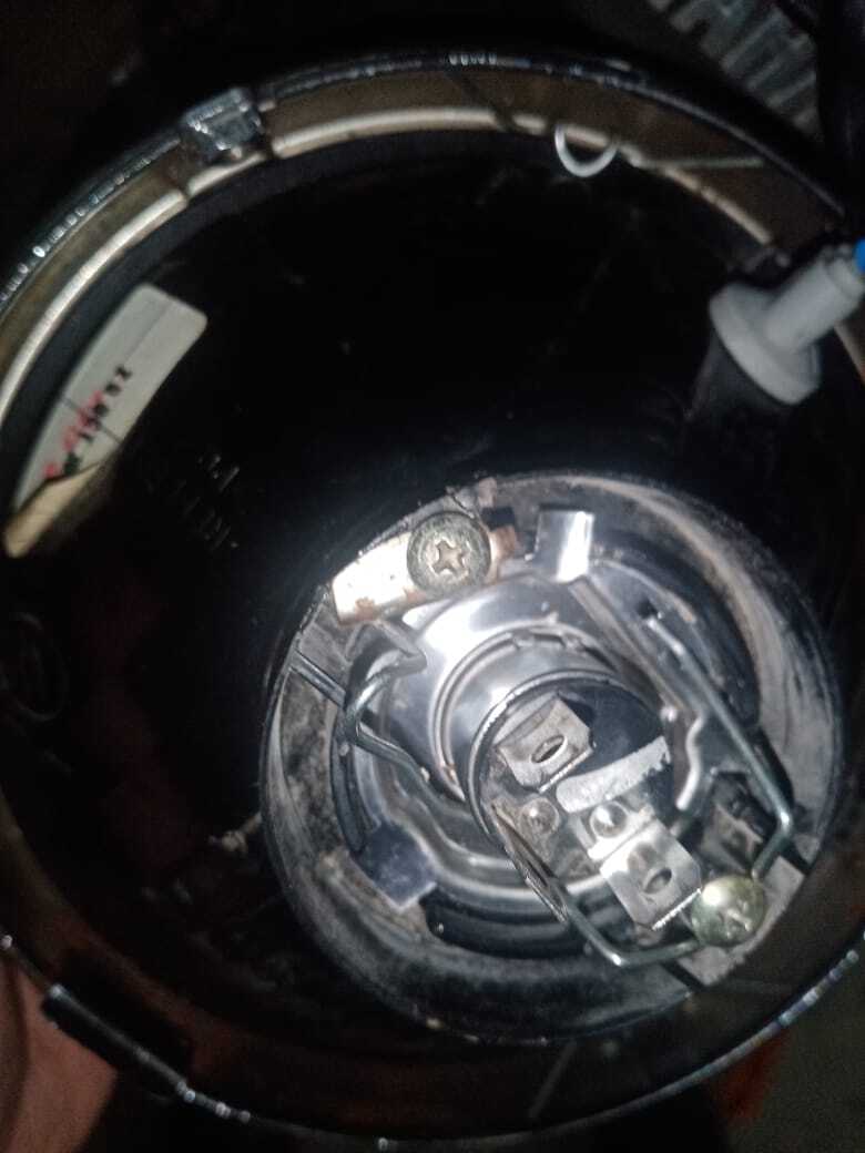

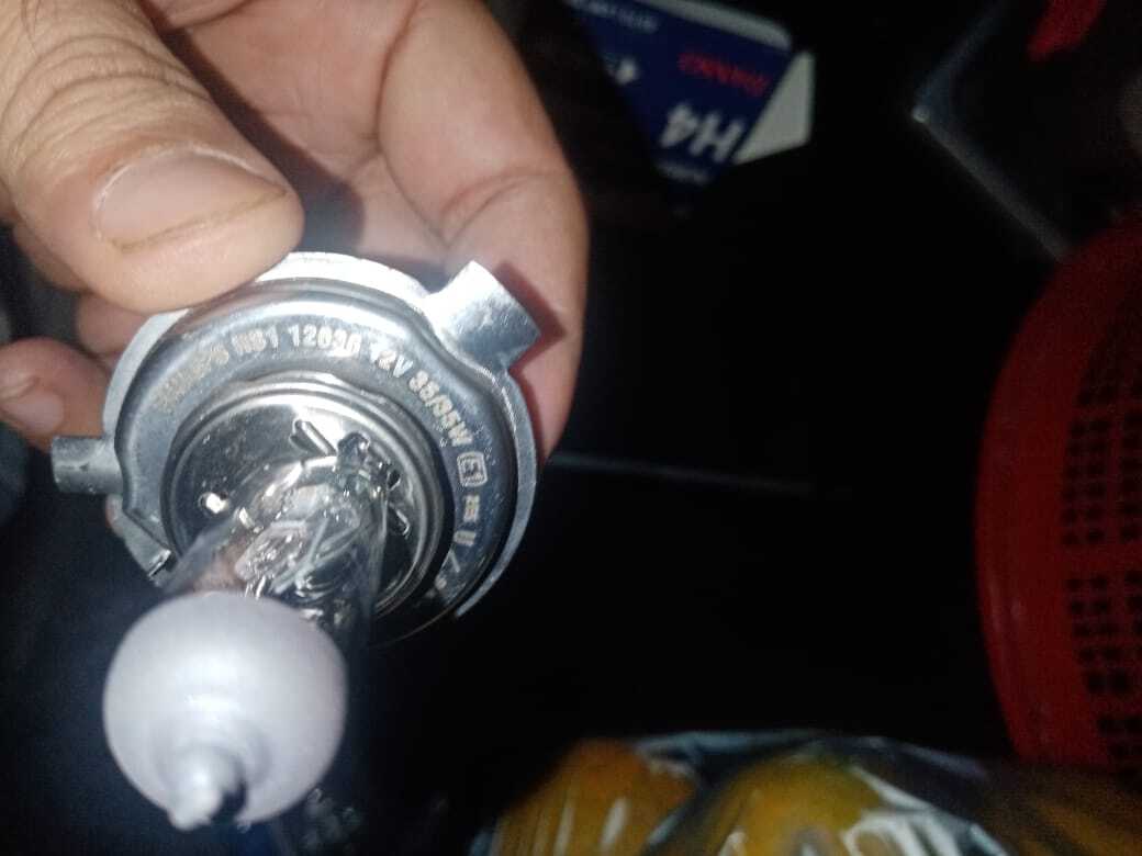

Ybr 125 variant G comes with a round 7" headlight with Plastic Reflector and Plastic front cover. By default it has 35/35 watts 12v Philips halogen bulb h4 socket.
I wanted to upgrade the headlight for better visibility on highways, so i swapped a C6 Led 35w. It was longer from the back side because of heat sink and fan so i had to make a hole in headlight back cowl to make it fit.

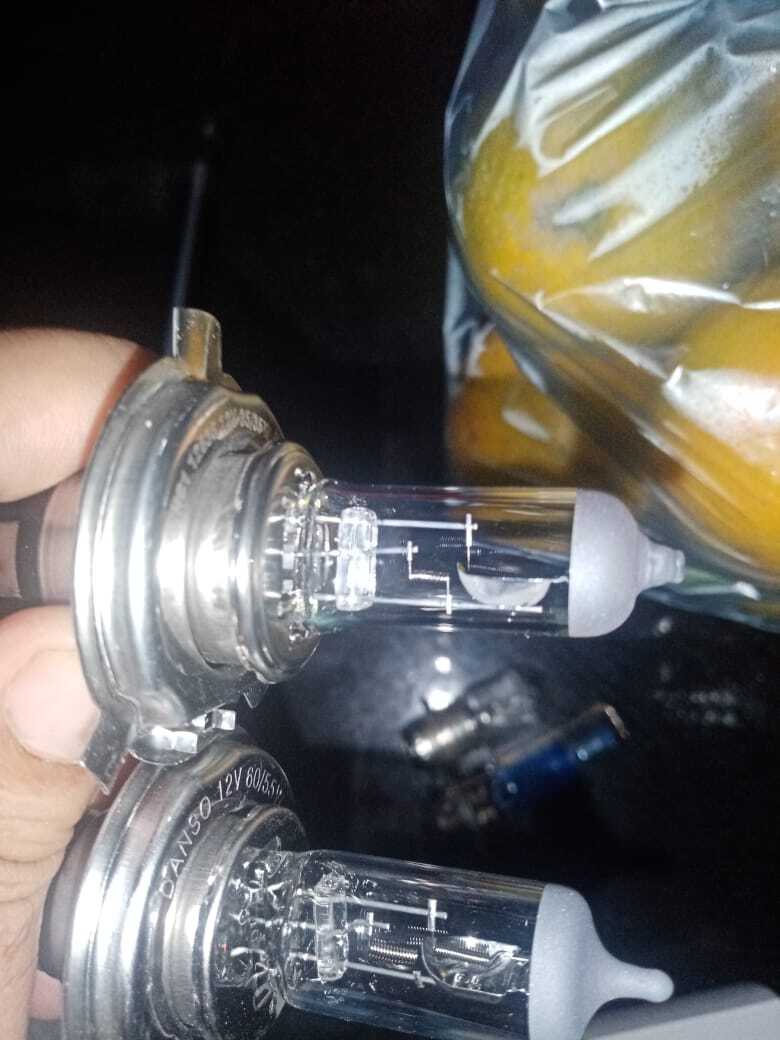

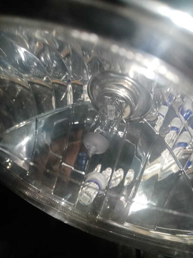

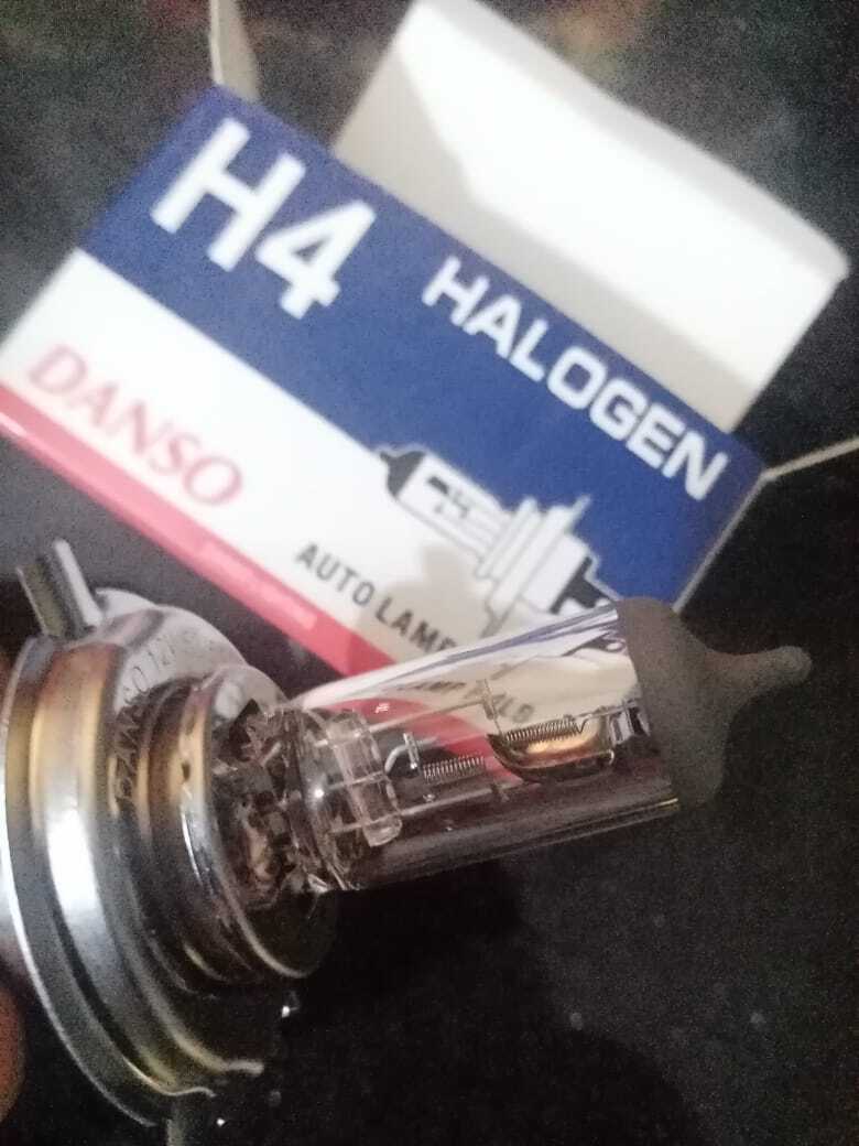

Now i have swapped it with a 55/60 watts halogen bulb same H4. So the load is now 20 to 25 watts more than the stock and i can feel that it is producing more heat which might cause the reflector to melt/ wires and sockets to melt/ buttons melt/ or blow up the fuse.
By stock the bike came with a liquid acid battery that i replaced after 2 years with a sealed lead acid battery, i think its 4 amps.
I will post the results with this bulb. Attaching some pics of stock and upgraded bulb.
