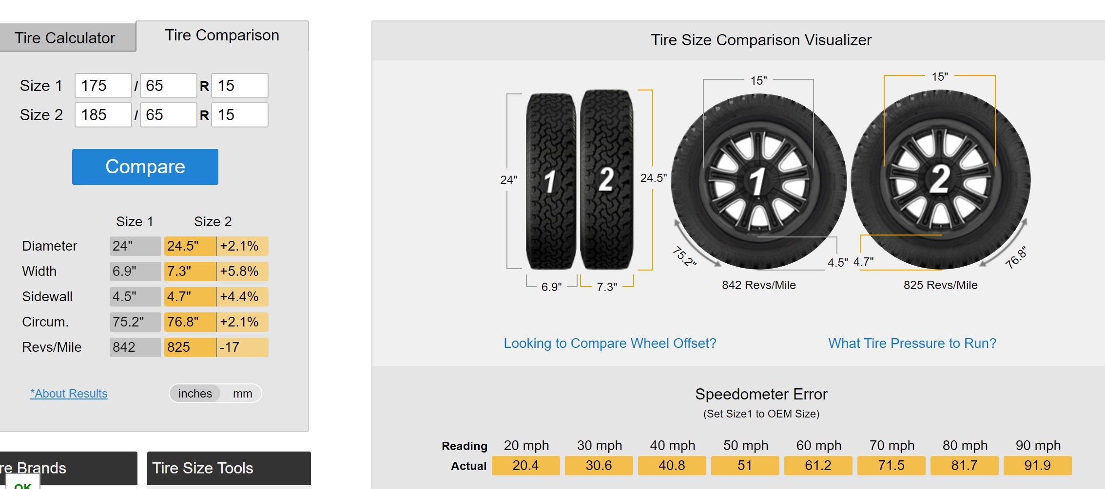

I found this site best for comparison of tire sizes: https://tiresize.com/calculator/
Note to self: 185/65 R15 still makes the most sense to upgrade to as seen below. Minor outer diameter difference. ~6% wider for a bit better road grip.

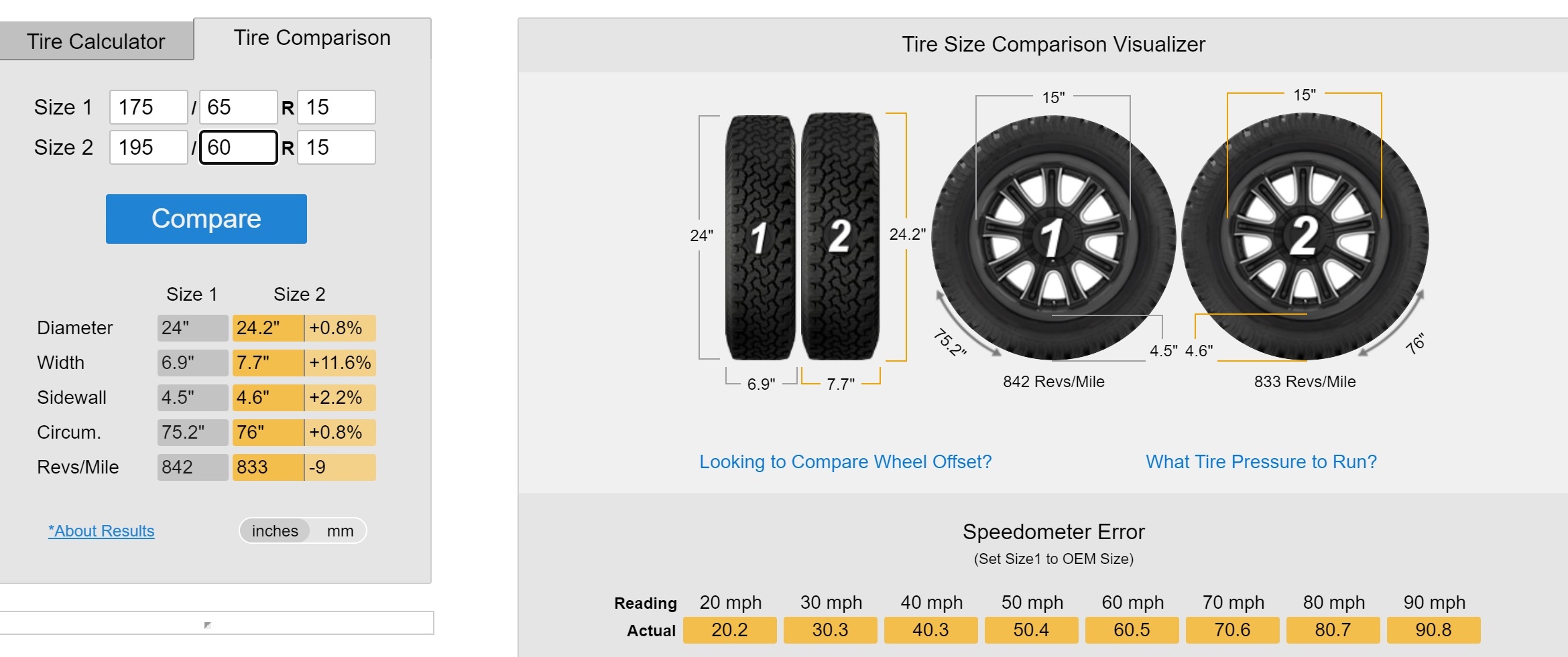

For a bit better grip / look, the 195/60 R15 is even closer match (outer diameter wise) as its just 0.2% taller. But its about 11% wider for better grip.
