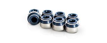

My car was having a misfire issue when it was cold started in mornings, but it would be fine after a hard rev, it would smoke for a few seconds and then the engine would smooth out.

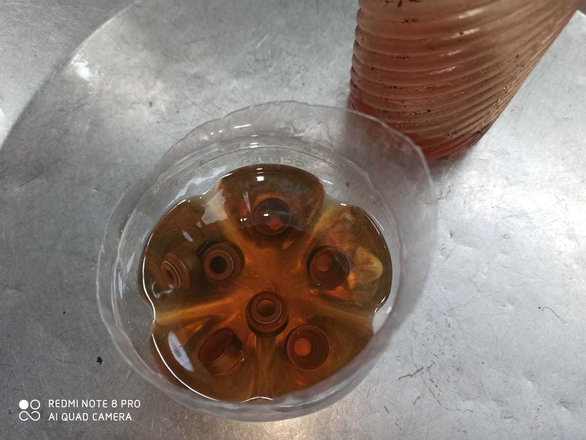

The plugs were getting shorted due to oil leakage. So it was time to replace the valve seals.
The engine is a G13BA in my 97 margalla, which has 320,000 km on the Odometer
