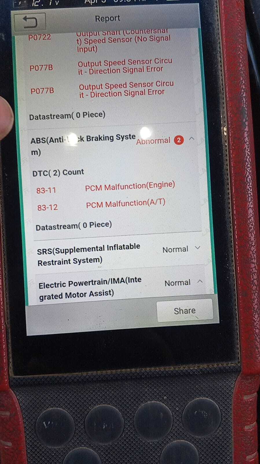

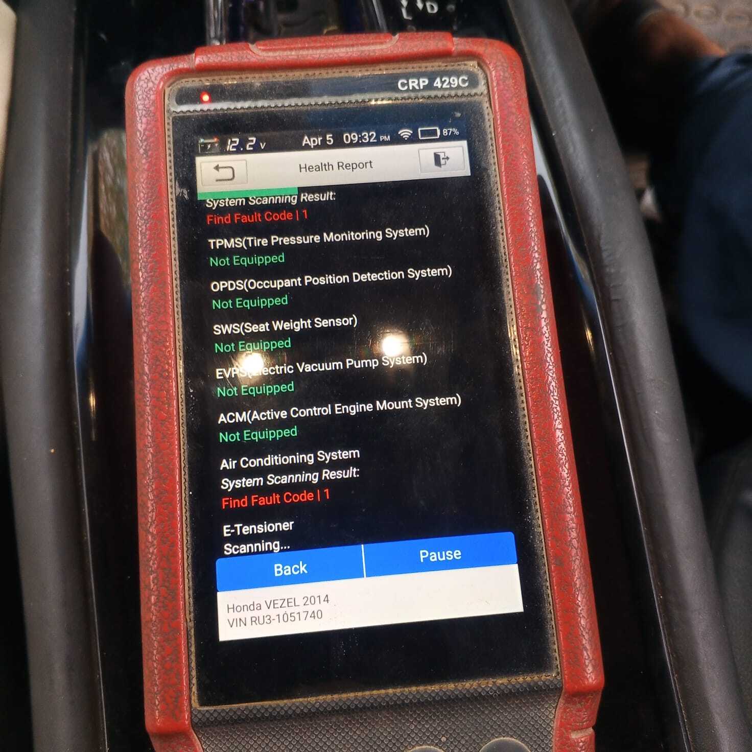

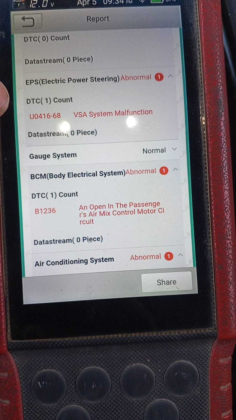

Assalam o alikum everyone,I own a 2014(17 import) Honda Vezel that's driven 124k kms.So far the car has been driving perfcetly with no issues but recently I have been facing this problem where the car shows a bunch of codes and the shifting specially the downshifts become very jerky.Then after some driving the codes go away by themselves and the car starts shifting normally again.The codes come and go by themselves the only difference is that the shifting becomes very jerky when the codes appear. The jerks are felt most in the 1st gear or when downshifting. Pictures of the codes are attached below. Hope an expert can help me solve this issue or guide me towards someone that can help. JazakAllah Khair!
Which city are you in?
Seems transmission issue.
