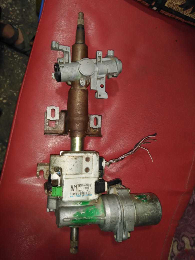

AOA... May nay Corolla 2 may Viganor electric power steering lagay ha (DIY) lakin ab mujay us ki wiring may problem ho rahi ha koi mujay bata sakta ha k may wiring kasay karou us ki may Viganor electric power steering ki Picture b upload kar raha hou
es may modification ki ha kafi cutting our welding houi ha, wo Picture abi nahi ha wo b may ao ko upload karduga pir
Usually the full column of alto or wagon r is altered to fit the car. The wiring and ecu are not altered at all
I think it will take two wires for power
And one for engine rpm. I never tried this so i am not sure about the finer details
may nay tora daka ha YouTube pay es may 2 wire (10A) switch say ati ha as power k laya our baki 6 wire may say 2 wire k beach may 10 OHM ka 1 veritable resistor laga datay han jis say sensitivity controlle ki jati ha, ab eidar peshawar may 1 ya 2 banday han wo kart han lakin wo power steering say zida pasay en 2 wires ko connect karnay k mang rahay han baki sara kam may khud karchuka hou 2 weeks say ghari may use kar raha hou lakin steering bouth hard ha.
