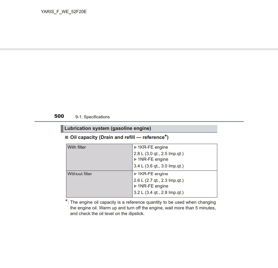

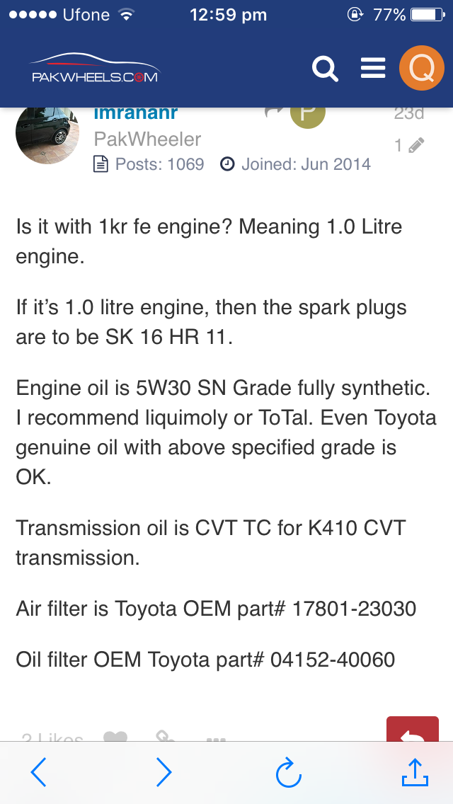

Engine oil grade / viscosity may also depend on odometer reading. For engine oil, use any local / imported brand with the conditions that; oil must be 100% genuine and original, its API rating must be SN (not SM or below it), it should be fully synthetic and its grade / viscosity should be 5w-30 (preferable) or 5w-40 (Max). All these 04 conditions must meet!
I personally use eneos in my Passo, 2013 model. Oil is made in Japan and is performing extremely well, so would recommend it. Otherwise, you may use any other brand, but, avoid ZIC!
