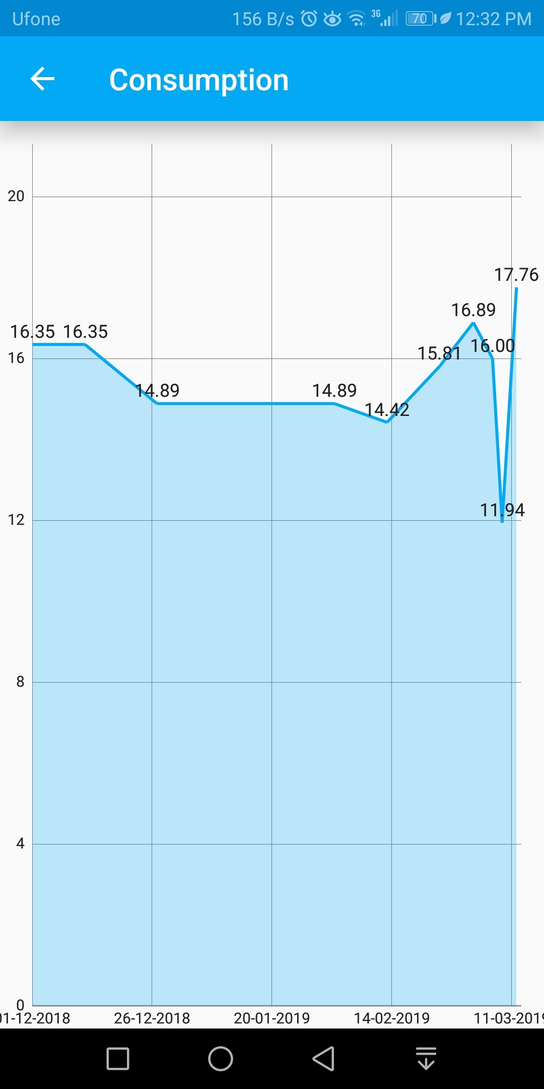

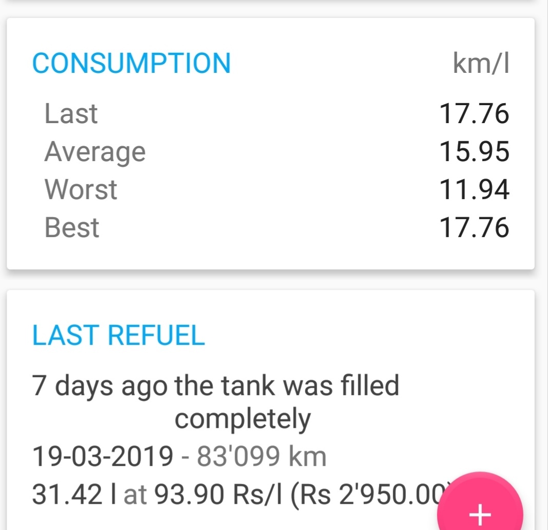

155/80R13 factory fitted tire size.. Milage depends on engine condition, style of driving, engine oil, ATF oil/gear oil, tire size, tire air pressure... My vitz 2001 milage...
17.76 is on motorway wth having speed btw 70 nd 80km, while 11.94 on motorway wth speed above 105km....

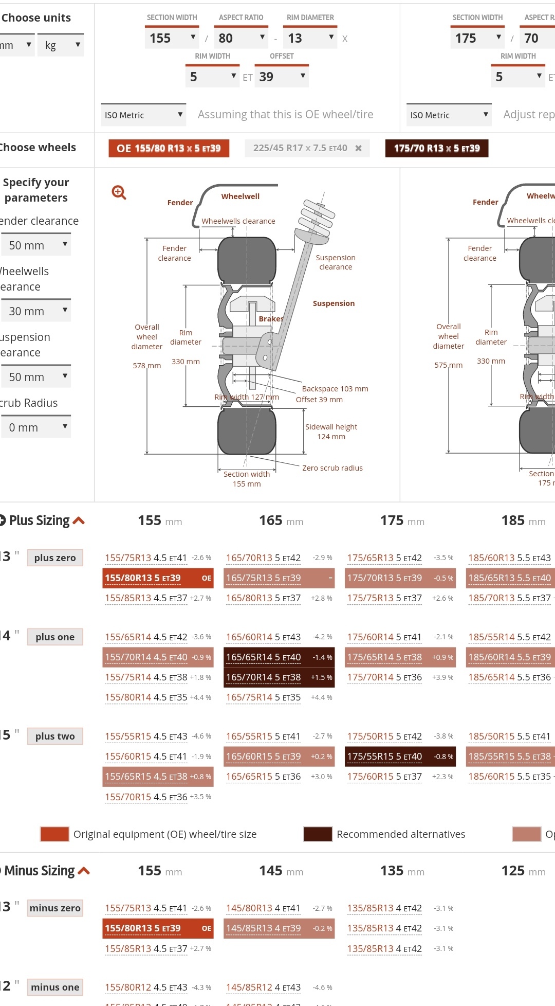

Best tyre size for vitz first generation is 165/80 13...not heavy on engine or steering. Af mileage is around 13 in city and 15 on long on speed upto 80kmph...
I would say 165/75R13... As requmended by wheelsize website..
https://www.wheel-size.com/calc/?wheel1=155-80-13X5ET39&wheel2=175-70-13X5ET39&wheel3=225-45-17X7.5ET40&fcl=50mm&scl=50mm&wcl=30mm&sr=0mm
