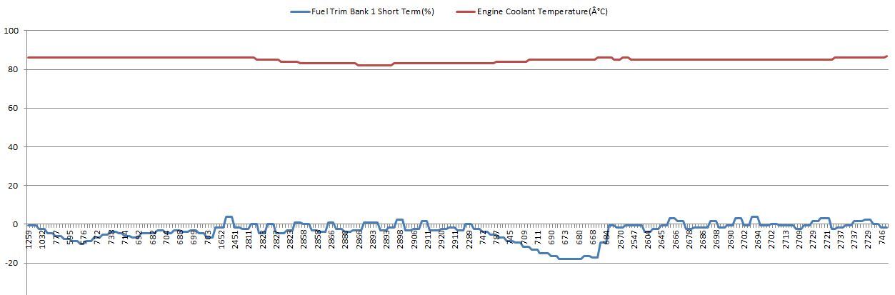

[Update]
Performed the following tasks:
1. Exhaust leak checking before o2 sensor
2. Injector leak checking nd cleaning
3. Fuel pressure regulator checking
4. Temperature sensor checking
5. O2 sensor checking
6. MAF sensor checking nd cleaning
7. Checking air filter assembly fr leak
8. Clean grips of o2 nd maf sensors wit contact cleaner
9. Engine compression test
and resetting ECU a dozen time after every step
Alkhmdulilah at last i got solved the issue today and it was loose intake manifold bolts due to which unmetered air was entertaining the engine.
Nw ltft is within the range of -3.91 and 3.12
