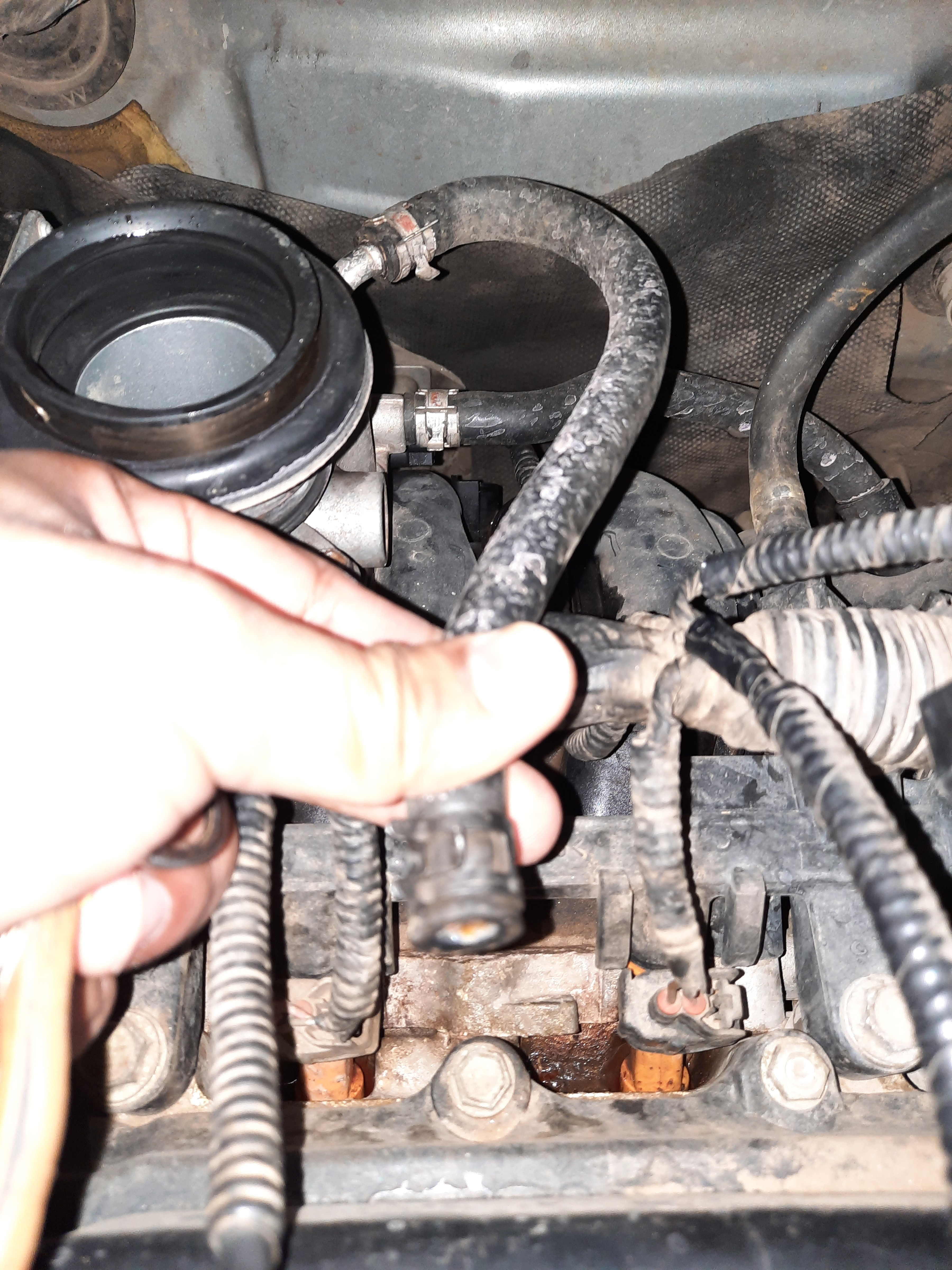

Mainy aj gari ka oil Air filter change kerwaya ha or tuning b kerwae ha , 3 hours ka bad jb maina car on ki to car ka radiator ka fan on hogaya or wo bnd nhi ho raha tha, or heat indicator light b on hogae .kea problem hosakta ha? Vitz 2012 model
Have you checked the coolant level in radiator?
I fear, the mechanic has messed up a few things, while doing "Tuning".
I think he has bypassed the fan to be direct while you still have the thermostat valve in place.
But that shouldn't send the heat up signal
Did he open throttle body while tuning? Check if coolant hose to throttle body is connected.
yes he open throttle body while cleaning
coolant level is full and reserved level also full
Check the coolant hose connection to throttle body.
Check the radiator cap and reserve bottle caps if they are tightened property.
What else did he do as tuning?
both reserve and main pipe is full with coolant
he has changed the air filter, cleaned the spark plug ,change engine oil , I also do wheel balancing and alignment by today
