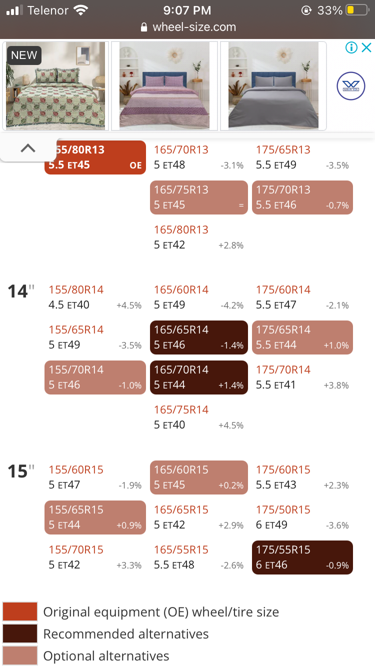

Hello Pakwheelers recently bought vitz 1999 1.0 convert to 1.3 … tyres are week so i want to replace them which tyre size is best for comfortable ride and fuel economy current tyres size is 165 70 r14
OEM Size: 155/80R13 Upsizes: 165/75R13 175/70R13 175/65R14
175/70/13 will be good size and will not impact fuel economy.
Which size is good for comfortable ride 175 65 14 or 165 70 14?
I want 14 inch tires that don’t affect suspension
For comfortable ride use oem size
175/60/14
Comfort relates to side wall size. In 14 inch you have only choice of 175/65R14.
Brother i m confused between current 165 70 r14 or 175 65 14.. 165 70 14 looks good in car not too big but they are 2016 made smuggled hard tyres
Use the following link to determine the size
https://www.wheel-size.com/calc/?wheel1=155-80-13X5.5ET35&wheel2=225-45-17X7.5ET40&fcl=50mm&wcl=30mm&scl=50mm&sr=0mm
60 sidewall is to low car will hit speed breaker
