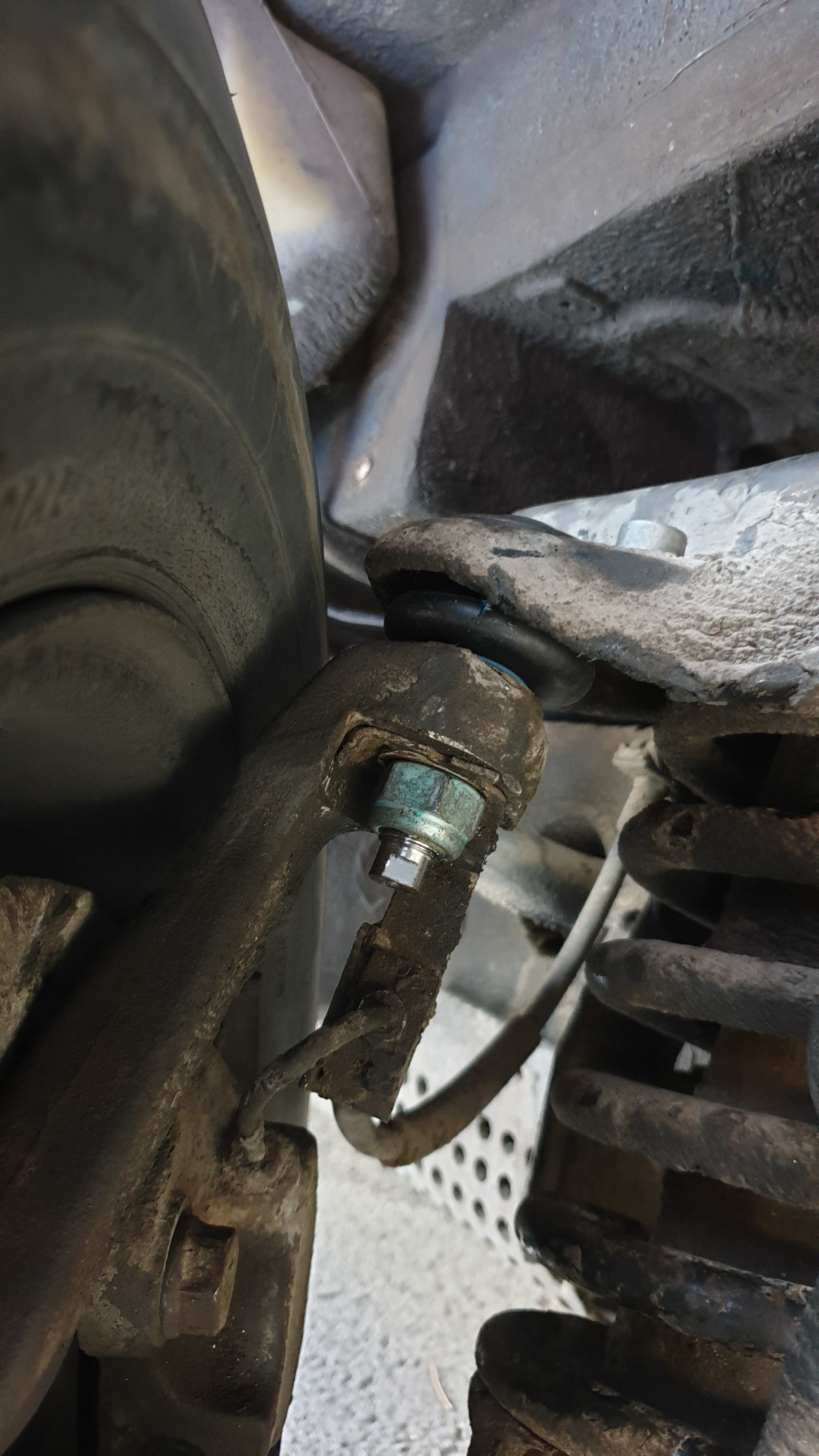

I was super surprised to see the condition of the rubber parts. Yes they were a bit squished but not as bad as I would expect on a 34 year old equivalent Japanese van. In the pictures below it will be seen that old grease and muck on the suspension parts has not been removed. My thinking is that if after 34 years there is not one square mm of rust and the factory cadmium coating and paint on, springs, control arms etc. is still in tact, then why disturb anything?
Anti roll bar drop link bushes. The upper one was just fine including the anti roll bar mount bushes. Hence they were left alone. However in future they decide to fail, I already have spares on hand.
