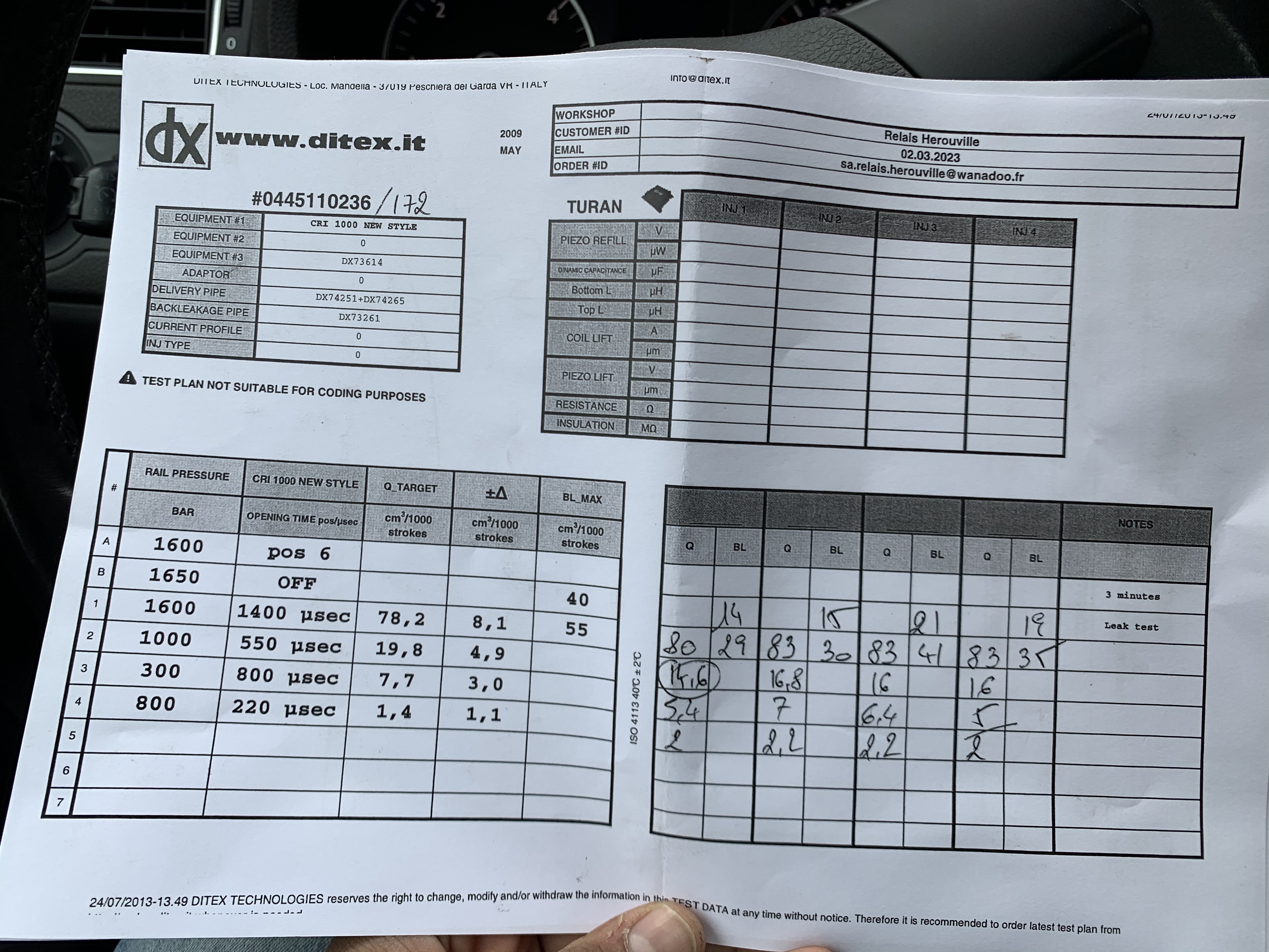

Xulfiqar bahi, can you help me regarding these bosch diesel injectors test, honda i-ctdi 2.2 diesel , 2005 europeon accordAre these ok? Car is giving no issues, copper seals were leaking, hence i got them tested from Bosch before putting back in
