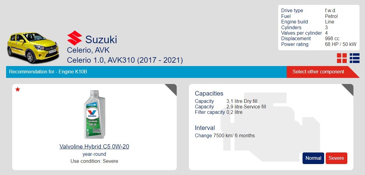

attaching pic for reference

so just incase you're going to use 0w20 sgo fully synthetic, use it for 7500km/6 months
even brands like liquimoly and valvoline recommend 7500 kms/6 months for their oils under severe service
here's reference
