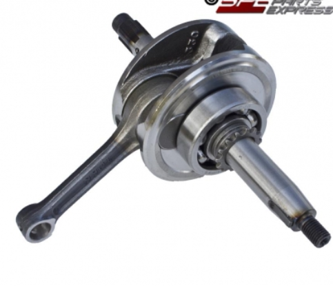

is ka mutlab ye hota hs ke full engine open ho ga or crank shaft par jo bearing ha wo change ho gy con road bi argest ho gi or bi jo cheaz karab ho gi wo theek ho gi or ye hatdly 3 hazar ka kam ho ga
Weight in lay man terms is crankshaft that is
Usually the connecting rod and piston pin gets spaced and that causes play and noise in the engine. It gives knocking sound and missing on timing.
Uff Allah bike was in great care of mine pata nhi kese hogya ye sub. And faizan bro are you sure that 3000/- will be the charges
Use ka sath cheez ma play aa jati hai It will be more than 3k. Jab ap open karvao ga to mechanic insist kra ga ka sab new parts dalo.
At least kitna kharcha hoga total apke andaze se?
At least 6 sa 7k ka aas pas but it depends upon parts you use. Ager ap sab kam khud bhi karo to minimum 3k la jata hai (all done by yourself)
