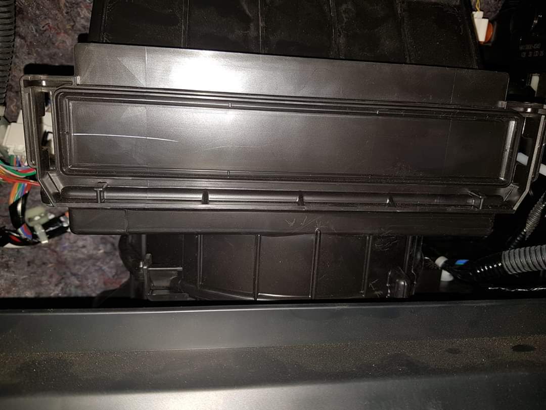

Honda BRV AC Filter Issue
Remove glove boxThen filter coverAnd remove old filter Place new filter Place coverAnd again fit glove box in dashboard Also check onwer manual for procedure This might help
Are you sure that air filter is inside assembly? Because same like this, wagonr assembly is sealed and no filter is put insideSome wagonr owners have cut that plastic piece and placed aftermarket cabin filter
That's not sealed it has lock on either sides remove those locks and it'll be removed
It is sealed and there is no filter present
watch this vid this guy over reacted but he tells how to install one
