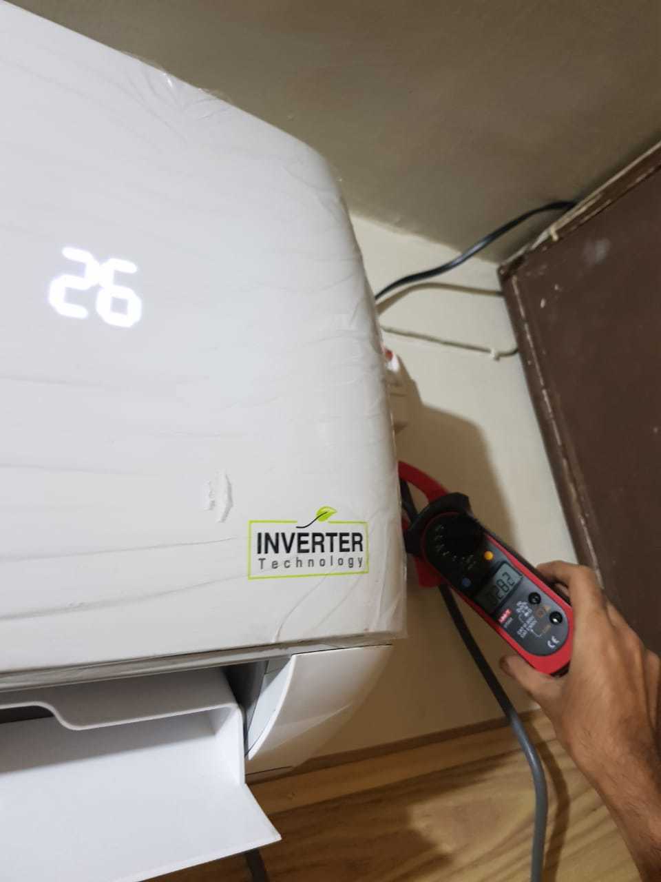

About consumption when cooling is achieved it consumes 480 - 550 watts on 28c, Ampere varies due to voltage and in my area voltage is usually low at peak hours around 180Volts, so it takes around 2.8-3A which converts to ~550Watts. And if 230 Volts are coming it takes around 2.2A which converts to same wattage. But I've not seen it go down below 480 Watts.
On turbo mode it consumes Max 1600-1700 watts ~8 Amperes in start and gradually comes down to 500 watts.

I'll suggest you to attach energy meter with your AC and monitor power consumption yourself for few days to get an idea about its performance.
