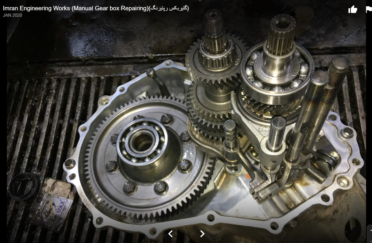

IMO learn to live with it - the alternative is to get it properly rebuilt. If you get it changed from the junkyard, there is no guarantee that the replacement had it's oil changed regularly either.
