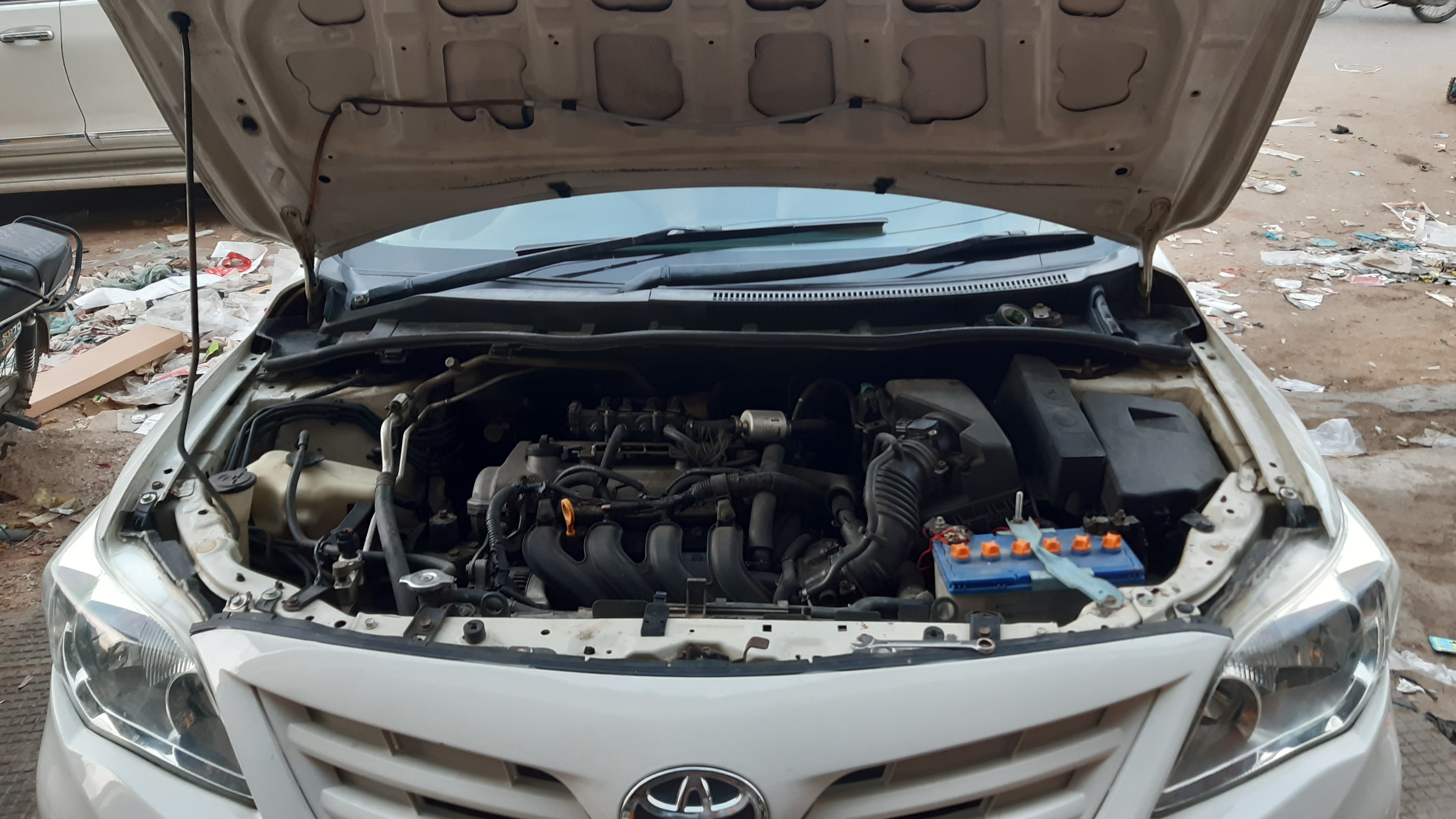

PCV for your 2nz and similar toyota engines is located on the valve cover. Its a small L shaped plastic valve with a small pipe attached to it. Take the plastic cover off and you will see it.
A very basic test is to remove the pcv valve and see if it rattles, if it doesn't, it's most probably choked. You will have to replace it then.
