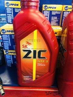

Interesting point in the zic bottle
They say its ok to use in ford mercon V cars and chrysler atf+4 cars but for mercedes they stop at 236.9
Funny thing is that chrysler atf+4 is used in mercedes benz 5 spd automatics when its bolted to a chrysler car and its original fluid is benz 236.10 spec atf (shell atf 3403-M115)
As this is Pakistani market zic atf, they are being extremely economical with the truth as no one has any car warranting use of mercon v or atf+4 in Pakistan, but as people own mercedes benz, they have not recommended those cars (while those cars use atf+4 perfectly fine)
I would not use it in any hfm atf requirement car and keep this for at max dexron 3h cars
