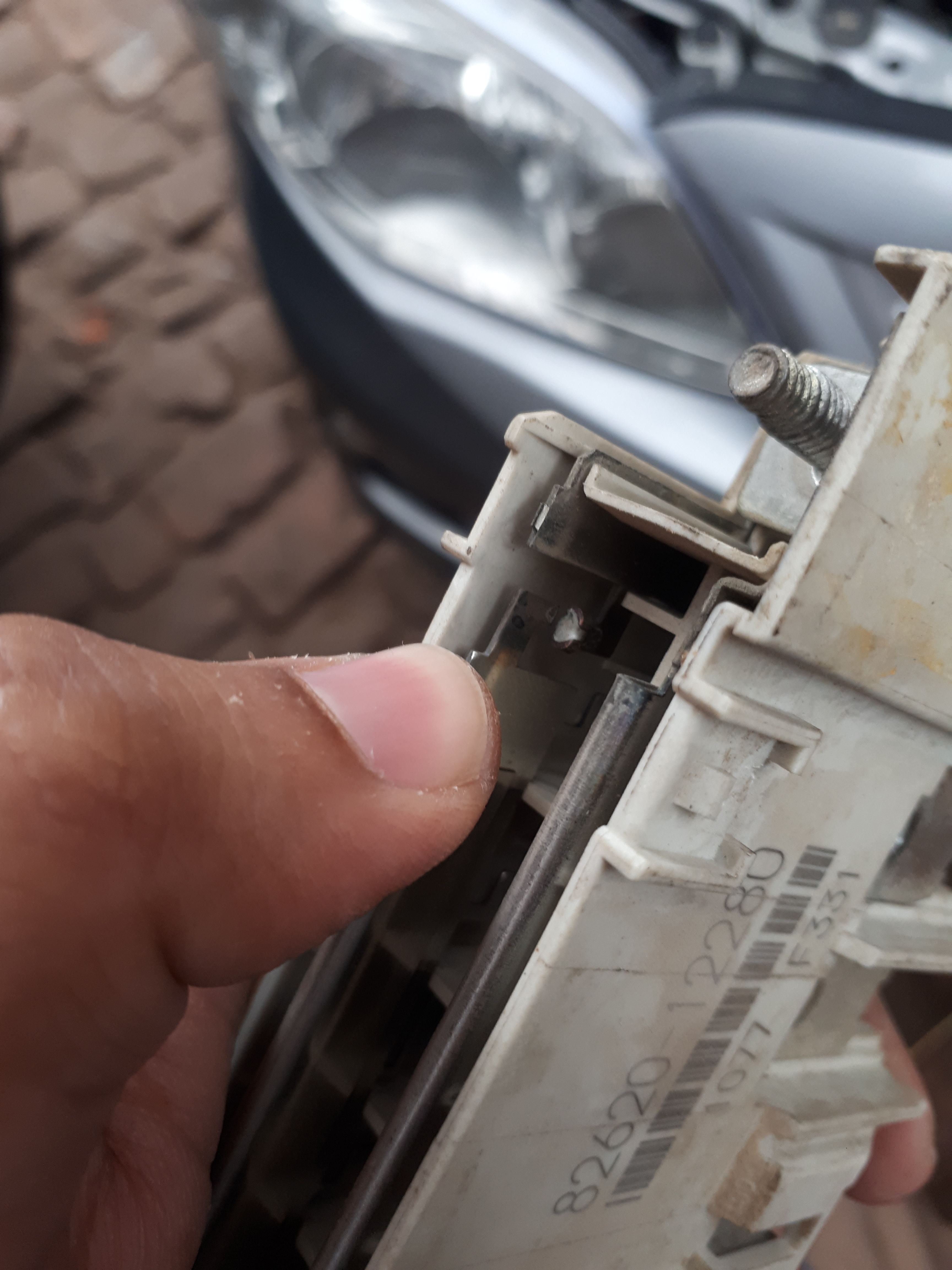

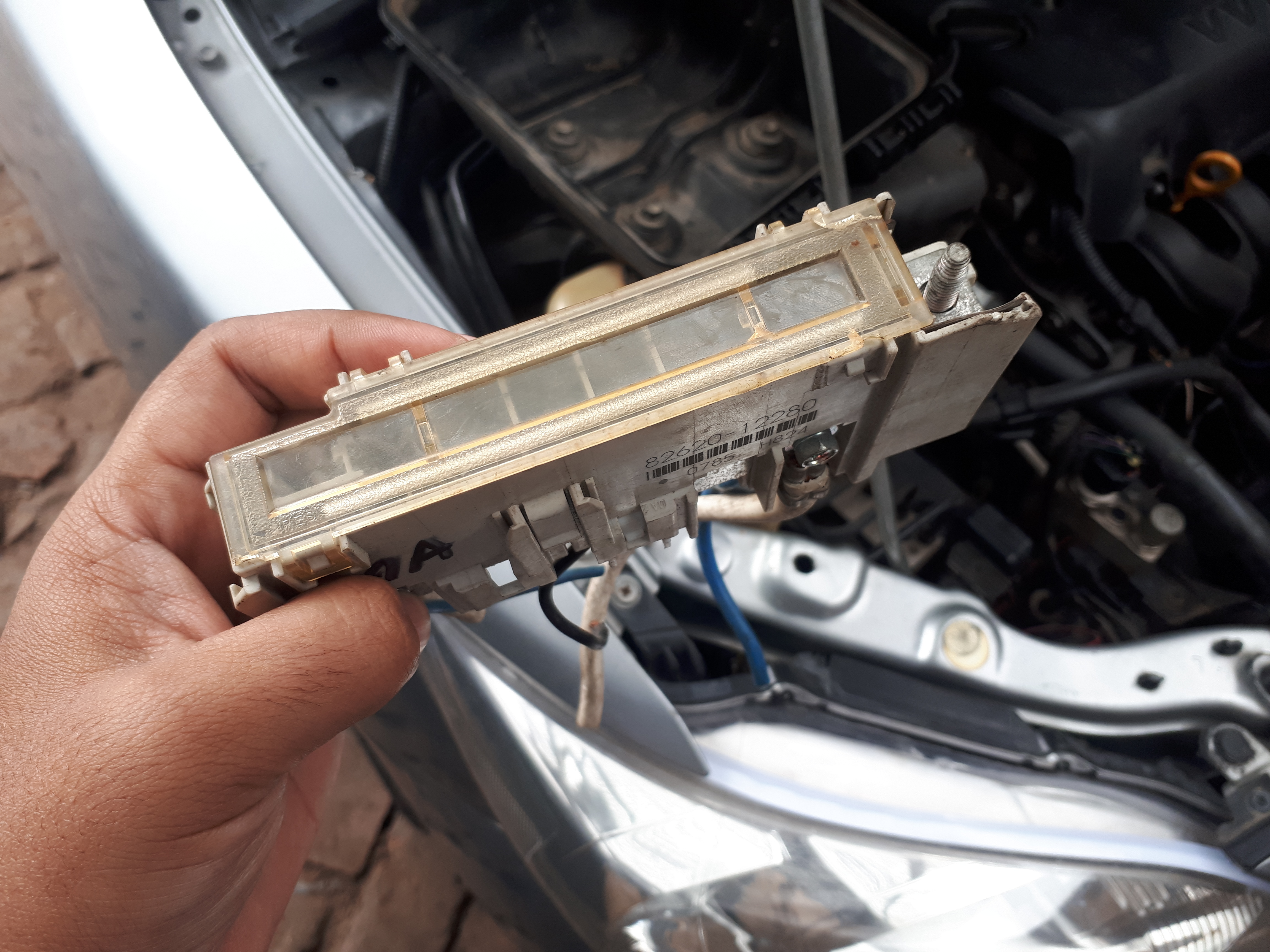

Asslam o Alekum to all respected senior members,I hope all will be fine and enjoying your life.I want to share a bad experience that was happen with me yesterday by mistake.Meri gari ki battery down ho gai thi aur me dosri gari ki battery utar kar apni gari mee laga raha tha. same batteries thi aur night me + aur - ka pta nai chala by mistake battery k points ghalat lag gaye. battery wali wire se dhuwan nikla aur spark hua phir pta chala k point ghalat laga diye... jub dobara theek points lagye to gari start na hui kuch b nai chal raha tha fuse box check kiya. koi 5 ya 6 fuse jal chuky the wo replace kiye but phir b nai hui. bas aesa lag raha tha k koi 20k 30k ka teka lagne wala hai, electrician ko bulwaya us ne check kiya Thanks to ALLAH k main 100amp wala fuse burn hua tha. jis ne sub electrical components ko save kar liye aur ECU bach gea.i will share the pic of main fuse box which was burnt. to kehne ka matlb yeh k battery change karty hue ya wire k sath start karty waqat polarity ka bht kheyal rakhen warna bht ziyada nuqsan b hu sakta hai.shukar hai k mera 4k me sara masla hal hu gea tha.
Installed kabuli main fuse
Burnt fuse
those fuses are planted for same purpose
btw.....always use light or even mobile torch doing this kind og work
ground terminal is shorter in size than positive for same reason......
yes bro
