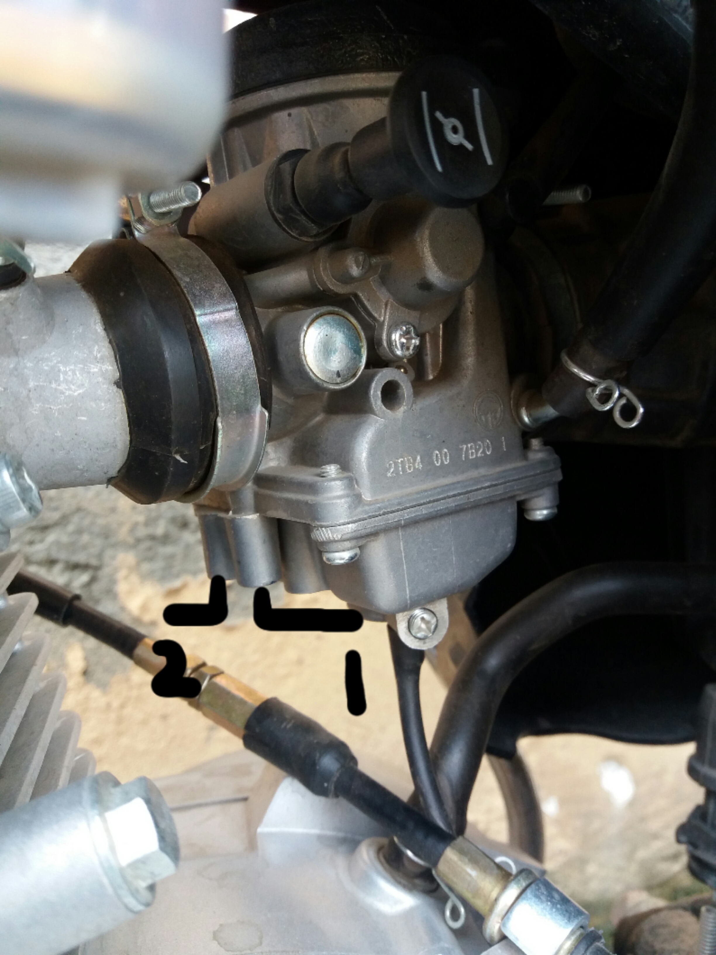

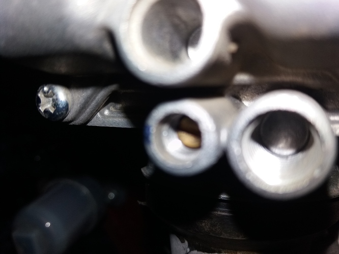

No. 1 is air mixture screw other one is block there is no screw there. its best to follow the standard mixture setting procedure when the engine is start and bit warm.
1. start the engine and warp it up.
2. set the idle RPM at 2K.
3. now close the air mixture screw by turning it anti clock wise close it completely dnt apply extra force.
4. when the screw is completely closed or tight now start turning the screw 1/4 of a turn gradually clockwise and check the idle rpm continuously keep turning slowly at 1 point u ll get the maximum rpm around 4K RPM. this is best setting. just turn a bit or 1/4 of a turn further clock wise for best mileage setting.
experts here kindly check this if something wrong is stated kindly do the correction.
