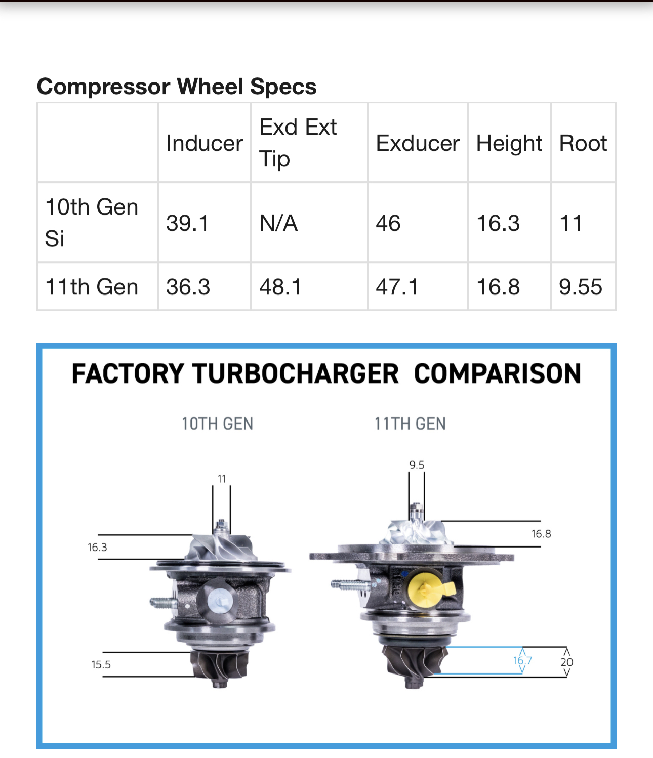

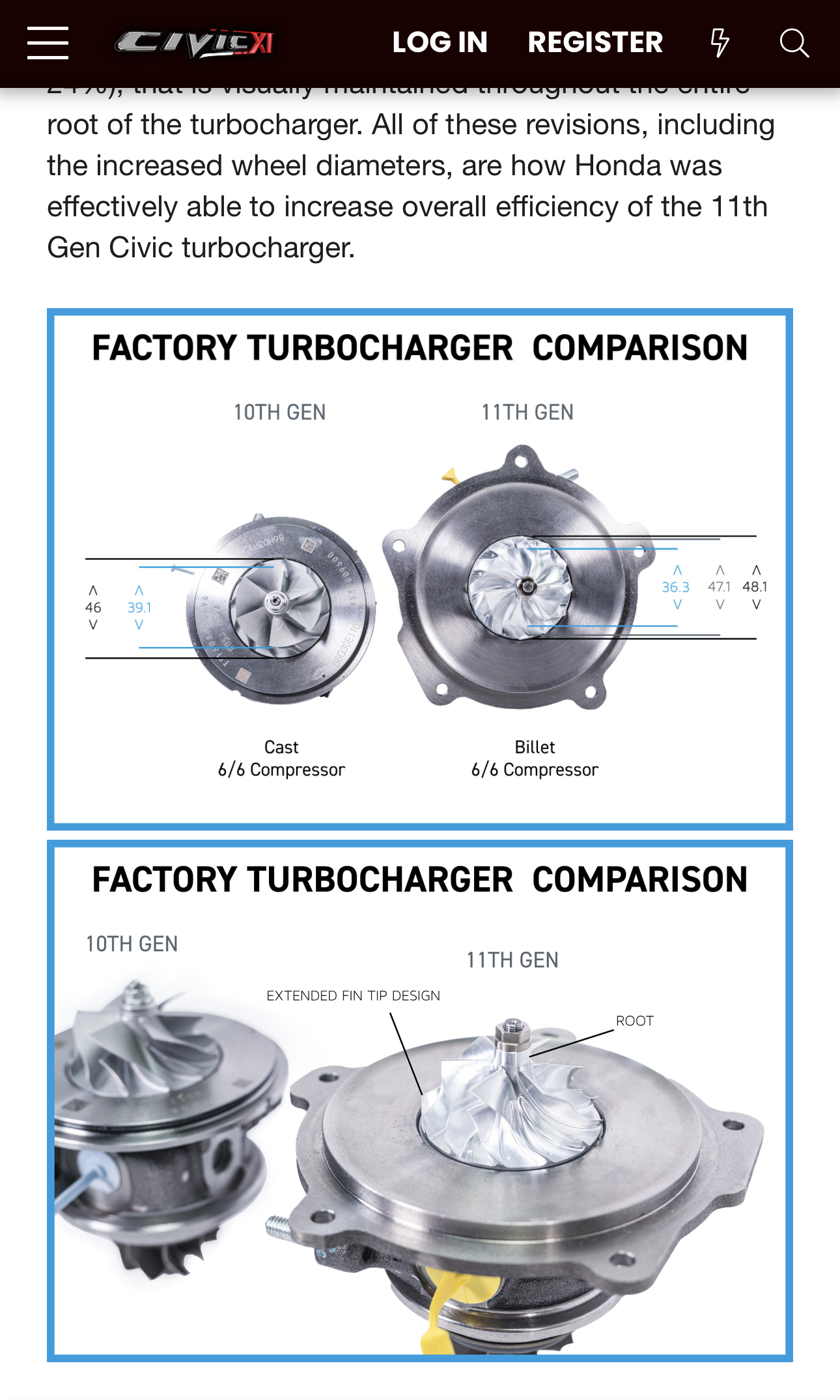

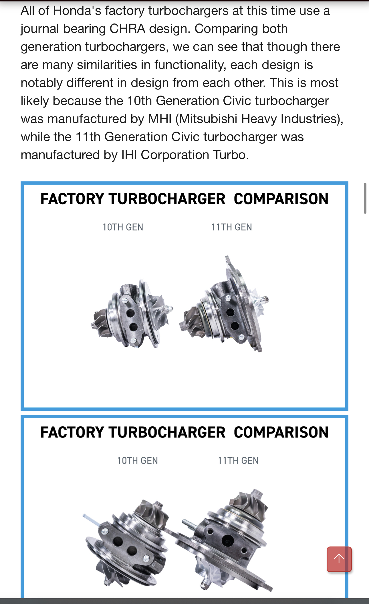

On rolling when hitting 3500+ rpms, X1 is well ahead of X but on start X is quicker in any case (tuned or stock) .. something to with IHI turbo here..
