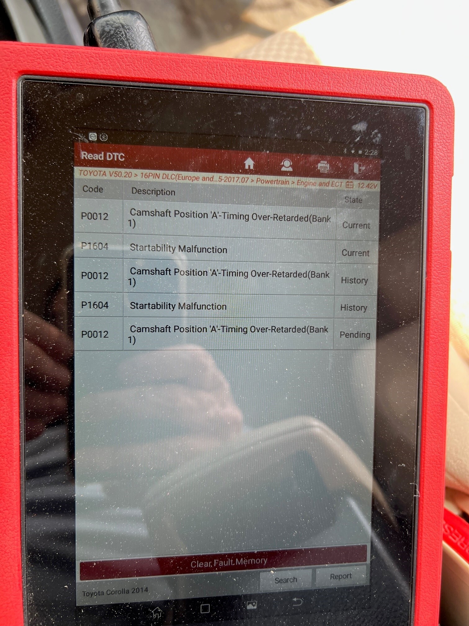

Went to the workshop this morning. The scanner showed the following error codes:
The mechanic replaced the timing oil control valve. Again connected the scanner. All codes cleared.

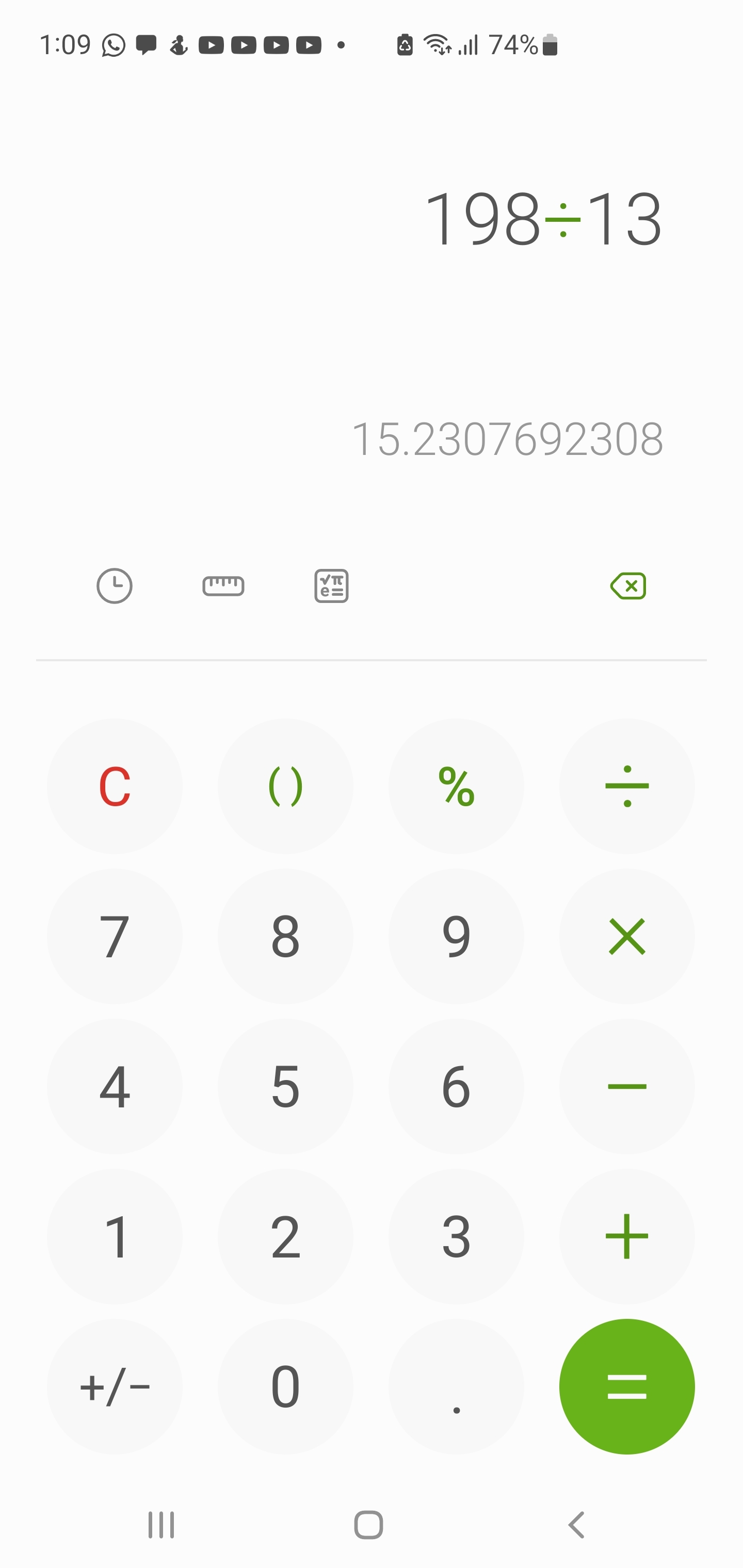

Drove the car for another hour, no check engine ight, the fuel average increased to 12.4 in the ciy with AC on. I never thought the mileage will improve this much. Engine sound is good. The drive is good.
