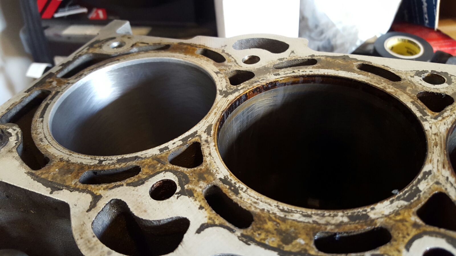

You bet - a bore hone is super cheap and can be done inframe too - but requires skilled person, not a scrap parts changer. Too bad people wont pay the skilled person wage but will treat their entire family on their birthday - lol
choices - choices.
I remember some mechanics praising a glazed cylinder - saying ye chalta hai solid - kesa jenyan japani chamak raha hai - umm, excuse me Mr idiot - that is a dead bore.
See that - thats myself deglazing the cylinders on a mazda MZR - the next one is visible that its shiny - takes a minute at max per cylinder. - After this then I spend close to an hour cleaning the engine (you see the cooling area suface - its literally gunked with mineral buildup because the owner used tap water to dilute coolant after a replacing a hosepipe)
