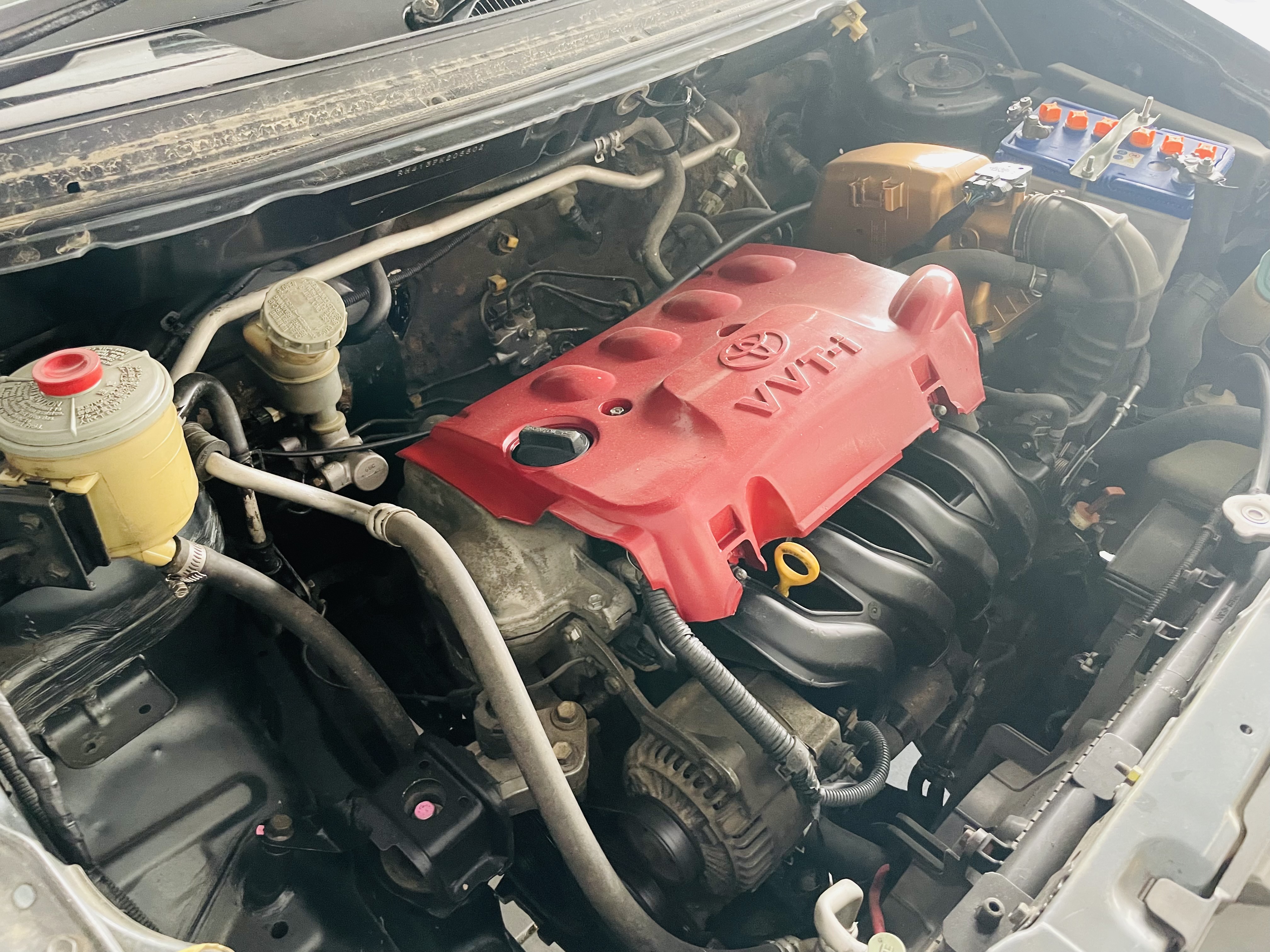

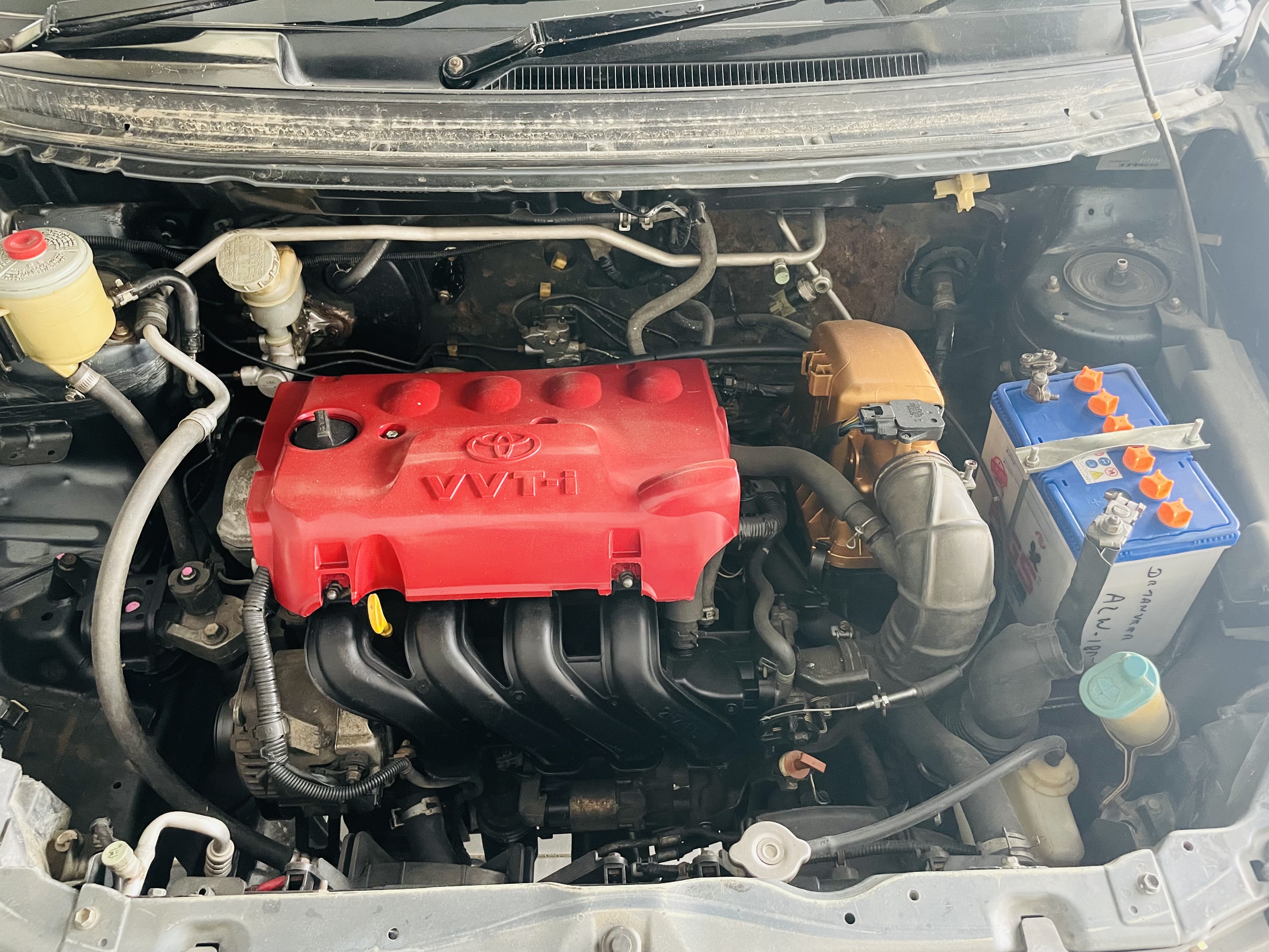

This particular car is parked with seize engine since 9years. It doesn’t have rust but molds in all over interior. It took 2 months to recover it from top to toe. I had good experience with Toyota engines do far so i put 1nz fe in it. Out of 4 three mounts installed on previous mount points one has to develop under the battery section.

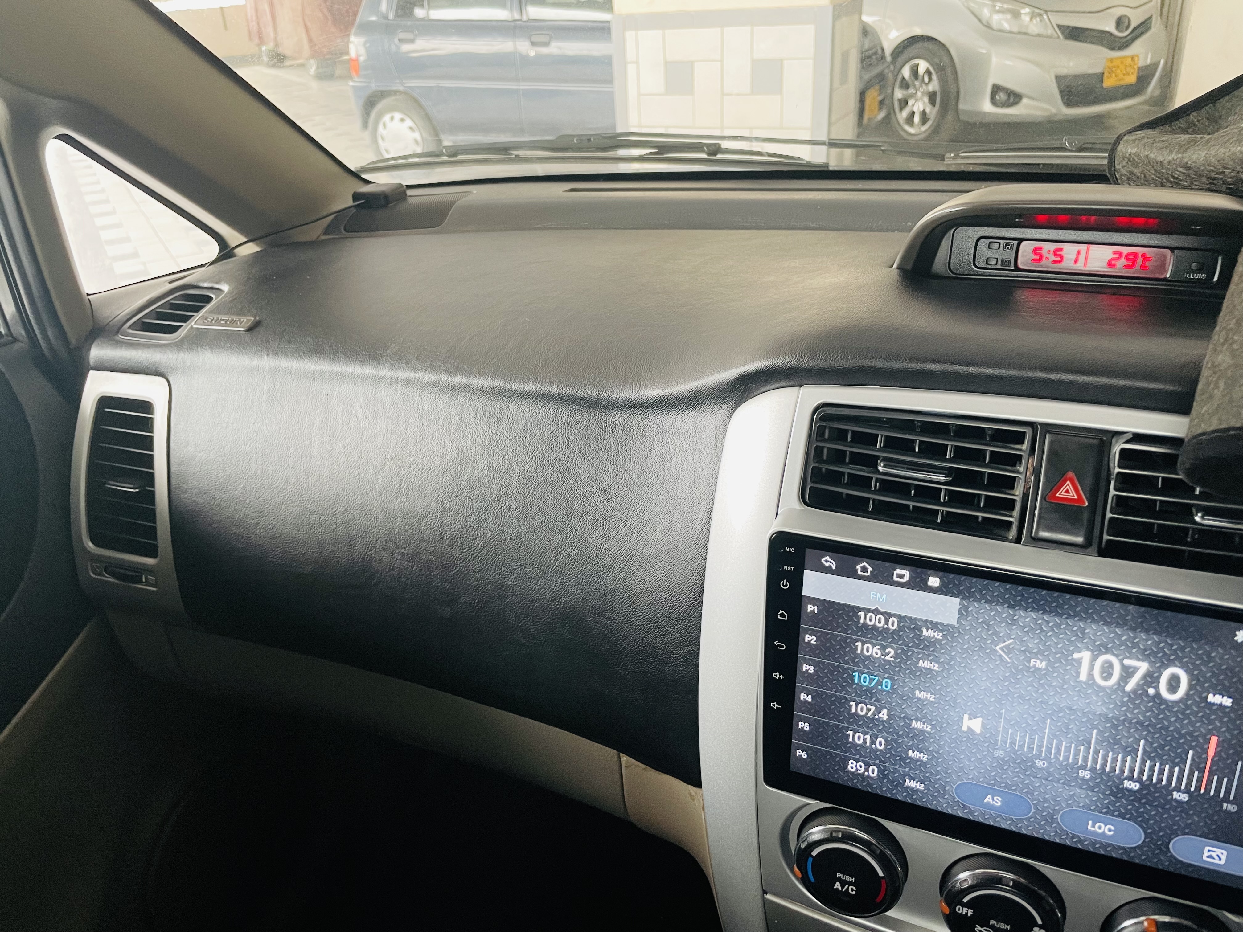

Dashboard repaired as it has cracks and molds. Moreover its screen and climate control were stolen while parked so long.

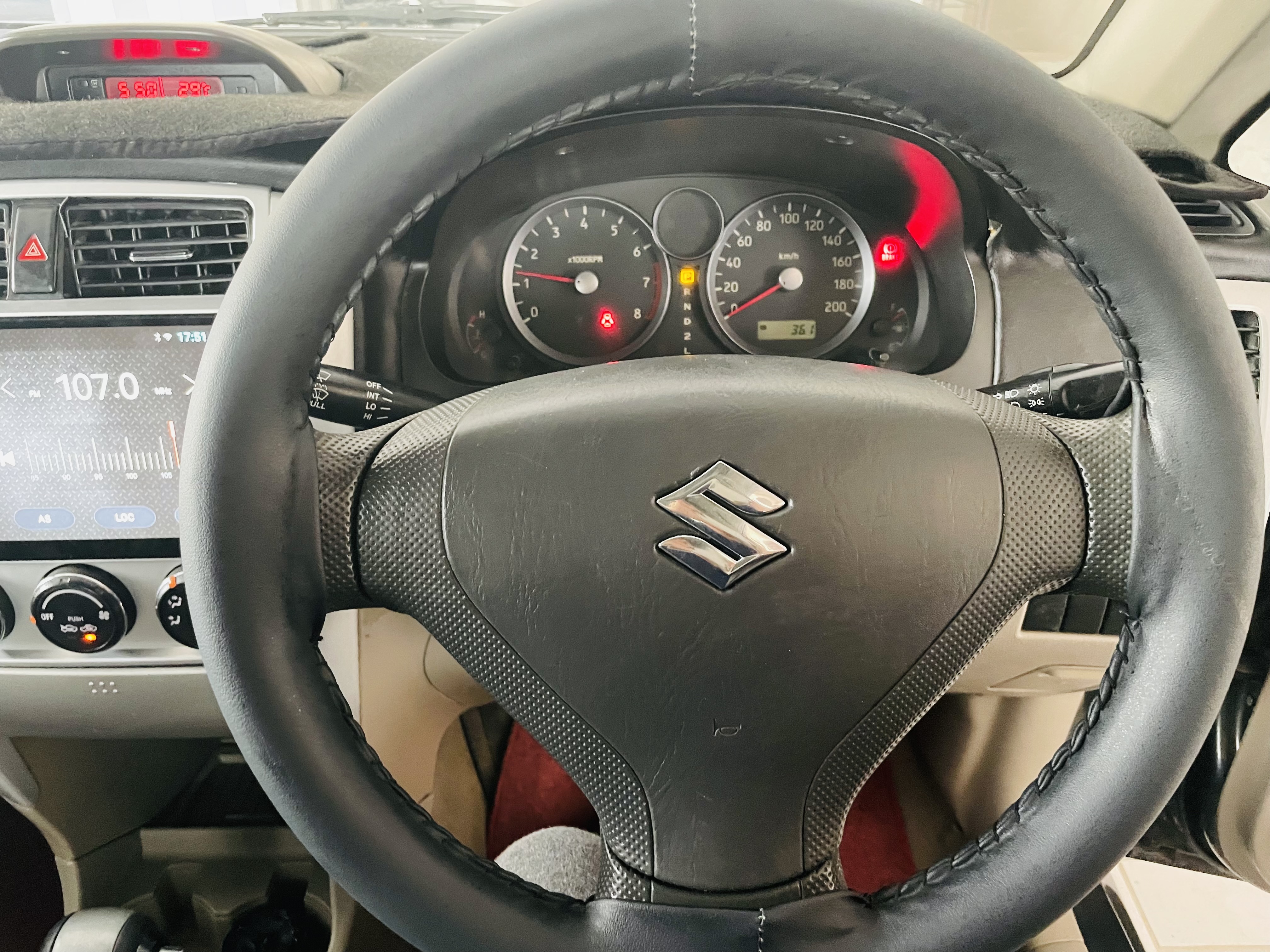

It’s meter and brake paddle are of liana emenent.

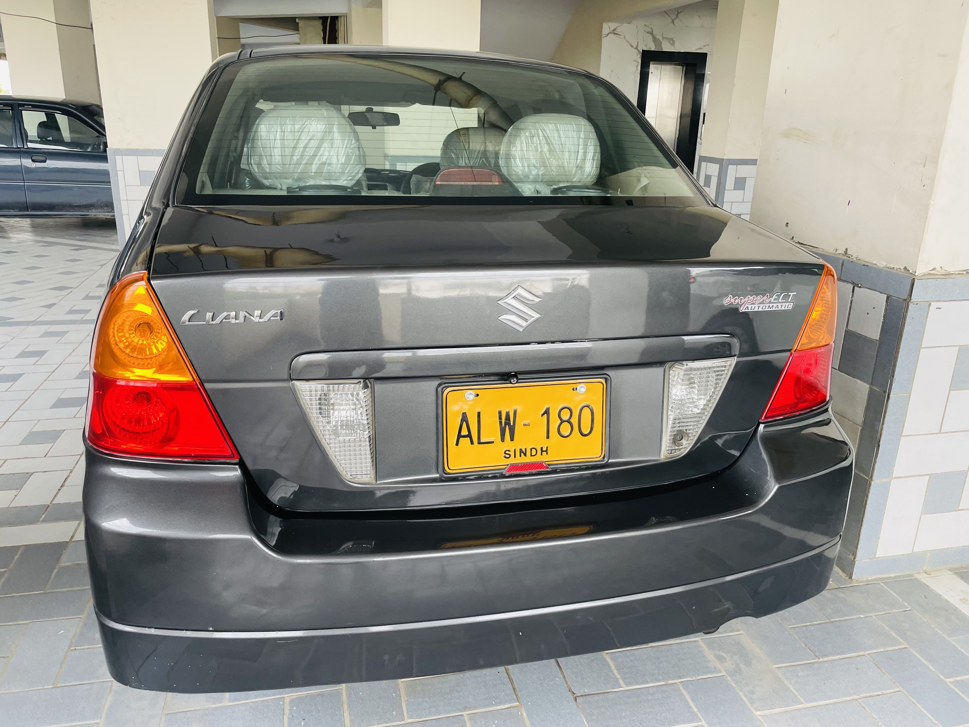

It’s color is grey of Toyota grande. And paintbis done in toyota paint booth at dealership.
