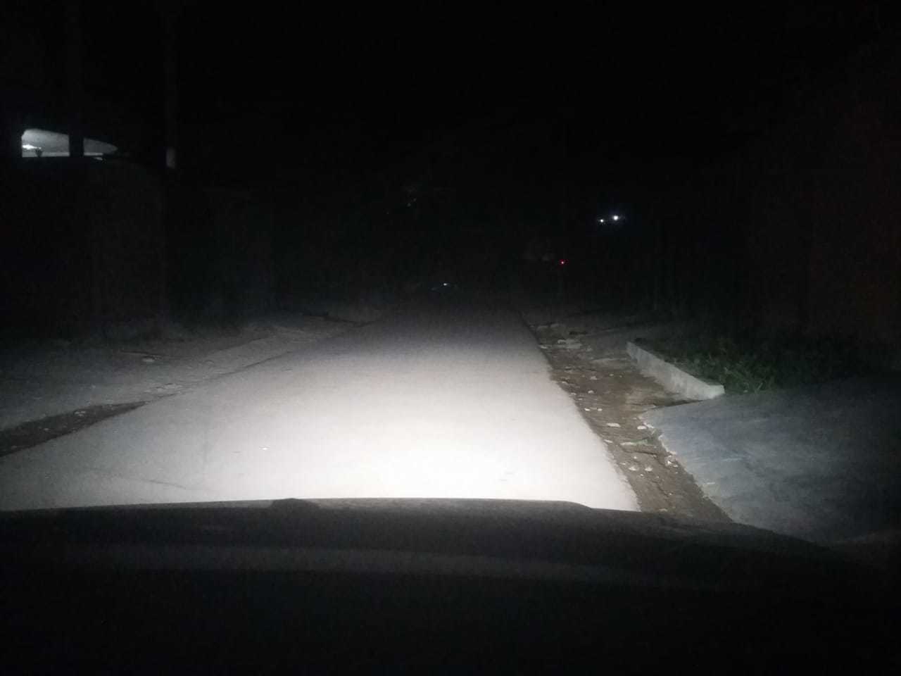

I am using 55-watt HIDs in headlights. I always wished to have projectors as HIDs without projectors are blinding people. Yesterday I went to Saddar Peshawar and asked about bi-xenon projectors. Most of the shopkeepers told me projectors won't work with your normal headlight glass/lens as it has lines/flutes. I searched for lens without lines/flutes but all results negative. I came home and searched the web for a solution and found a thread in which a person explains how he removed the lines/flutes from headlight glass/lens. I bookmarked that thread, went to Saddar, installed projectors and took below pictures
The alignment wasn't done right. I did it today. I will post a picture of the new alignment later.

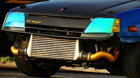

Here are engine bay pictures
