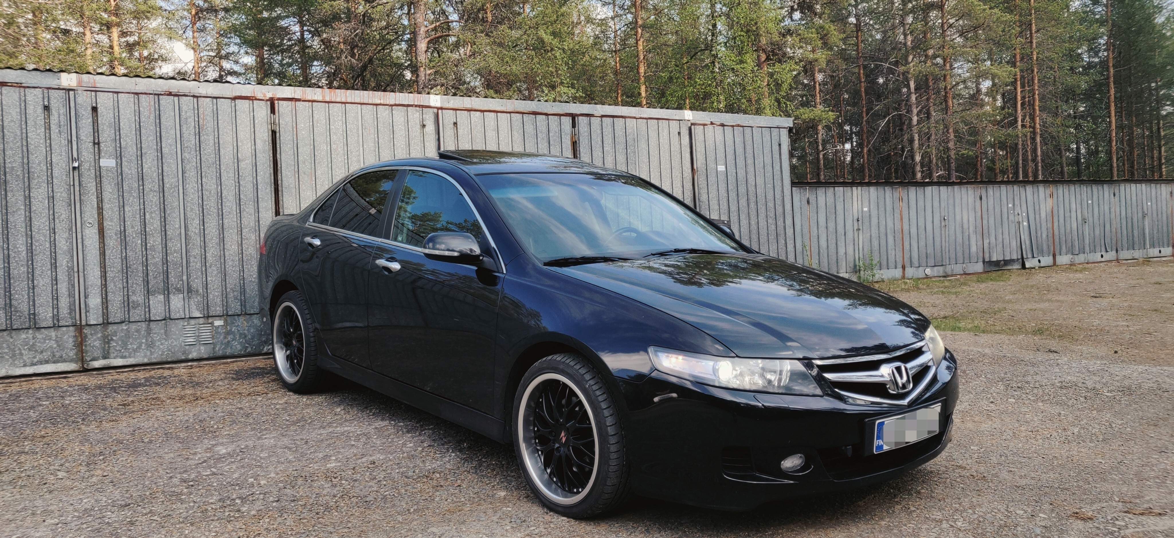

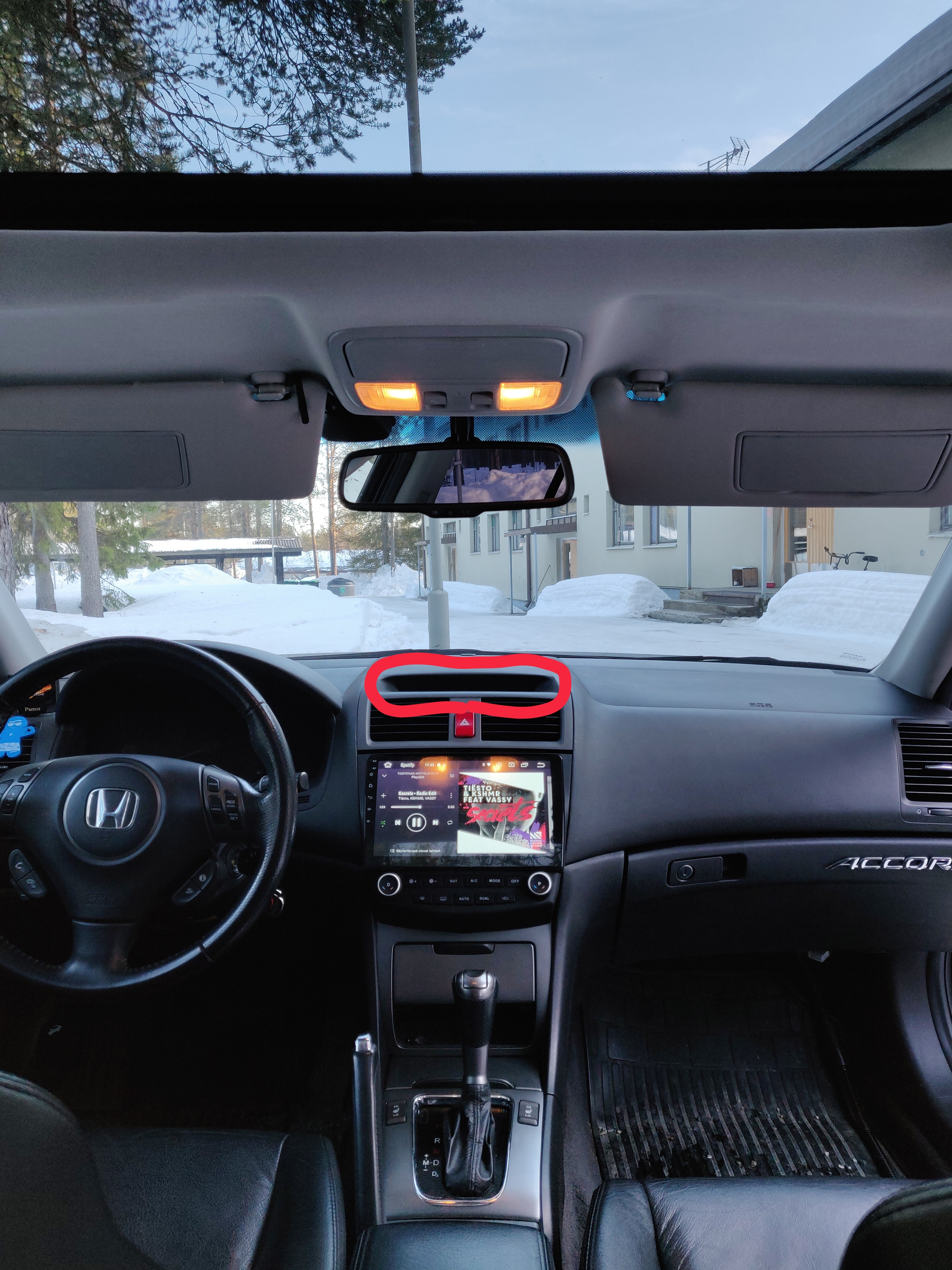

My CL9 is 2007 with executive X trim, which has all the goodies (heated leather seats, navigation, Bluetooth etc) except adaptive cruise control, which I believe is super rare to find. My car has the standard cruise control.

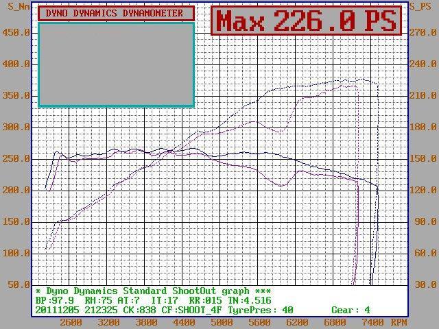

Few months back I equipped it with flashed ECU, which changes the VTEC engagement point lower (4600rpm), and raises the rev limiter higher, to 7600rpm. Also DBW optimization for a better throttle response and feeling : pedal position is set 1:1 to throttle position, without any compensation so it behaves like a wired one. The stupid "lag" is gone when pressing throttle pedal. And fuel maps tuned for lower fule consumption at low rpm during normal driving or cruising.
