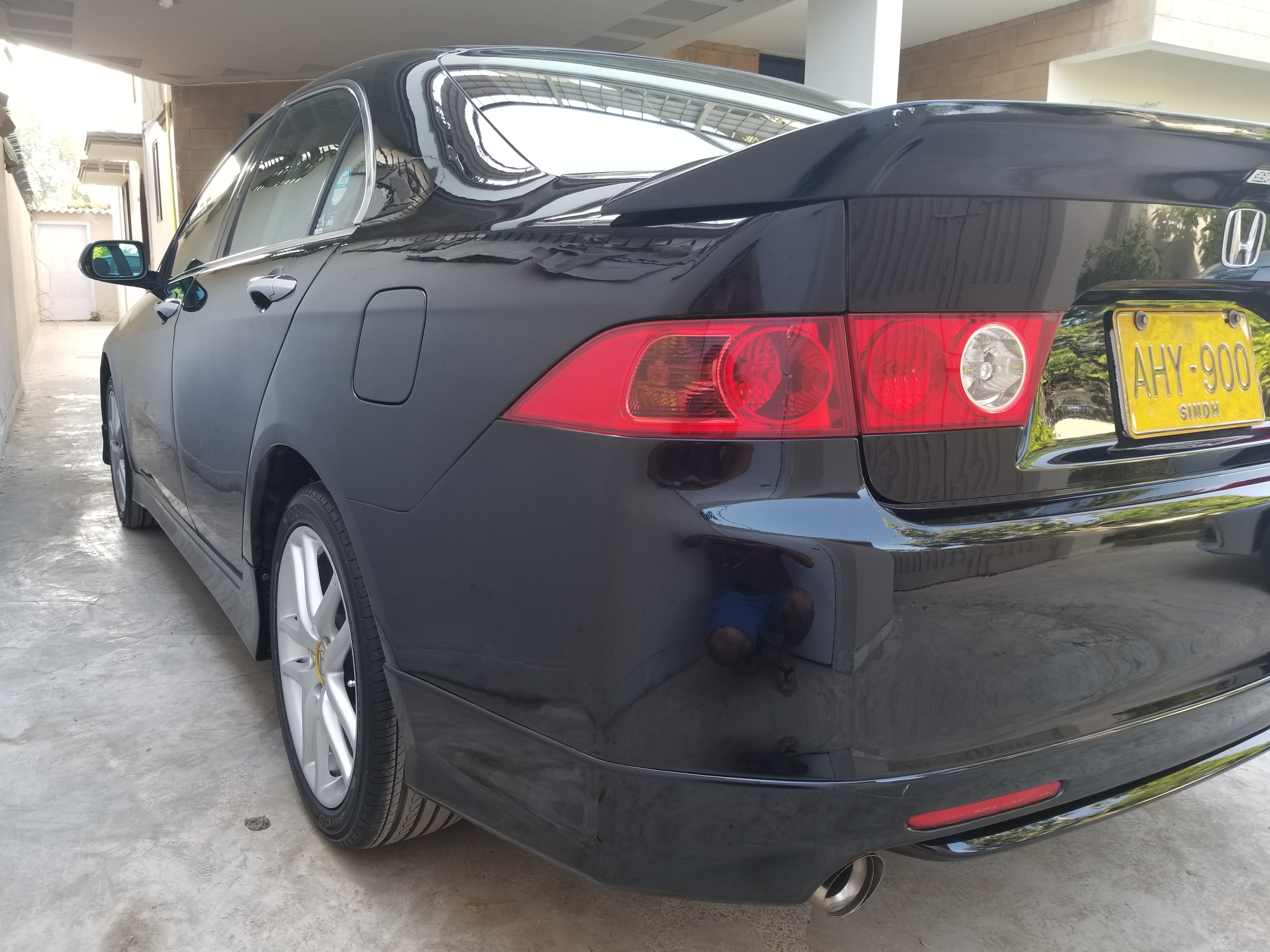

Nahin yar, I can literally list out everything (other than shocks):
- Advan dB 215/45R17 which I got new
- OEM rims, wheels balanced
- OEM brake pads, discs polished, brake oil flushed
- All wheel bearings replaced with OEM
- Axles fine, no vibration, sound or leakage
- Lower arms fine, their bushes fine
- All other suspension bushes fine
- Ball joints, no play
- Both rack ends replaced with OEM ones
- Steering rack boots fine, no sounds, no codes
Car is non option one so should be lighter. No CNG ever, even body kit is factory one, only spoiler is aftermarket. Stock sound system, stock engine, I mean I can't think of anything other than shocks/springs.
In fact I even went to a couple of different mechanics just to get their input on shocks and both said they're fine.
So much so that I'm planning a road trip in June and ground clearance might be the main factor which makes me take Civic instead of Accord.
