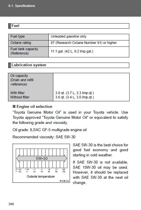

Myself got spider vitz few weeks back. Not a car guru but fortunately found toyota's vitz company manual suggesting 5W-30 to be best. Now the only task is to find genuine oil. I'm providing you downloading link of this booklet and also attaching the snap of page no. 346.
https://drive.google.com/file/d/1YU6K4orPmhH-lV8a4ZaNCD7j7j9DKO8z/view?usp=sharing
You can get Toyota 5W30 from Toyota 3S.
Ensure that it’s API SN. Don’t buy if it’s SM.
This link to Manual is for Yaris 1.3 or 1.5 liter. Not for 1.0 L for 1kr-fe engine.
