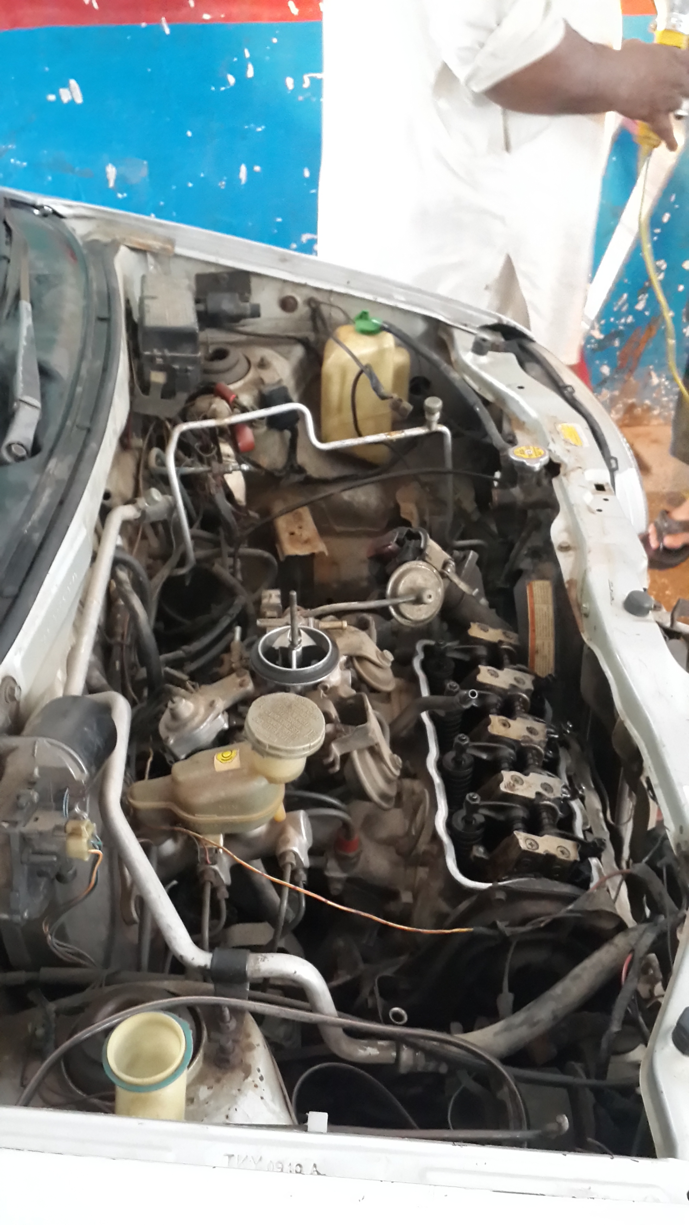

Hey guys, this is my first post in pakwheels forumI got my alto vxr 2006 model overhauled a few days agoThought i should share the info, it might be helpful for some of us

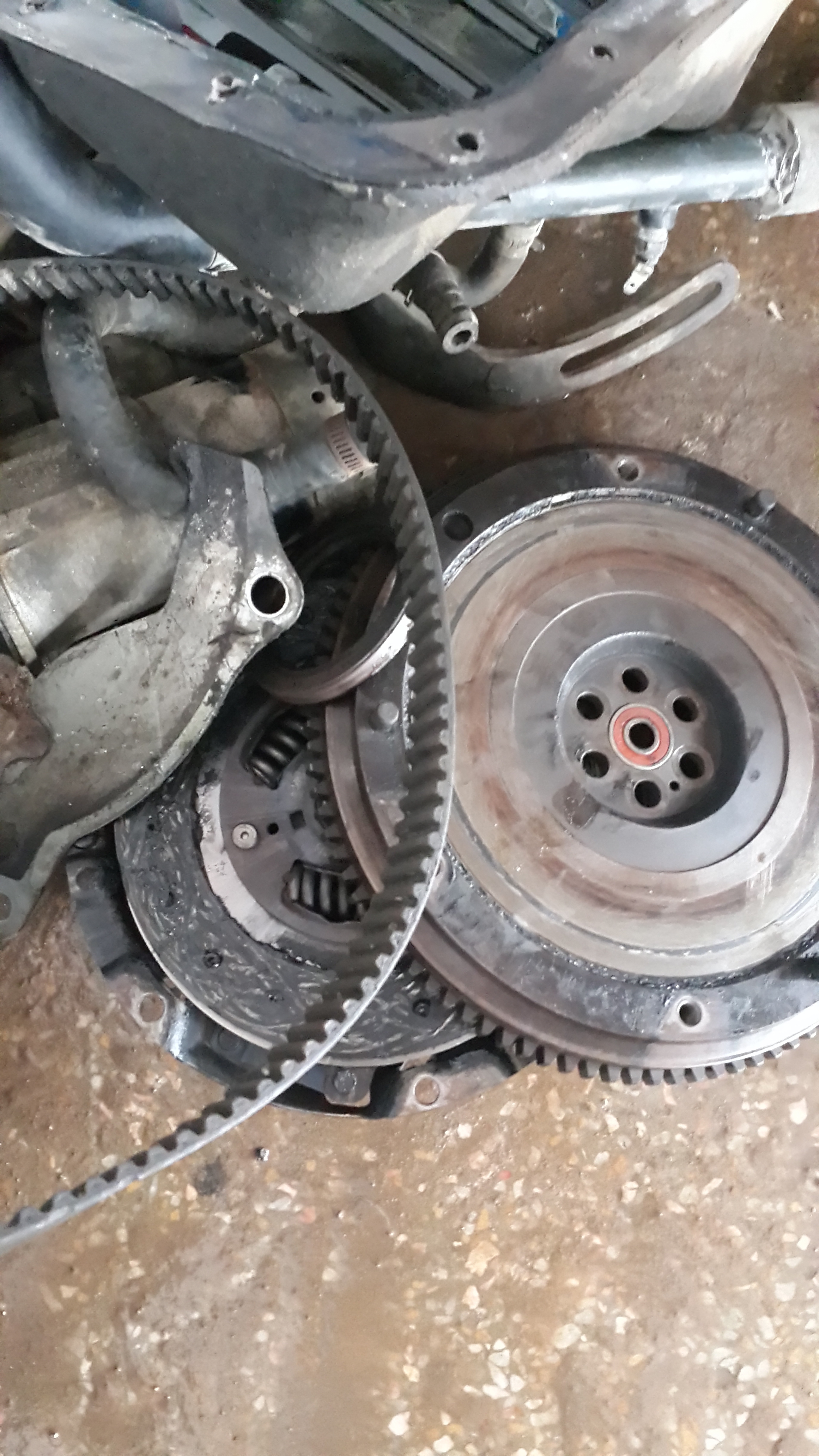

Total "kharcha" clutch plate set is worth 4800 rs, thats all i could make out
If you are looking for an overhaul, find a good mechanic. A professionsl mech is all that matters
Ask him to overhaul without opening the ac compressor bolts. It will save you the cost of ac gas etc. Ask him to accompany you for purchasing of parts.

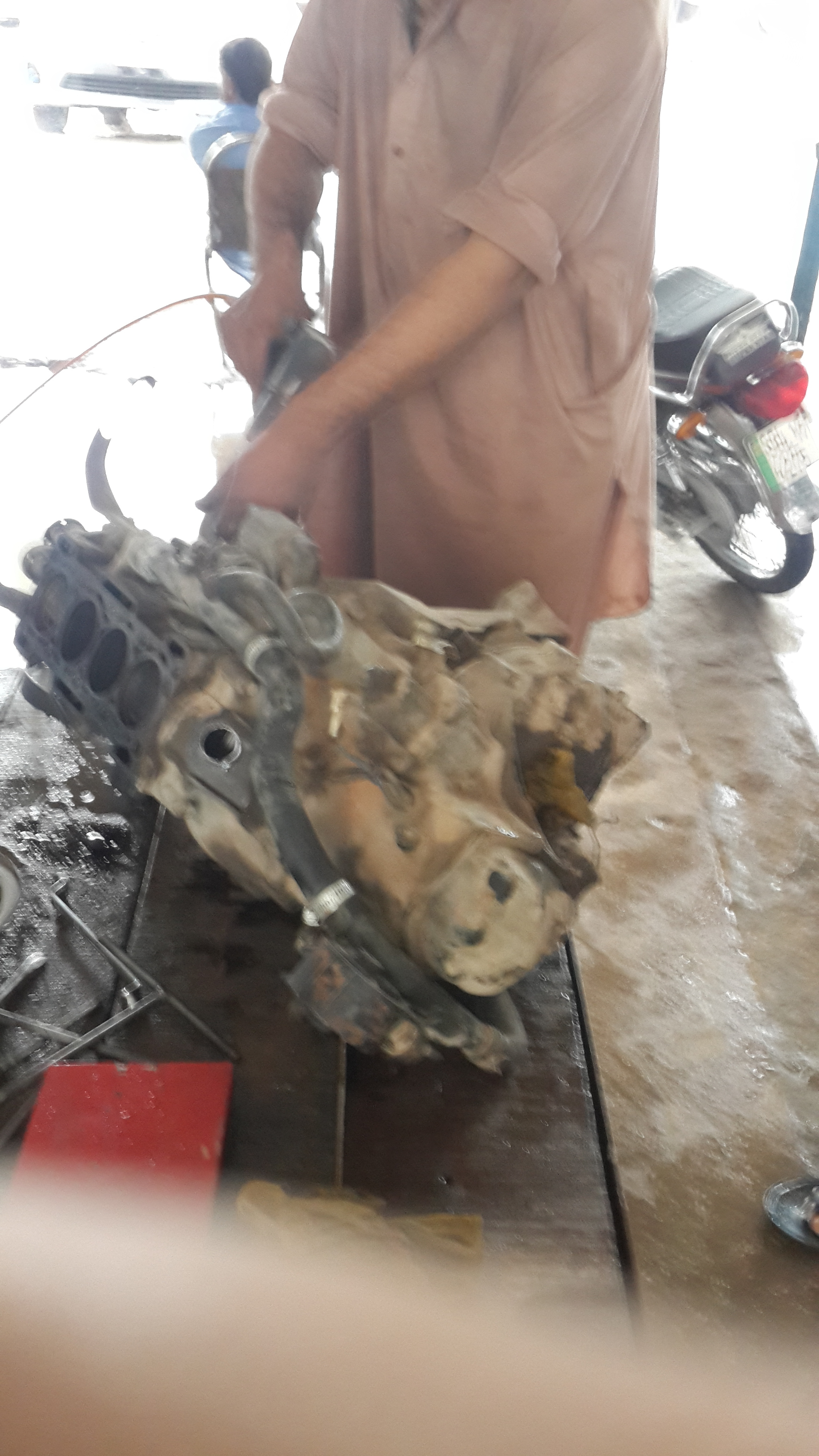

Total cost in my case was 32k. It can be till 18k if your engine bloc doesnt req bore. Mazdoori of mech was 6k. 17k worth of parts. 7k for kharadia. And 3k in misc. If you v any question feel free to ask.

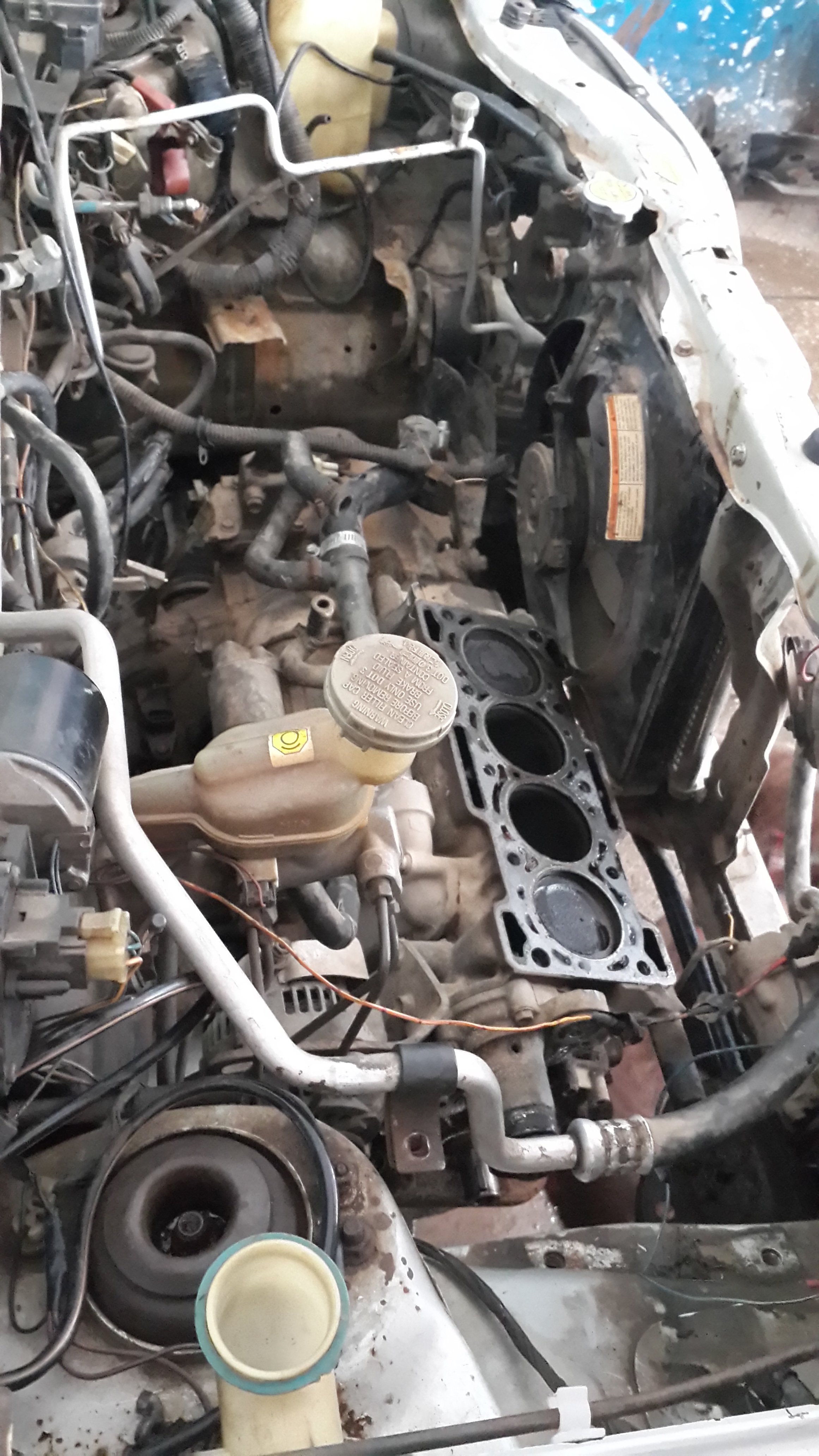

Why did it require an overhaul? What was mileage and which oil you used previously??
Car is around 200000 km driven. I used havoline 20W50.
Got the eng overhauled coz of Oil reduction (1 litre after spp 1600km) white smoke from exhaust. Moreover the engine was "burning" engine oil to pitch black colour.
