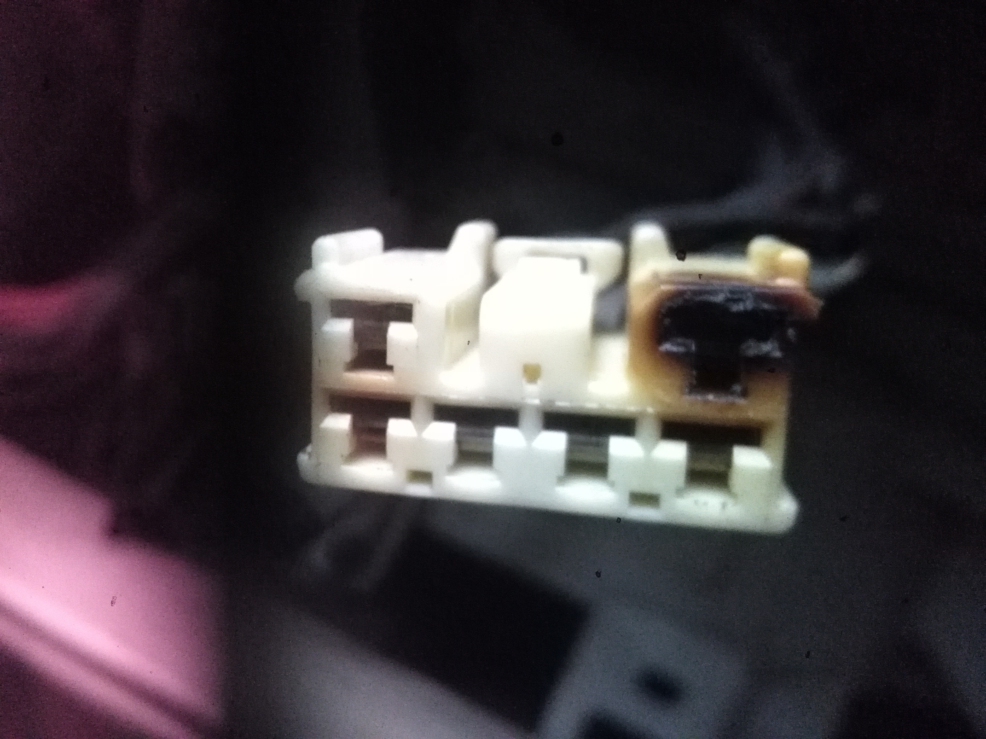

I have Nissan AD 2006 model (QG13DE Engine). I have developed a strange issue for some days.
The car used to start on half self and run smooth for about 15-20 minutes and it would stop all of a sudden. Then it would take very long self to start and would not race at all like it had died. I got it checked with my mechanic who concluded that the in-tank fuel pump was faulty as it was getting hot. He got the fuel pump replaced with a "Kaabli" fuel pump.
I notice slight improvement in the pickup of car, however, the problem still remains. The only difference from earlier is that the car dies a bit less i,e, although it dies but has a little better life then earlier.
But the problem remains.
What could be the possible issues, please?
