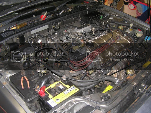

To understand it, open the bonnet, and inspect the gearbox, it seems that it not held by any mount at all, The entire engine and transmission assembly is supported by 2 big load bearing mounts on the bottom subframe members and one timing side mount, there are two torque mounts that stop rotation (pendulum) action of the engine - one is the big dogbone on top going to firewall and one is a small rectangle mount under the transmission bellhousing.
