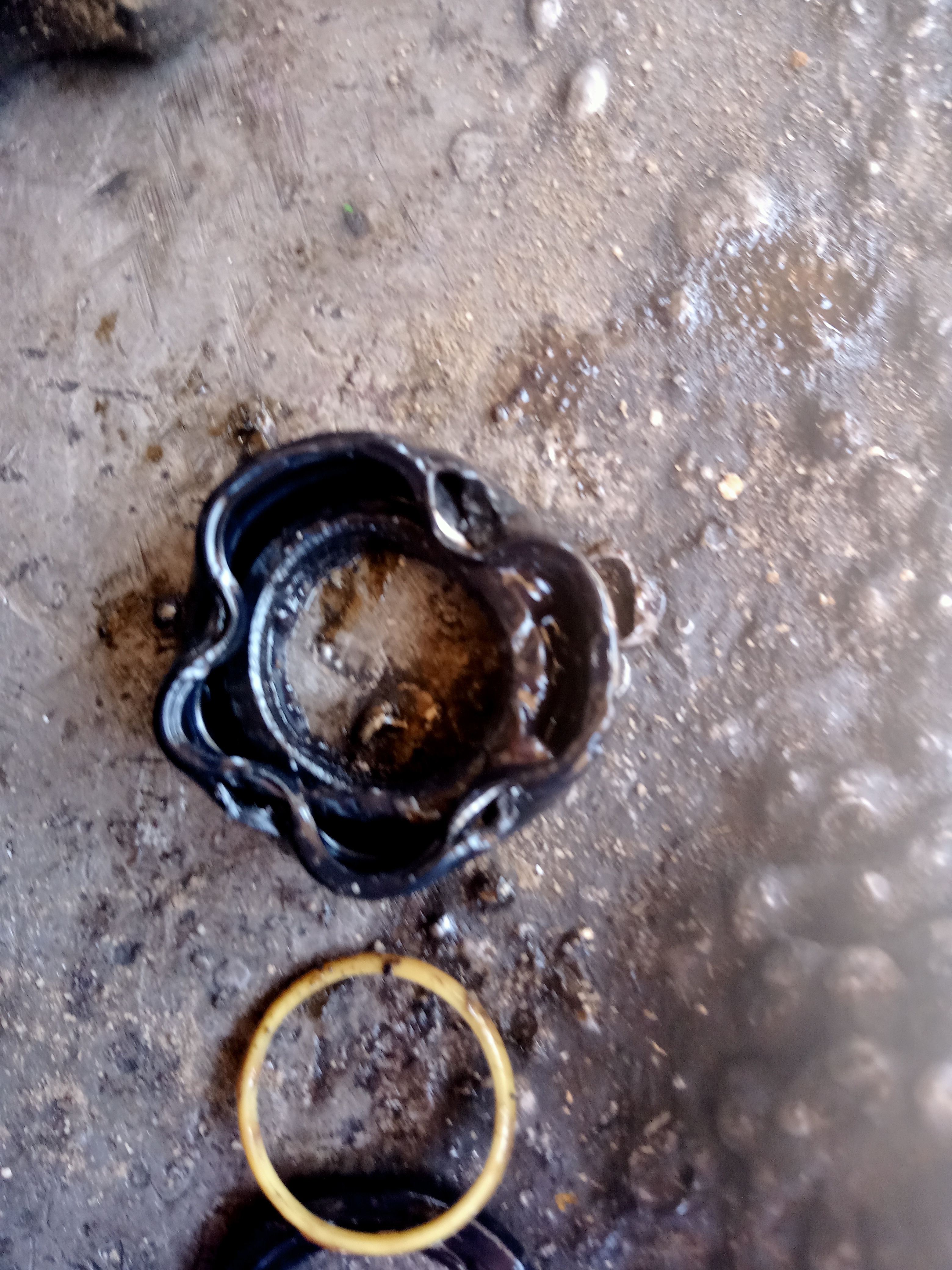

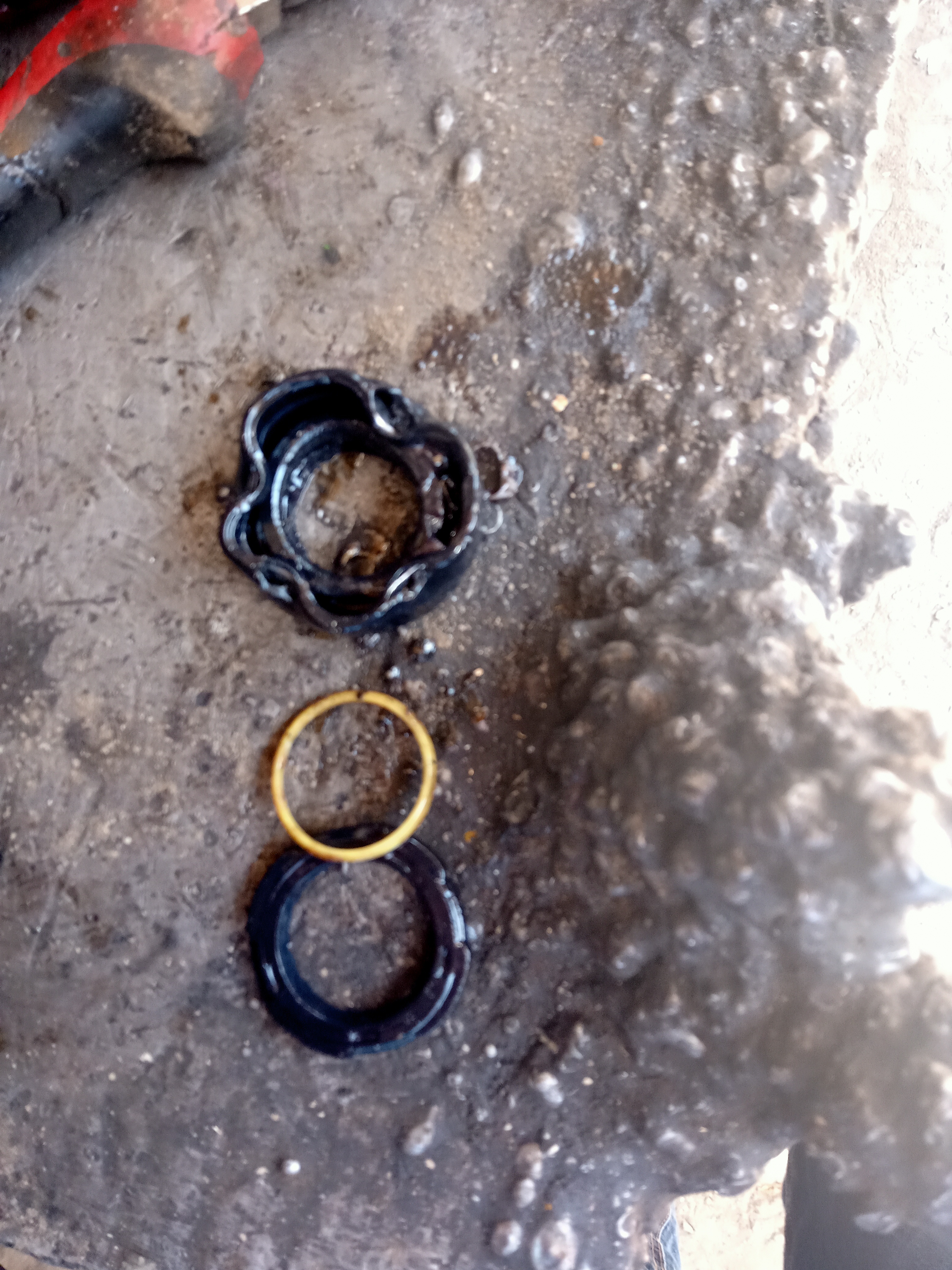

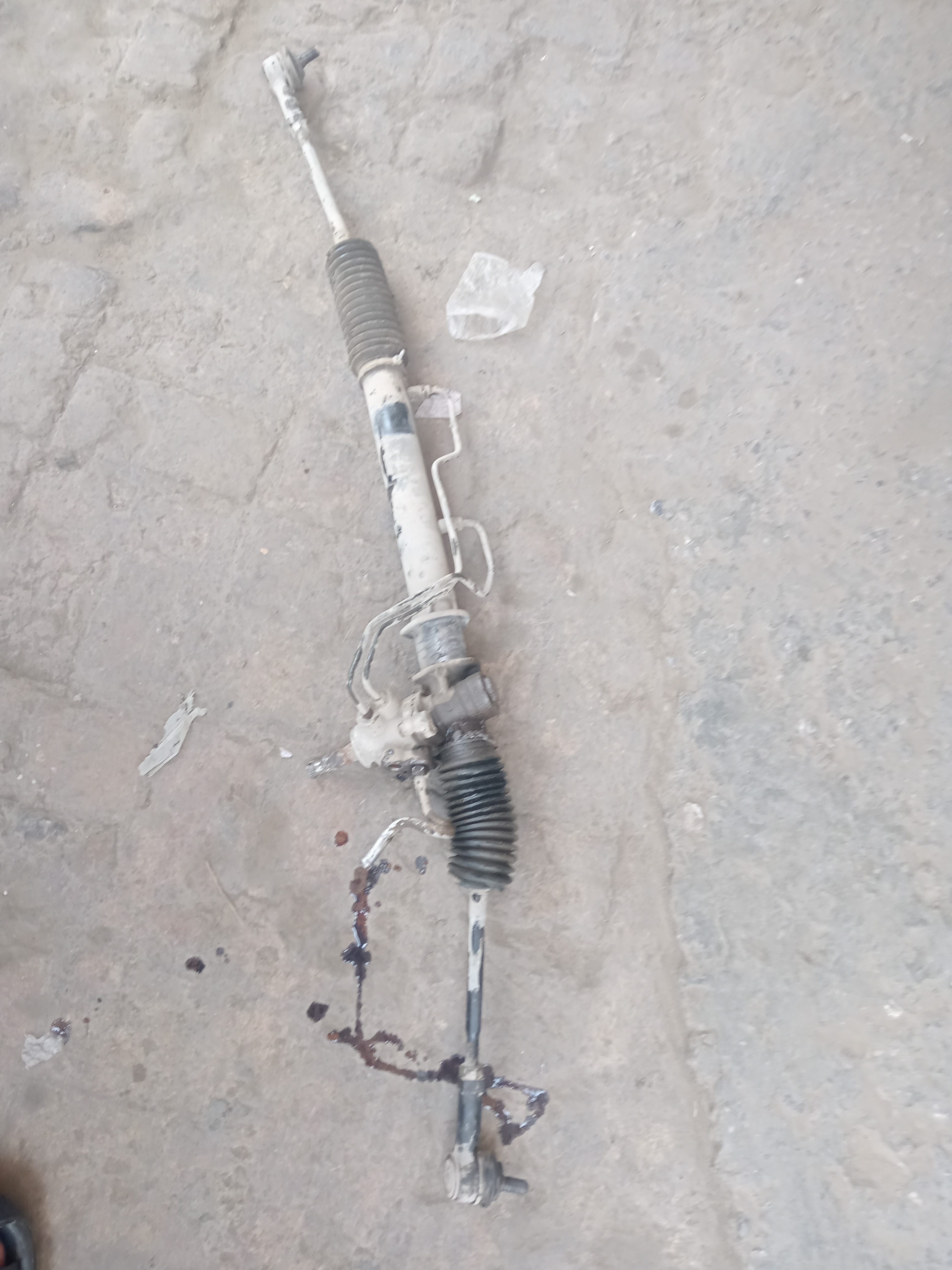

What is causing your car to fail its oil seals? Is the mechanic tearing up the center seal by dragging the rack teeth on it? Or is he messing up the teflon rings on the valve body?
