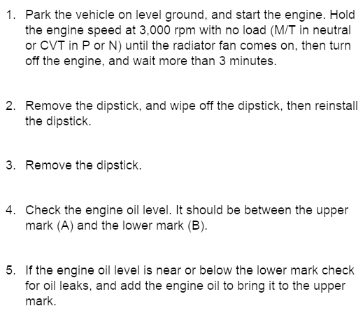

@helper_learner @pwuser15609321293 Both of you are correct. The correct answer is you should follow manufacturer's recommendations to check engine oil level. Sometimes the instructions are given in a service manual.
Some manufacturers recommend to check oil level on cold engine and others recommend to check when engine is hot.When the instructions say to check oil level for a hot engine, you should usually wait a couple of minutes after the engine is turned off.
The majority of the folks believe the oil level should be checked when the engine is cold. So to give you an idea this isn't always true, here are the instructions given in almost all Honda service manuals.

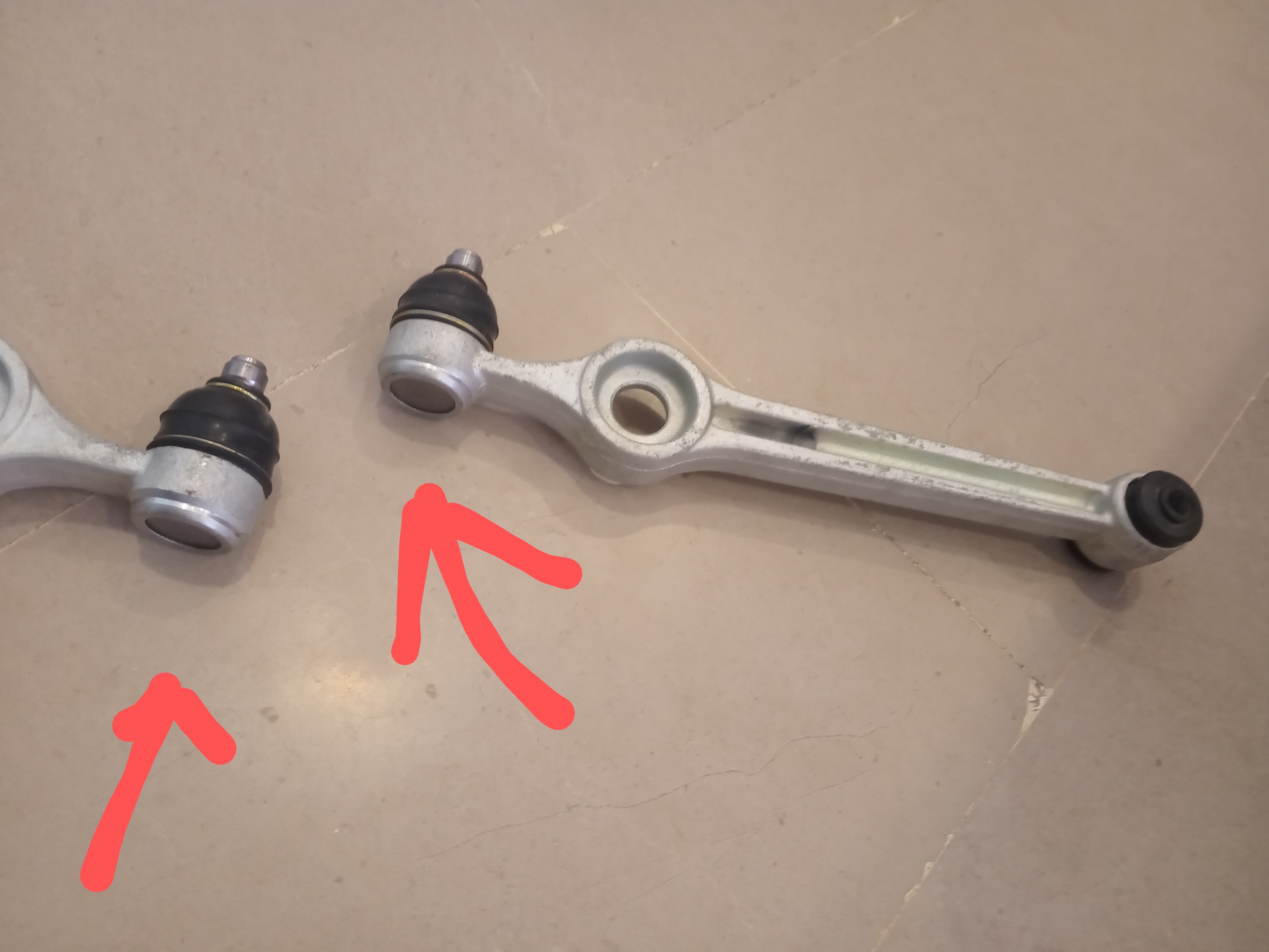

I need to drill grease zerks into control arm ball joints. I want to know if you guys can drill the zerks and pump the proper grease into the joints if I bring them to any of your shops. Thank you.

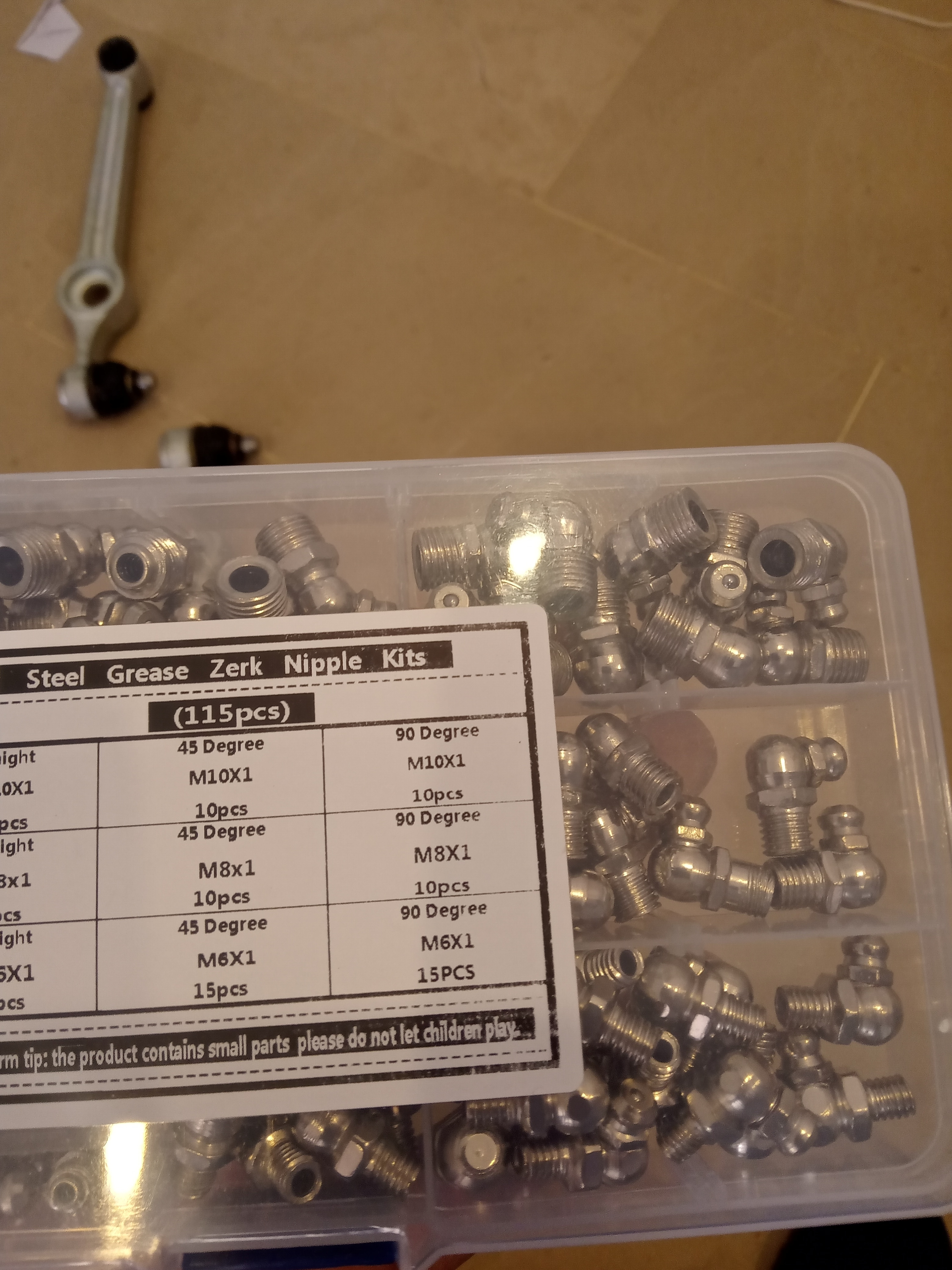

Suzuki Khyber. Here are the pictures of the grease nipples and the control arms:
Need to drill the nipples where the red arrows are pointing:
Back side of khyber ball joint has insufficient space for the zerks. So probably sides of ball joint can be drilled.
Nai panchayat. Nothing is ever simple with this car
I think I'll find some discarded control arms and experiment with them first.
