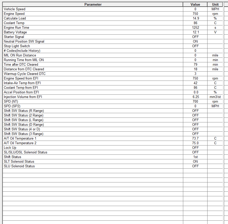

Salam @Xulfiqar bhai. I have been facing low Idle problem in my car (Honda City 2002 Automatic), engine is swapped to D16.
The idle is around 900-1000 RPM, but as soon as I shift to D/R from P/N car drops around 150-200 RPM and starts idling at 700-750 RPMs, turn the AC on further 100 RPMs are lost and it idles then at 600ish RPMs.
AC is properly wired through ECU, have verified using OBD scanner that it detects AC going on & off. Also verified it increases IACV values wrt to load, it jumps from 20-22% to 40-42% when you switch on AC. But still the RPM drops.
Can you or someone else here please guide me what's the issue here?
