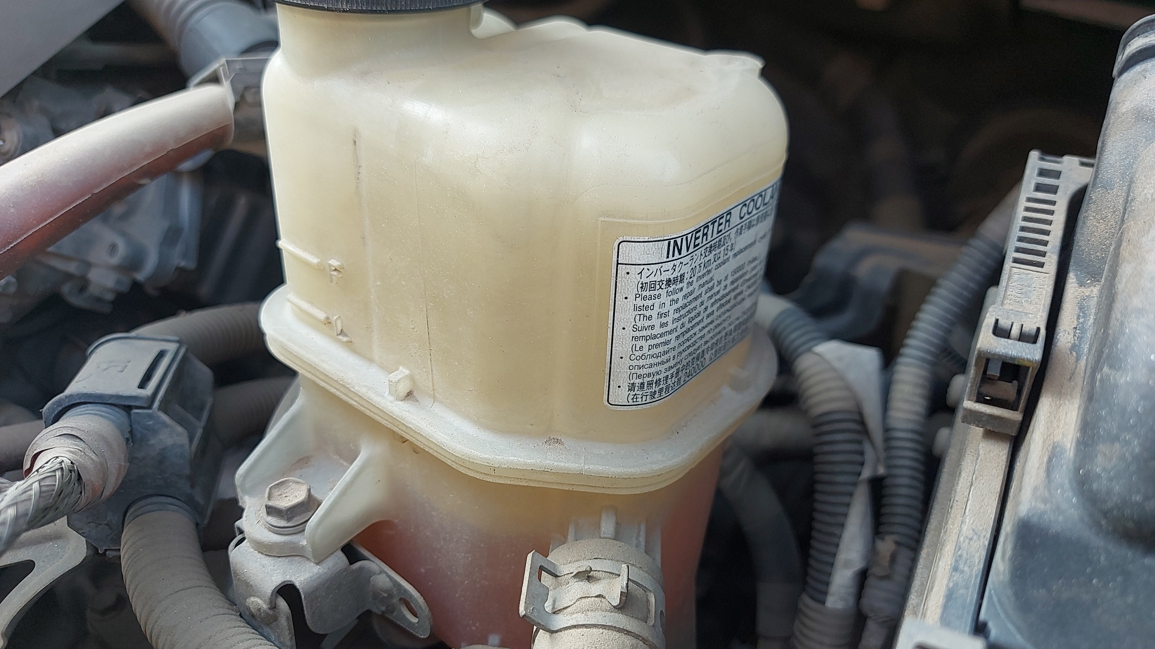

These charsi USTAADS are why i dont even bring my CD70 near them... Once drove my prius in an extremely humid and hot weather (48C!) and the ac slowly stopped giving off cool air. Went warm. Felt like an oven! Went to the same CARTOON ustaad, he ran a OBD scan, and the ECU gave a inverter pump malfunction code... "SARR gudddi naawaa PUMP chahiye, set ho jaye gi GUDDI."
Family member insisted on installing a junkyard pump for 10k, the original being 60k. Went home, opened the bonnet...
"SAKHT GANJA WALAY USTAAD", I thought, while cursing myself for not checking the coolant earlier. The pump just couldn't get enough coolant through. Jackasses.
