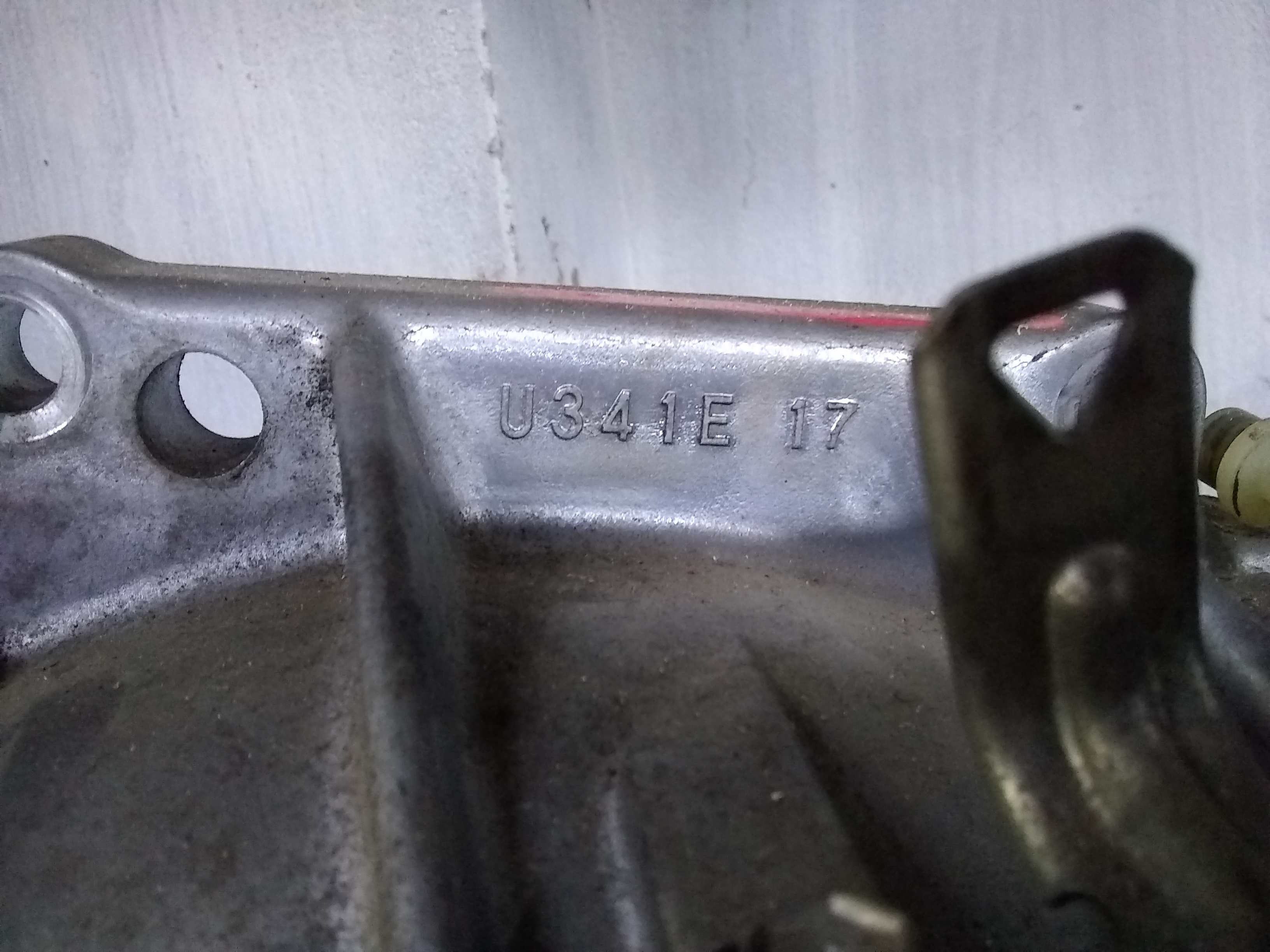

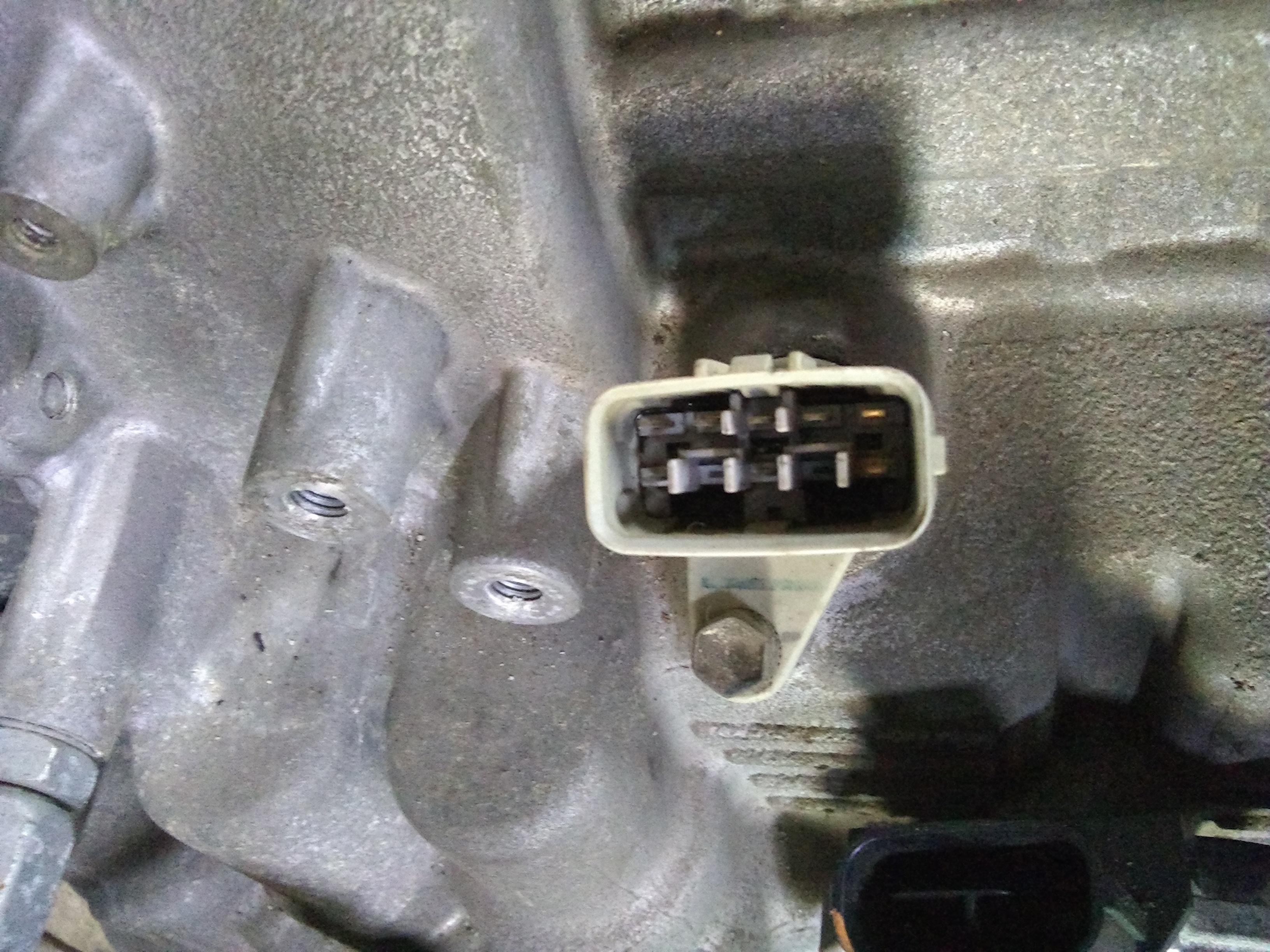

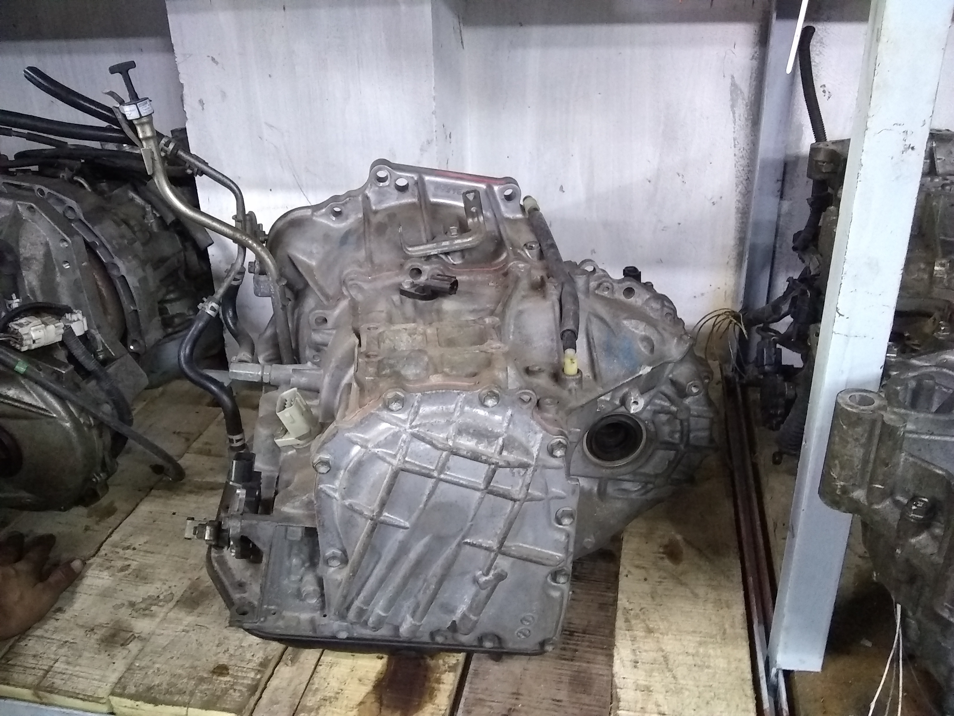

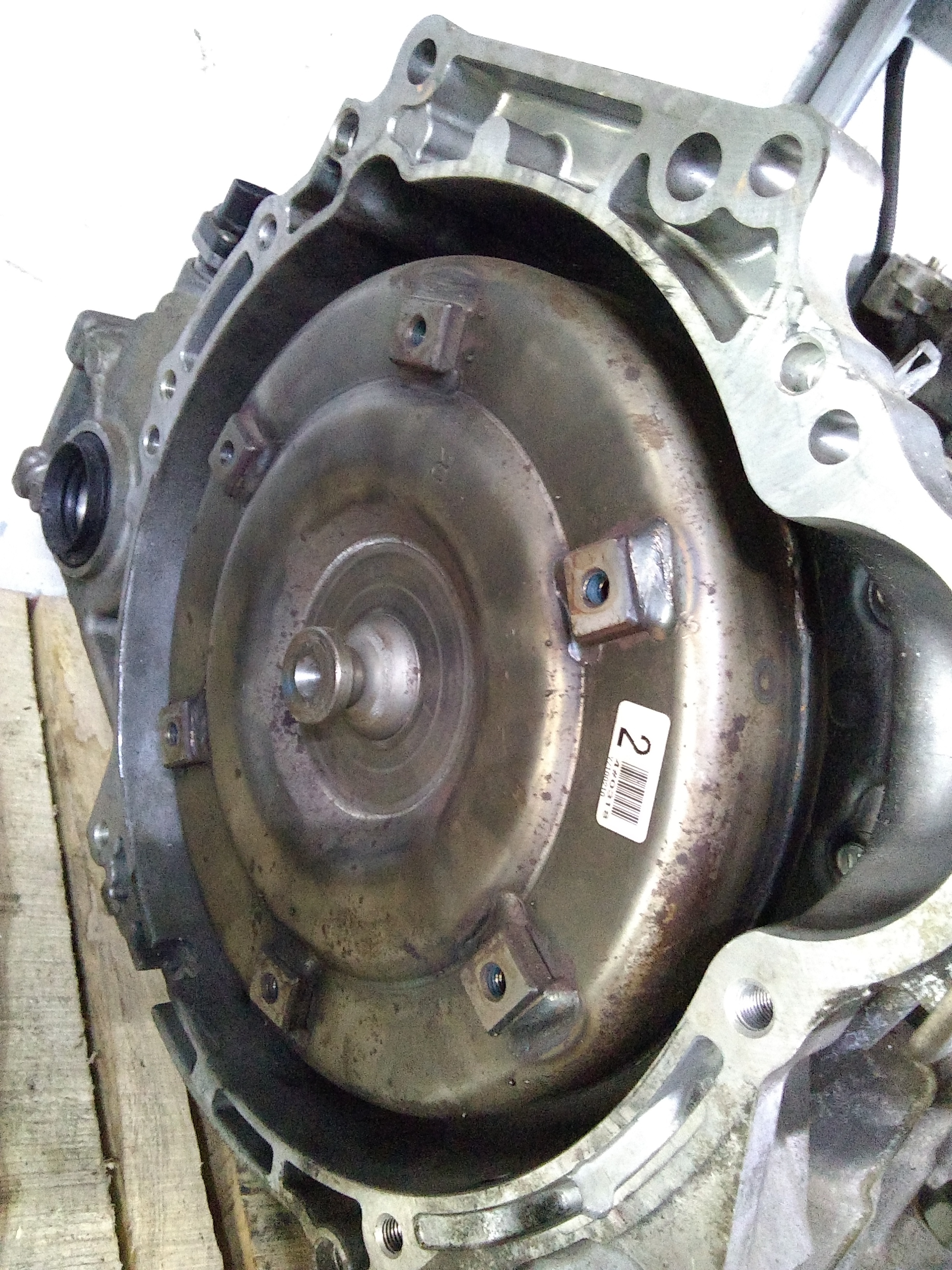

looks nice, but dont know if its any good, does the shop install it too?
