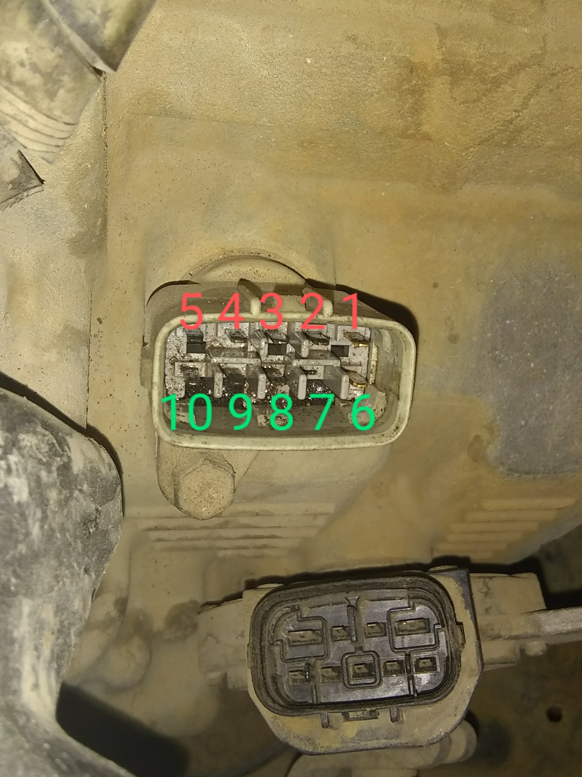

Not at all . At first he said TCC doesnt exist in real world it just a scam then he took a ride and tried to convince me that all gears are smooth and there no issue and there is no such thing like TCC then I asked him what does P0773 means then??? so he check connector and said its gear is changed there pins dont match etc and I will ground the 9th pin so your fault will be resolved
On id plate its U341E but I want to match it with transaxle so where its punched on transaxle

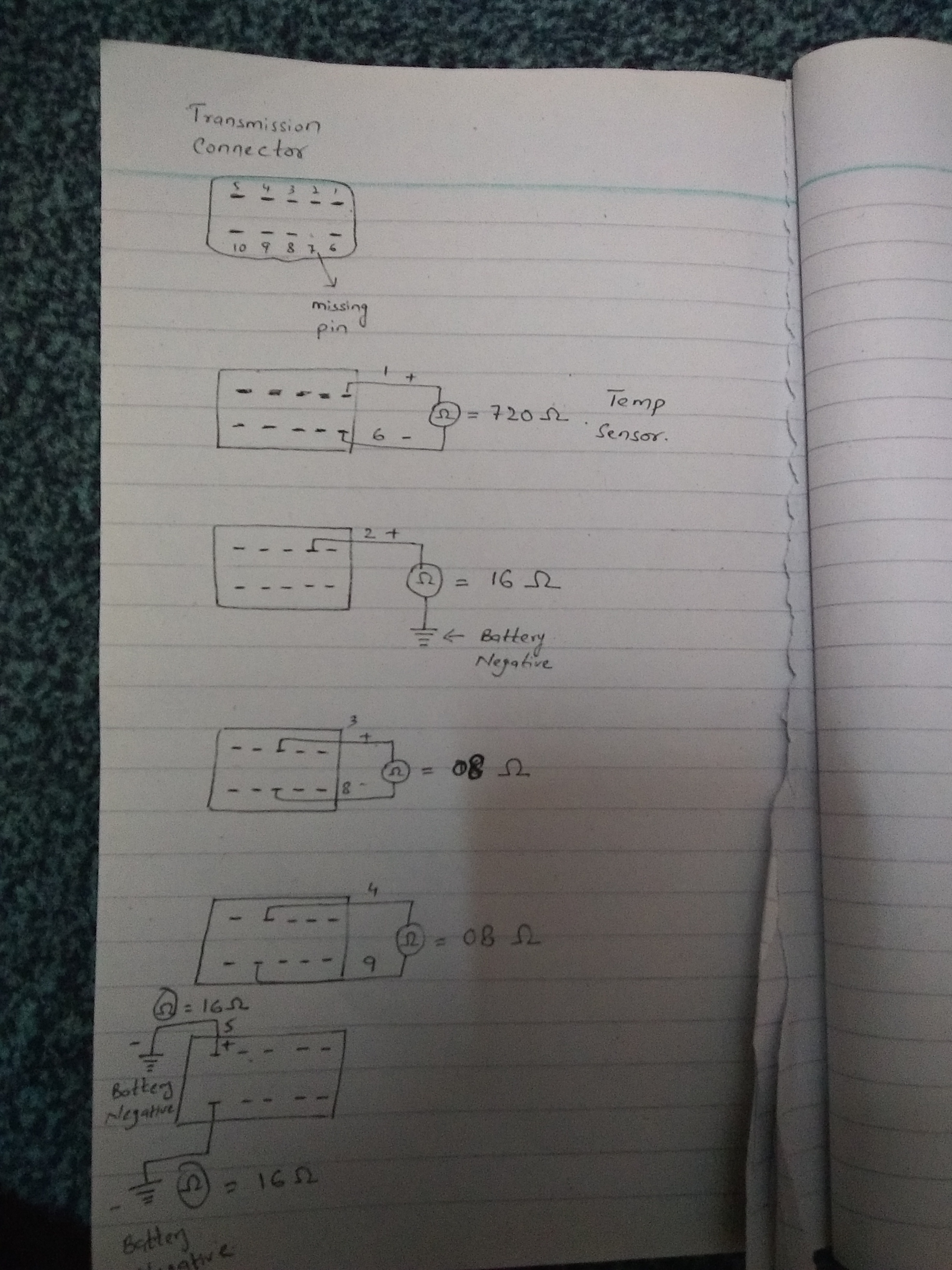

Why dont you use the celica manual you got. And use a pen n paper to make your own diagram.
Then test as required. Its not rocket science, its a simple as dirt toyota u341e
Today I used Celica Manual and checked ohmic values
Almost all values matched but TCC valve (pin#4) showing open when checked against battery negative but showed 8 ohms when checked against pin#9
According to Celica manual pin#9 has no connection and pin#4 is Solenoid SL (TCC solenoid) but in my case when I touched pin#9 and pin#4 with DMM it showed 8ohms
Also connector from ECU has no wire for (Pin#9)
Maybe gearbox is changed
Yes mechanic is also saying that. Now what to do???
