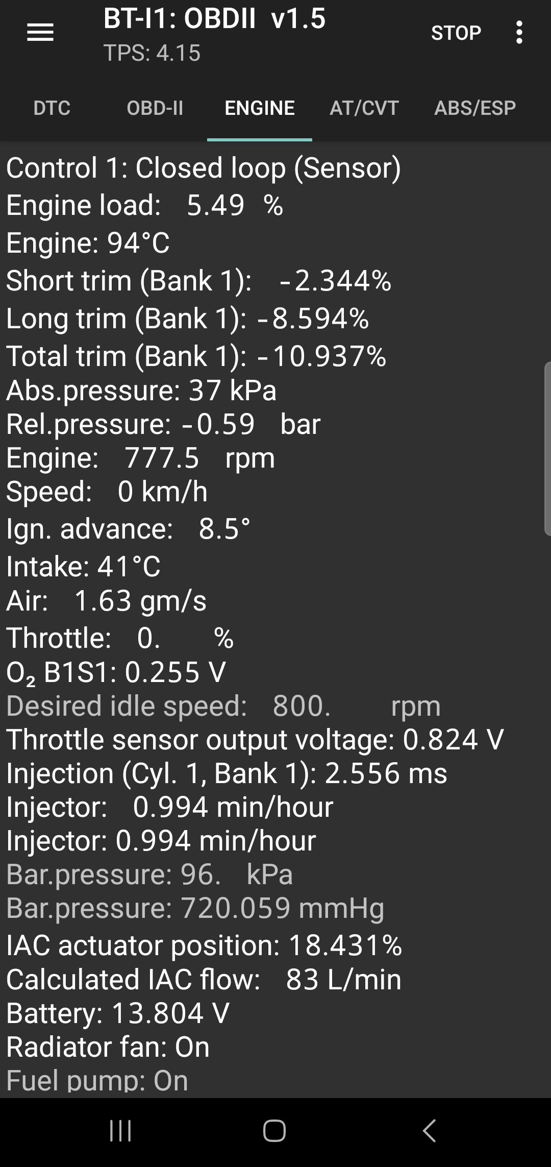

- under the hood that mo%$@#ka cabin heater hose at head side tube was leaking coolant like baby pamper oozing green diarrhea visible trace was there.
connected cables and the jimny started, no temp rise guy shook hands and his family was thank ful, i said thank you for stopping me it has solved my problem too.
