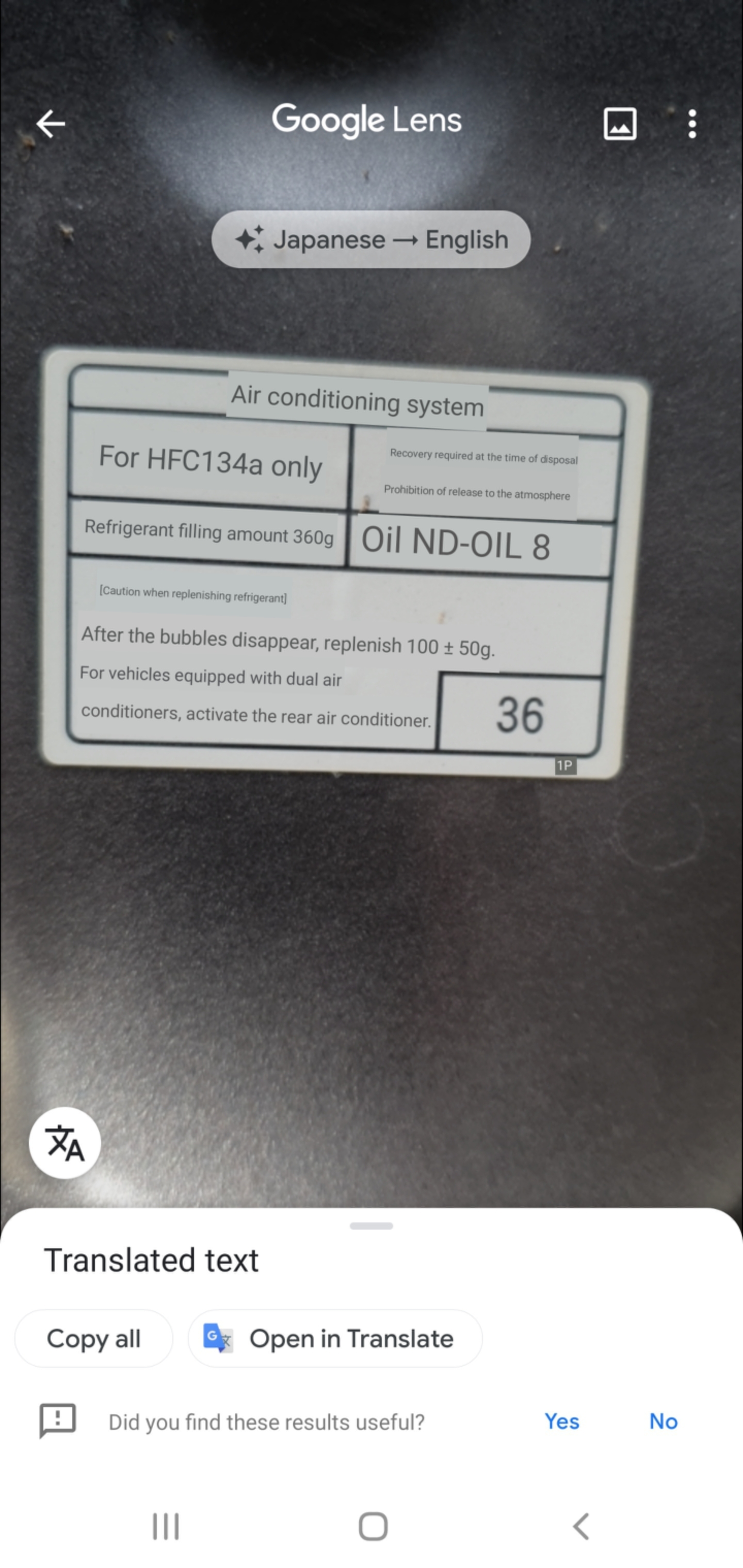

I have repaired a lot of such âyoutube videoâ cars here, mostly its the owner being diy youtube genius and charging it with âgessâ because they think the âgessâ expires or something.
A recovery, purge, vacuum and recharge restores 100% performance. Speaking of mechanics in UAE and KSA, they are at equal ranks of paan/menpoori/gutka ustaad of Pakistan. Seen it there myself!
This issue not unique to this corolla either, a lot of new cars have this compressor, some even have clutch with this pwm solenoid (Ford), the first iteration of this compressor were in early 2000s, so its not new tech either)
The oil type and quantity is also a critical point in this compressor working, too heavy of an oil will cause stalling.
If the cabin temperature is too high the compressor will âdisable itselfâ as the liquid pressure gets out of control when first started, however if you vent the cabin before getting in and starting the ac it will always work 100%
Or you can wait for the cabin to cool itself down then restart the ac and it will kick on.
